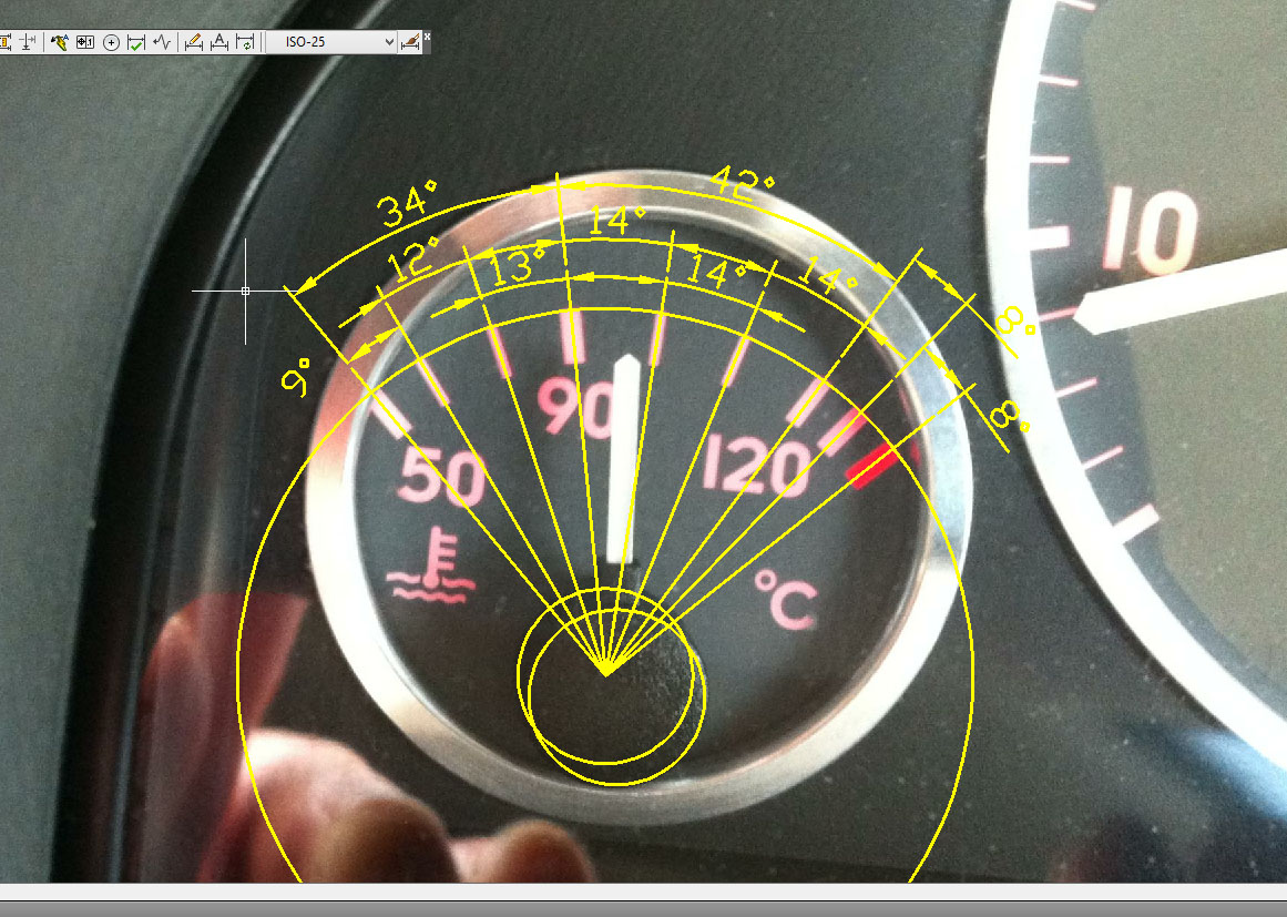

Surely not! If you assume the 120 mark is the one before the red one (although it's not that clear) then the marks are as follows:
50 (marked on the dial)
63.33
76.66
90 (marked on the dial)
97.5
105
112.5
120 (marked on dial)
Given that the marks aren't equidistant, why would they choose such daft values to mark up? And why make the interval before 90 at 13.33 and afterwards 7.5?
Unless maybe it's simply 90, 100, 110, with 120 being the first of the last 3 thicker marks.
Not sure about the markings after 50 in that case though ... perhaps it goes 50, 60, 80, 90?
Old 19th August 2015, 05:14 PM
Location: Norwich & L'viv
Posts: 1,679
Having just quickly measured the angle between each marker, that 50c marking doesn't seem correct. 60 would fit better.
My guess is:
70
80
100
110
120 (marked on the dial)
125
130

Old 19th August 2015, 05:22 PM
On PF last 3 marks and number 120 is red as well
Old 19th August 2015, 05:33 PM
The gauges are not linear, there are believe it or not maps for the gauges so the info fed to them gets displayed at the correct mark.
Only way to know for sure is stick VCDS on her and log it on your travels into work.

Old 21st August 2015, 09:05 AM
I understand that they're not linear, but what I don't understand is why they mark the gauge up at intervals that are open to interpretation.
If this were my job, I'd either put 3 marks between 50 and 90 (60,70,80) or one (70). And between 90 and 120, just 2 (100 and 110, as it might be, depending on which mark is supposed to 120).
And I'd have made the last 2 marks (if they are, indeed, something over 120) a wider red bar.
What's so hard about that? Then the intervals would be obvious. What's the point of a gauge if you can't understand it? It might as well have 3 divisions marked in green, amber and red!
In the meantime, the car seems to be staying below 100C (or the mark after 90) and Scotland's summer (last Sunday to Tuesday lunchtime) appears to be over, so I'll be looking for a sensible-priced new radiator (any recommendations welcome).
