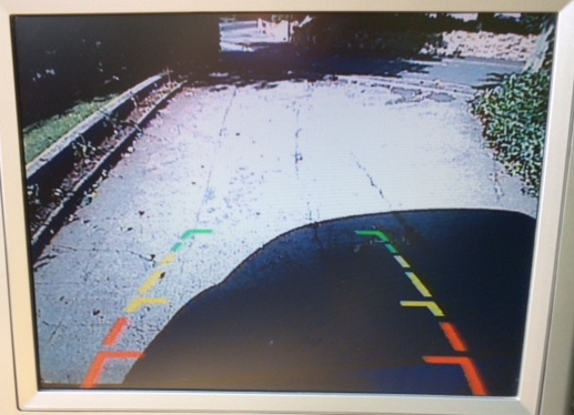

Work keeps getting in the way, but having fixed the broken numberplate light this morning I did a test fit of the camera in its exact proposed position.
Horizontal angle looks good flat on the metal, but ideally could be a degree or two higher (as adjusted in the picture below using a sliver of blu-tack).
There is no sealing material supplied so I plan to have a thin layer of silicone sealant to cover the cable hole and sit behind the camera sealing its cable exits too. That will allow the very small amount of vertical and horizontal adjustment needed to get a perfect alignment. There are also a pair of fixing screws which go through slots not holes so there's plenty of "slack" for last minute tweaking.
Hope to start cutting metal tomorrow; don't want to start today as I need to use the car later. Still pondering the emergency boot release option(s).
Also need to replace the boot opening seal while I'm at it; it's damaged at the sill. That will probably happen once I've worked out the video cable route.
