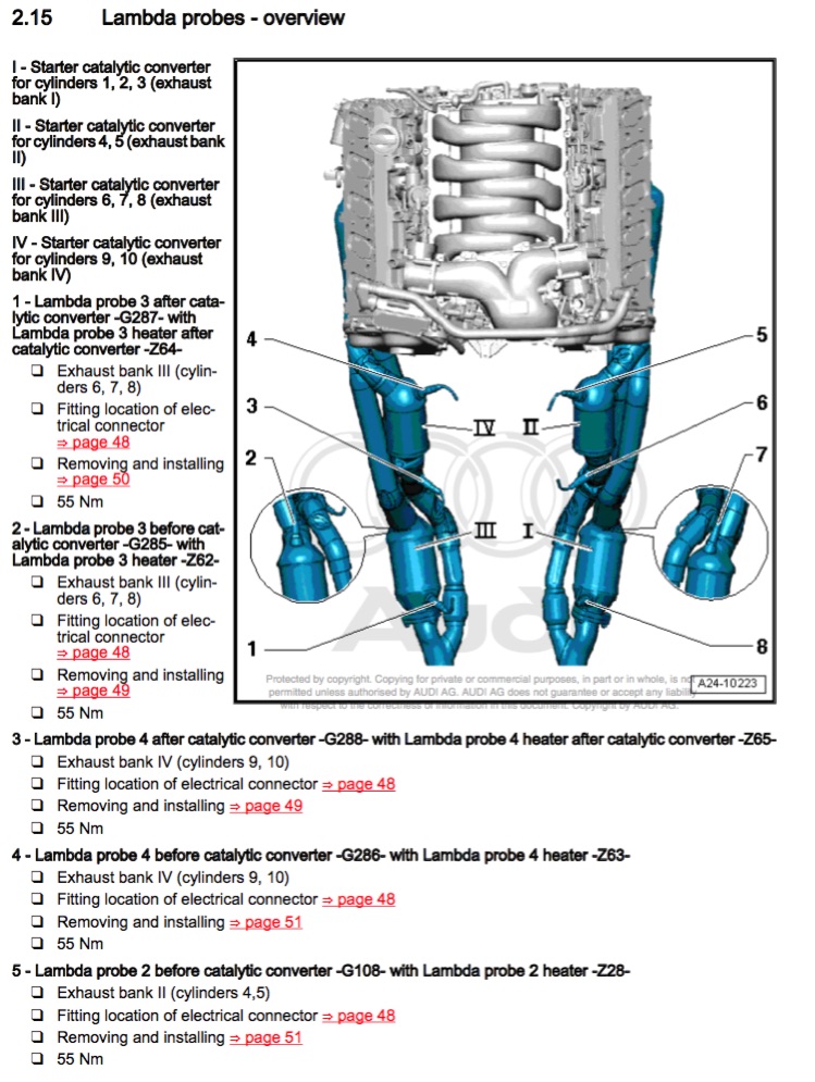

How many lamdas does it have , how are the exhaust branches organised ...all 5 cyls on one branch per bank ??

Bank 1 = cyl 1 2 3 Driver side or right side according to manuals seen from inside the car
Bank 2 = cyl 4 5 Driver side
Bank 3 = cyl 6 7 8 Passenger side Left side according to manual
Bank 4 = cyl 9 10 Passenger side
Lambda's 4 pre 4 post cat
I changed the MAF's over because 1 it was easy and two the misfires are on one side of the engine, it made no difference.
I then went for a 15 min drive with different load conditions, the misfires are always on idle or part throttle, when i boot it there is no misfires unless for some reason the ecu stops looking for misfires at WOT, I chopped the video down to 2mins to save our sanity and show what rev ranges the misses are happening.

Good diagrams there 👍
Yes in many cases cylinder contribution / missfire counter is disabled over certain revs so let's not dwell ( dwell haha joke in there somewhere)to much on that for now
How do the variable manifold runners work , is it a common shaft / operating linkage through the manifold for each bank .?
Should we see if defaulting a richer map for 6 7 8 does anything for it , so un plug the before cat lamda for those cylinders , now in some cases un plugging one lamda plug will just put the whole lamda control in default setting ....I'm not sure ....but all we want to know is adding fuel helping with the missfire count

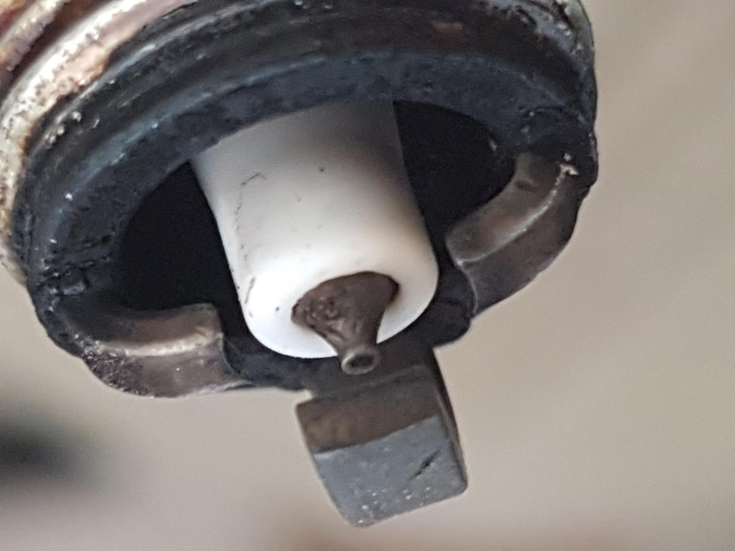

Replaced spark plug and swapped coil in from number 8 cyl
Misfire still there on 6 mostly.
Disconnected the MAF to see if the car would run richer by not having it and it did but the misfire is still there
Also did some test with the o2 sensor of bank 3 by pulling the dipstick to induce an air leak and see if the pre cat o2 sensor responds which it did.
This is the plug removed from cyl 6

It was a great pleasure to work on Del's German Missile
Not as good as the Honey Whisky and Gin each evening after achieving magnificent results each day, but still a pleasure.
Misfire problem it is a completely different matter and a right b1tch and we all almost lost all the hair from head scratching. Hopefully the problem isn't the North Korean Missile Technician
Is there a crack on the spark plug in the picture???

Old 1st November 2016, 07:39 AM
It's does look like a crack but from tge naked eye and different angles I don't think so.
Even with the plug swapped it's still misfiring.
