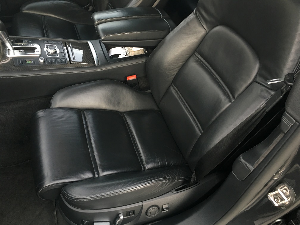

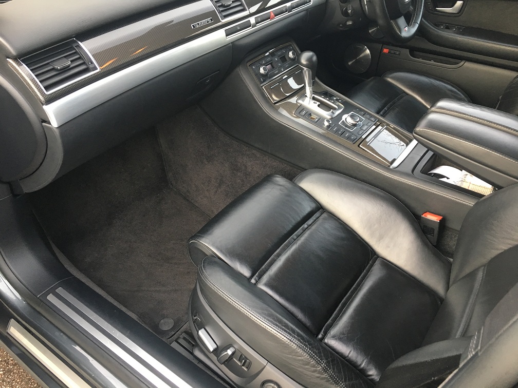

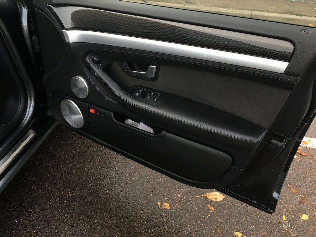

So I thought I will share some interior photos to show the minimum wear in my opinion on a 10 year old car with fair miles.
Carbon trim has been well looked after with no fine scratches, leather on the doors and centre console has no wear either..but I put two coats of balm anyway and everywhere
Door cards are great apart a small wear from shoes (getting out) at the bottom on the driver side and few scratches on the metal speaker's mesh which drives my OCD mad a little so that will end up being changed again at some point for sure.

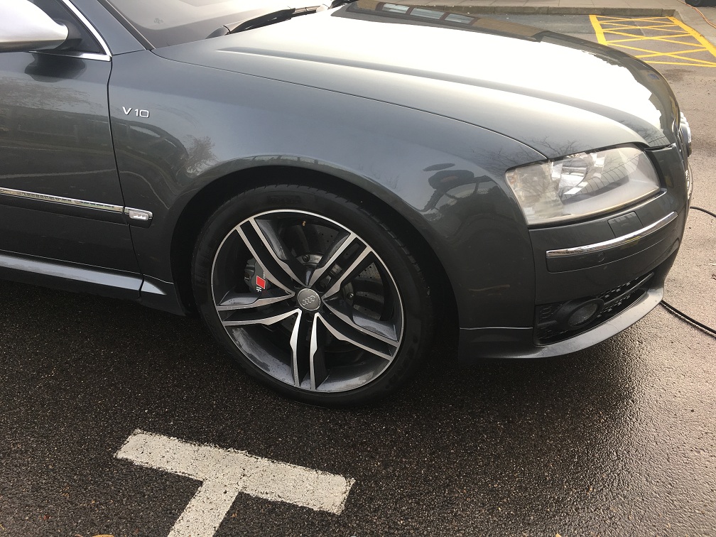

Here she is waiting with her sibling in the queue for a ritual Saturday wash
and all back and shiny again

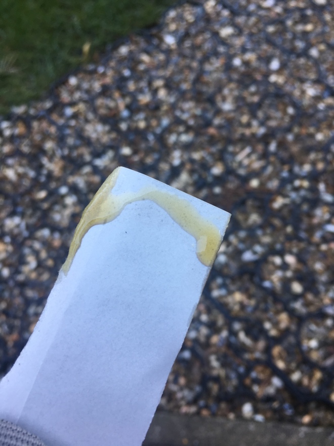

Here are the pics.
It's the hose behind which leaks the most and fluid runs down the hose where it drips onto the the engine under tray.
Fluid colour is nice and clear so I will be only topping it up.
