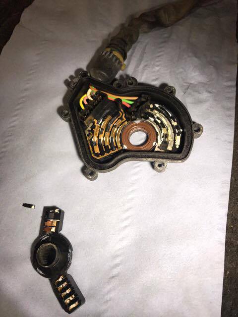

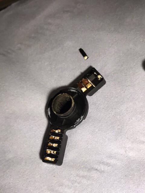

unbelievably the F125 switch on my gearbox has had to be replaced due to one of the internal components corroding and breaking off
Amusingly there's a "name that part" thread on another Audi forum and I posted a picture of a new F125. A regular (RS6 driver I think) responded:
Ugh. I never want to see one of those again. Bloody F125.

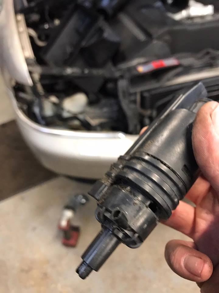

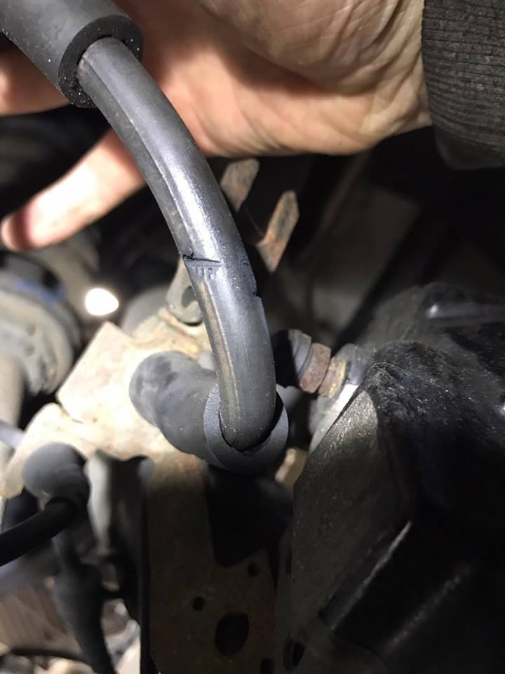

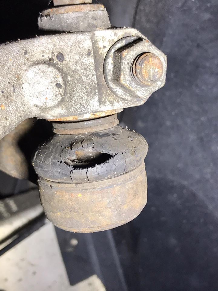

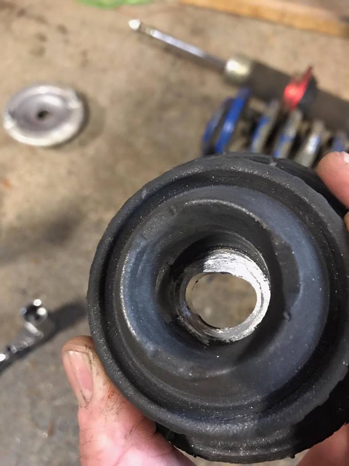

So do I - I wont tell you how much the total bill was but work done:
New F125 Switch purchased and fitted (Old one broken internally)
New suspension turret top rubber mounts replaced
New Washer Motor and 1 washer jet to sort washers
New brake line as chafing from unconnected line has damaged it
Brake wiring and lines all fully secured properly and wiring sorted to get rid of warning light
New Track rod ends either side as one had rubber damaged
New MOT Certificate
Car now starts properly and drives perfectly again!
Thanks to MkOneMan again for all his hard work
