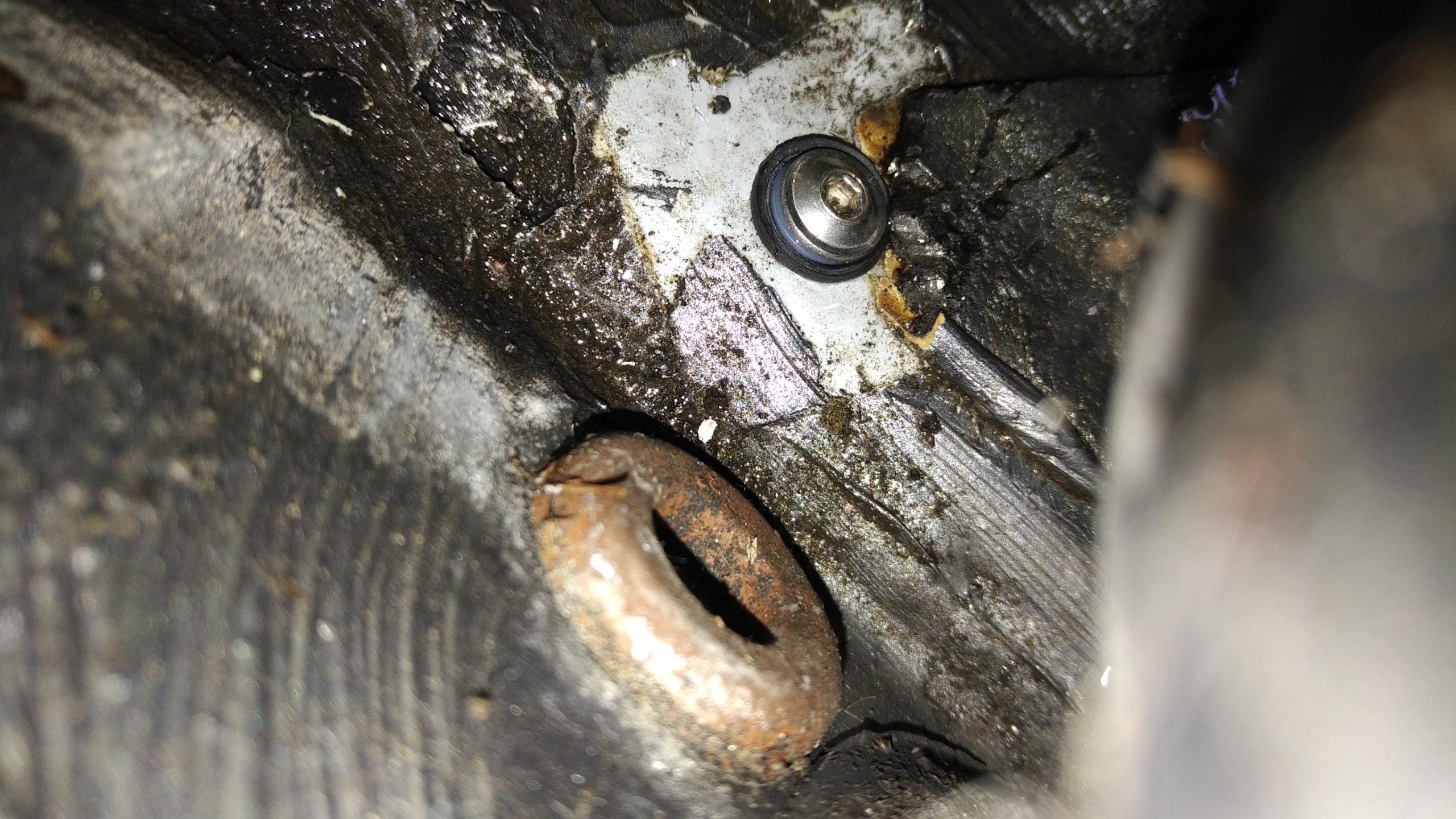

I finally managed to get around to doing this. It was getting worse over the last few months and the wood cover over the relays is looking and feeling quite wet so may need to replace it if it doesn't dry out well enough.
Thanks to all the help from people on here I was able to locate the offending hole with only a little difficulty! I used an M8 rubber well nut and it fitted just right, slightly larger might fit too.
I then used a long allen key and could reach through to tighten it without needing to remove anything.

Two questions:
1. How did you get that first picture?
2. How did you find the hole and feed the well nut in?
Old 19th February 2018, 08:03 AM
pete-p's Avatar
pete-p pete-p is offline
Posts: 668
Two questions:
That was fairly easy, I just slid my phone in on top of the ECU box, it took a couple of attempts to get it right. I just had to be careful not to push it in too far! So the first picture is looking down from above.
This wasn't too easy but using the photos in this thread http://forum.a8parts.co.uk/showthread.php?t=7645&page=2 I was able to work out the location from the two grommets and a seam in the body. A little light scraping with a long screwdriver soon found a hole. All I removed to gain access was the ECU box lid and undid the nut on the windscreen trim so I could lift it out of the way.
To get the well nut in was a little tricky as I didn't want to drop it but using some tissue paper to hold it onto the end of an allen key and some long nose pliers (I didn't have a long enough allen and had to buy longer ones to finish) I was able to drop it in place and used a long screwdriver to help push it in and off the allen key. It took patience and some care to work out the easiest way around the pipes without losing the nut. I also positioned my phone to shine the torch light so I could see better.
I didn't scrape a single knuckle either! Time will tell if it stops the water ingress or if the drains are also blocked, but it looked fairly clear of water in there.
