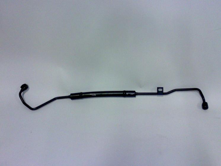

To clarify, I was referring to the original parts, so 4D2422893H and 4D2422893P. On Audi Tradition.
ID:	20740   Click image for larger version
Old 18th January 2019, 04:55 PM
Ah. The silver-wrapped one in your pics is the V6 hose.
Actually, the left one (H?) would fit on to the front half of the C5 pipe making something nigh-on plug and play in a D2.

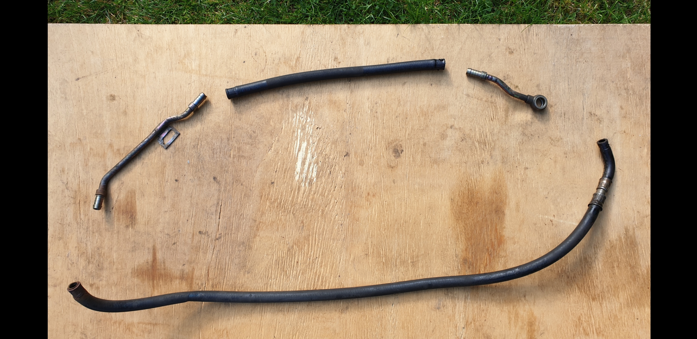

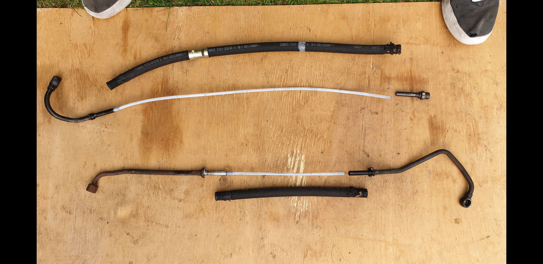

As you should be able to see from the pictures, I have dissected the pipes so we can all see more clearly what is going on. The pipe that leads to the oil cooler, with the rotatable end on it, seems to me to be fairly standard. The other one though is a different matter.

I am thinking of send the hoses off this week but would appreciate any comments incase I am missing something.
One question in my mind is why is that long metal union there in the first place? Would using a smaller elbow and then replacing the extra (now missing) length with rubber pipe cause any other problems?
I am planning to post out on Friday, any comments, opinions before then would be greatfully received.
Cheers Frank

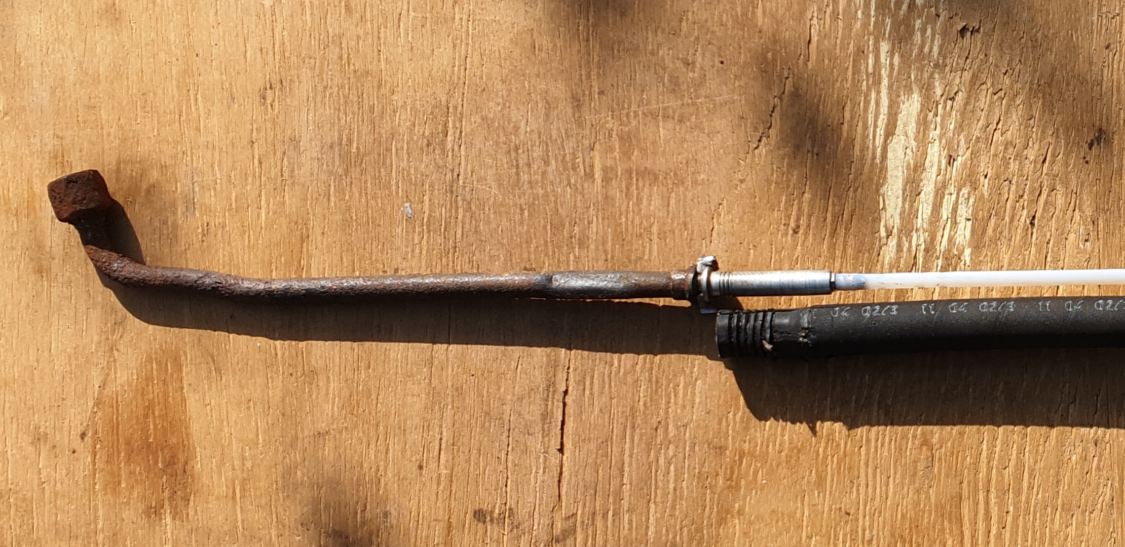

I have sent you a closer picture of the long corroded union as I think this is where we may have problems.*
The internal plastic pipe terminates to this union and I am not clear how we could achieve this to a standard 90deg bend?
The plastic pipe cannot be left out as other owners have tried this and it causes the pump to cavitate.*

We do keep nylon tube which I could fit to be longer when I make the new hose. From the pictures am I right in thinking that the longer hose has the perforations in the inner nylon tube but the shorter rusty end one is not perforated?
The other option could be to make a long elbow fitting but this would be in plain mild steel which you would have to get painted before fitting it to the car. It would be a separate detachable part so you could paint it after we make it. From the photo I am guessing the internal thread is M16 x1.5 or M18 x1.5

I have a crusty set which I'd be happy to send them to try out if they would rather dismantle and investigate for themselves. I kept them for exactly this purpose since they would need to know the angles at which the various unions are attached to the pipe so they could replicate them. If the angles are wrong it'll either be impossible to assemble or the hose will be under strain and will quickly fail so that is important to get right.
I think the union in the wheel arch is there simply as a manufacturing / assembly aid. They could simply join it in the arch rather than fiddling around feeding the thick hose through the chassis leg structure.
I thought the plastic liner actually terminated at that union. I don't recall it being there in the rack end piece on mine, but clearly yours has got it in the second part as well.
I don't see any reason to still have the union in the arch if they can replicate the bend with something else. The hose is too thick to just bend round the corner but a mild steel pipe or union would be fine - it could be painted and then covered in adhesive-lined heatshrink sleeve before fitting. That's what I've done with my stock hose to prevent further deterioration.
By the way, the 'swivel joint' at the cooler end of the return hose isn't supposed to swivel - that's a sign of deterioration and one that does swivel will soon start to leak. Its simply a reducer to allow the hose to attach to the cooler. They would need to retrieve and re-use the reducer with some hose that will be able to make that 85 degree turn in to the cooler.
