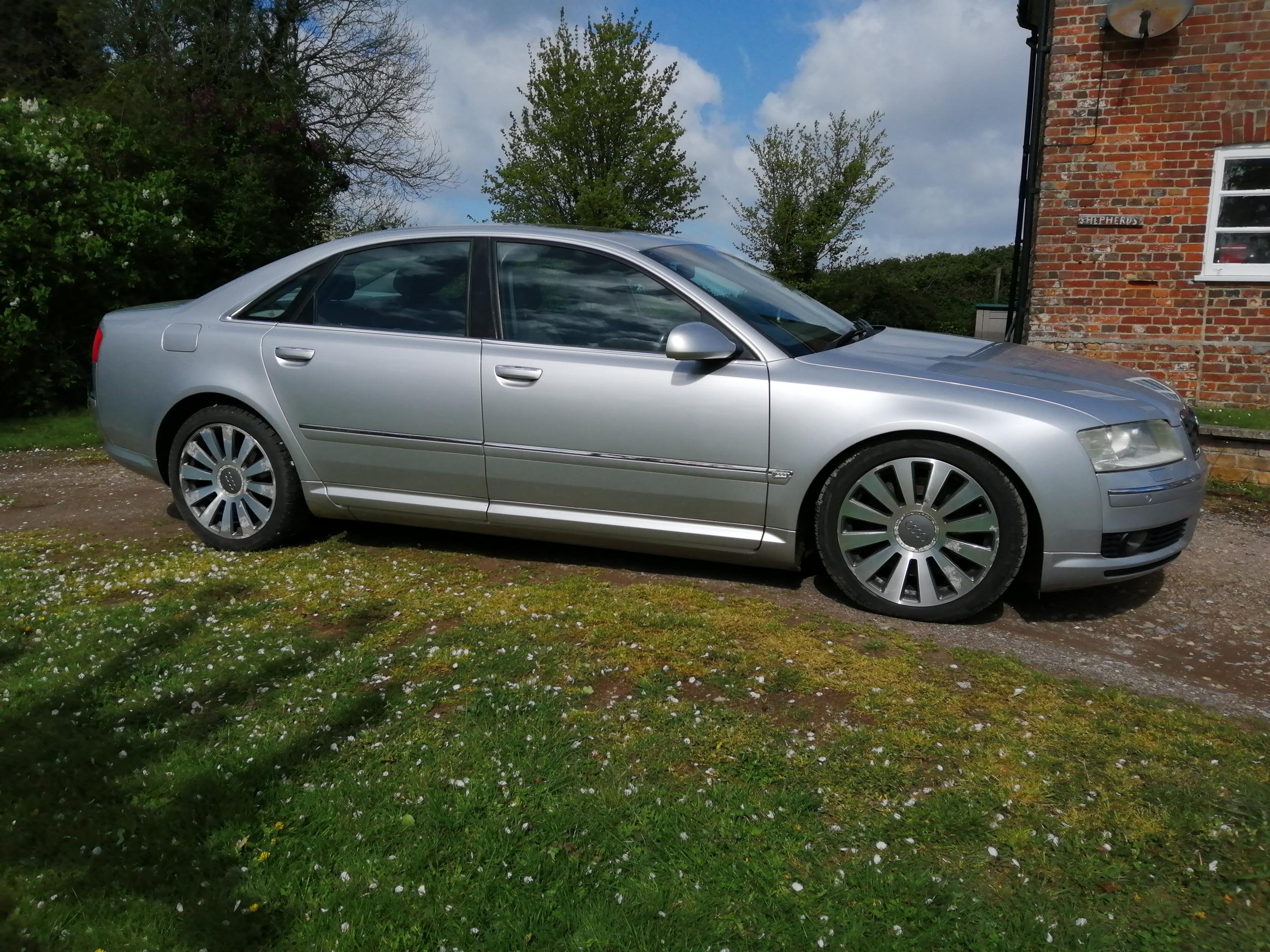

Mine sinks right to the bottom, there is zero suspension on my right front. You can feel everything if you try and drive it, it's not pleasant.
Rear is perfectly fine, and holds air with no problem.
Hopefully I'll get around to fixing it sooner or later, I did move her slowly (in jack mode) to another part of the farm so I could clean her yesterday. First time it's moved in a while and apart from the front all is well.
ignore the off height of the rear suspension, the car was moved in jack mode and the ground is not level where this is taken. The level is fine outside my house.

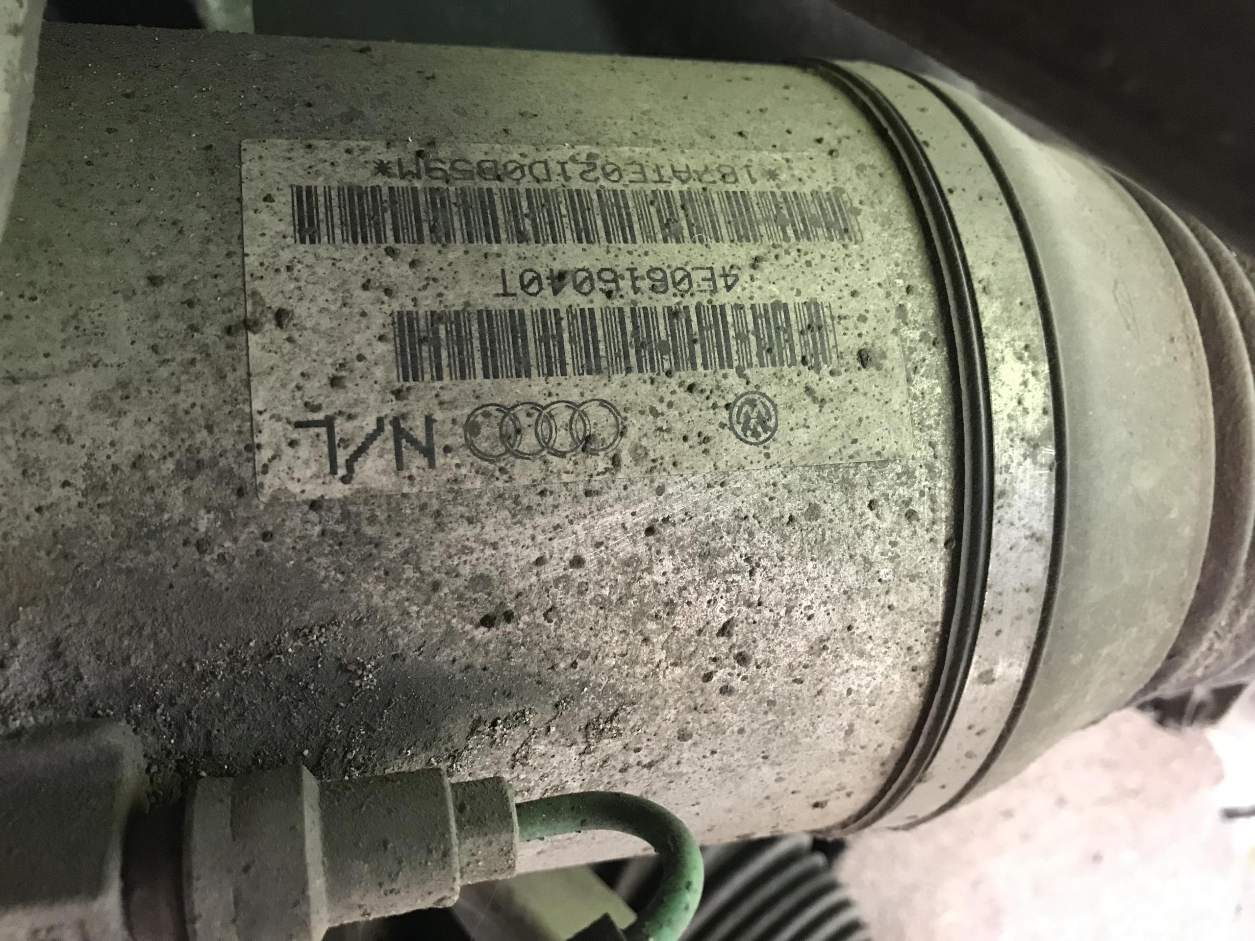

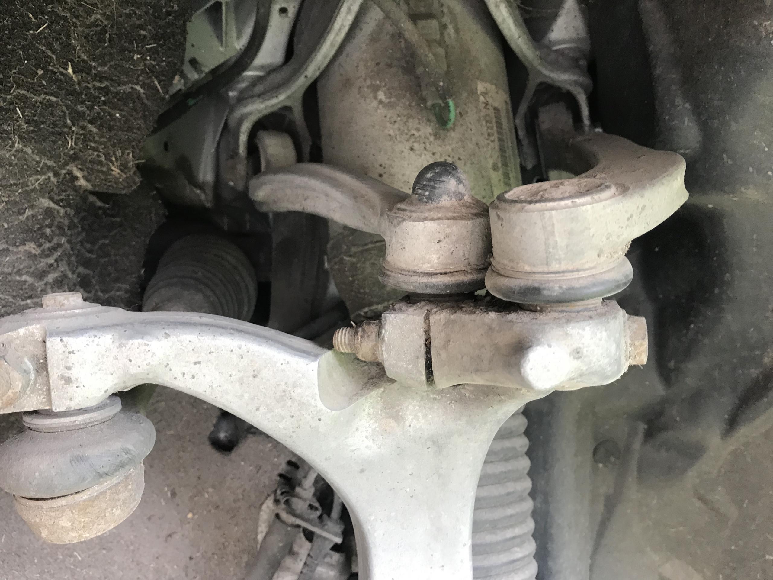

Took the wheel off today to have a look at how it would be to change. After cleaning things up they do not look too bad, but I do not have sockets or spanners big enough.
Pictures below are of what I am dealing with. Not sure if the strut is original or not based on part number.
