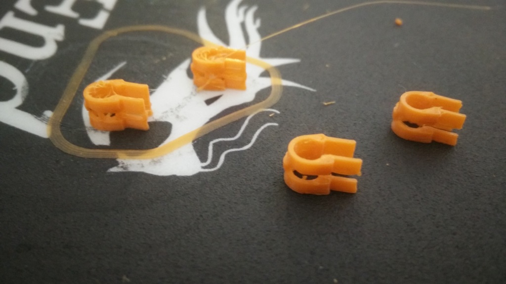

V2 printed in orange PETG (similar to what pop bottles are made of):
Markiii - PM me your address and I'll send you a set to test

well the excellent news is that they fit and they work.
if I had one observation is that you have to be careful how you fit them as they are more brittle than the metal ones, too much twisting to fit can easily snap them clean in 2.
hopefully not an issue once all fitted. At present they work fine but will report back.
thanks MJ

looks like the drivers side door panels have already had these lost. how anyone managed to get them back together an the handle working without them is beyond me
