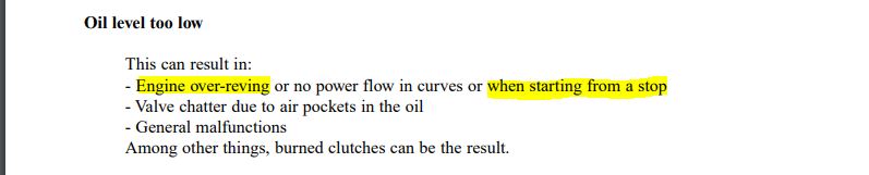

I am hoping this is the issue, it says from ZF manual overevving when starting from stop which implies it could be slipping when moving off but be fine afterwards which is what I am experiencing, plus the valve chatter could be the noise I hear on downshifts.
