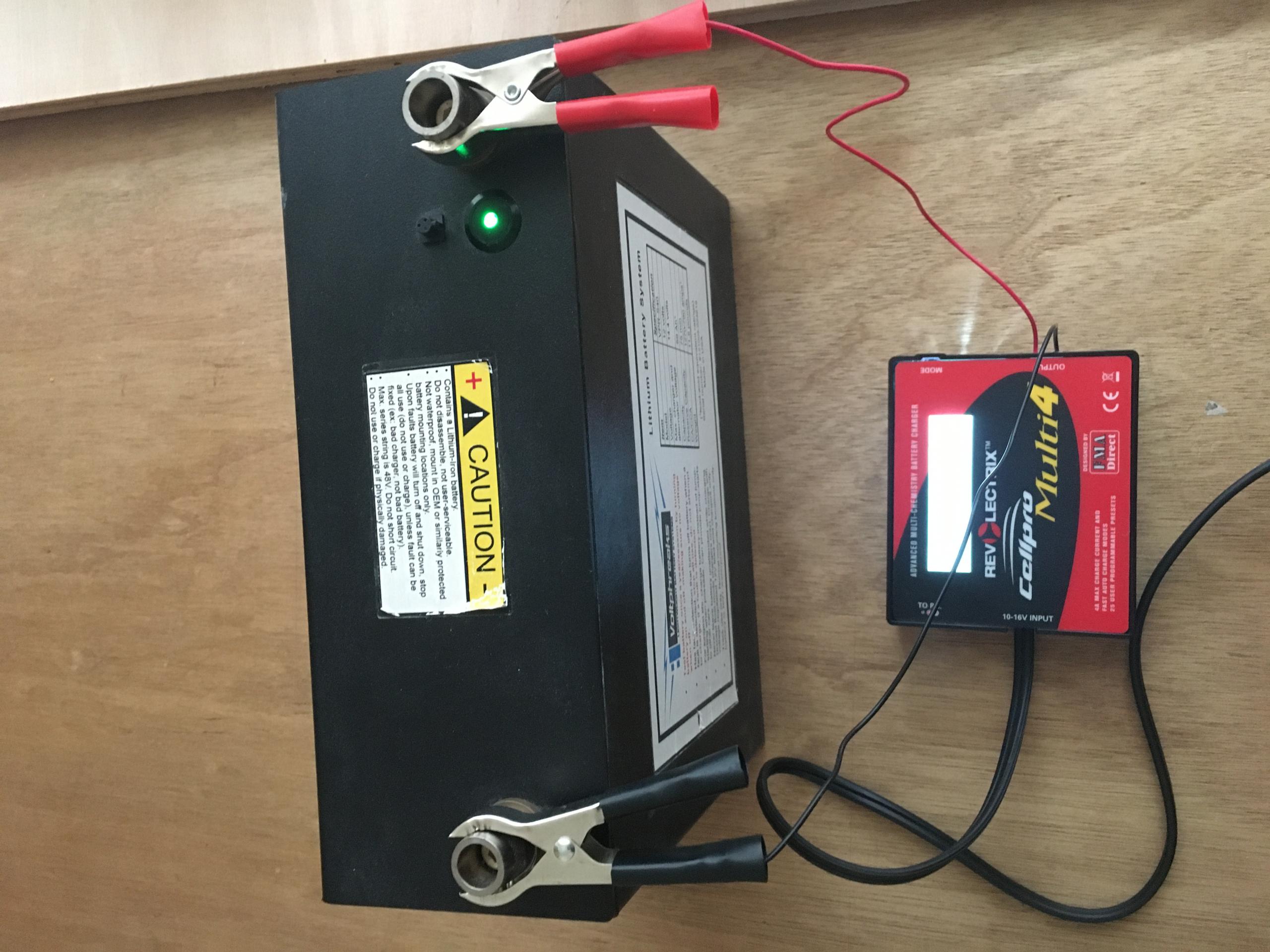

Just for info, I charged the battery back to full again, using a smart charger which displays capacity that went back in.
It put 4.8Ah back in. It seems to add up, at 25A draw, that's 11.5 minutes

These little RC chargers are great! I was worried I didn't have a charger that can charge LiFePo4, as it turns out this little charger I already had for RC planes can do it!
Charges at 4A current.
