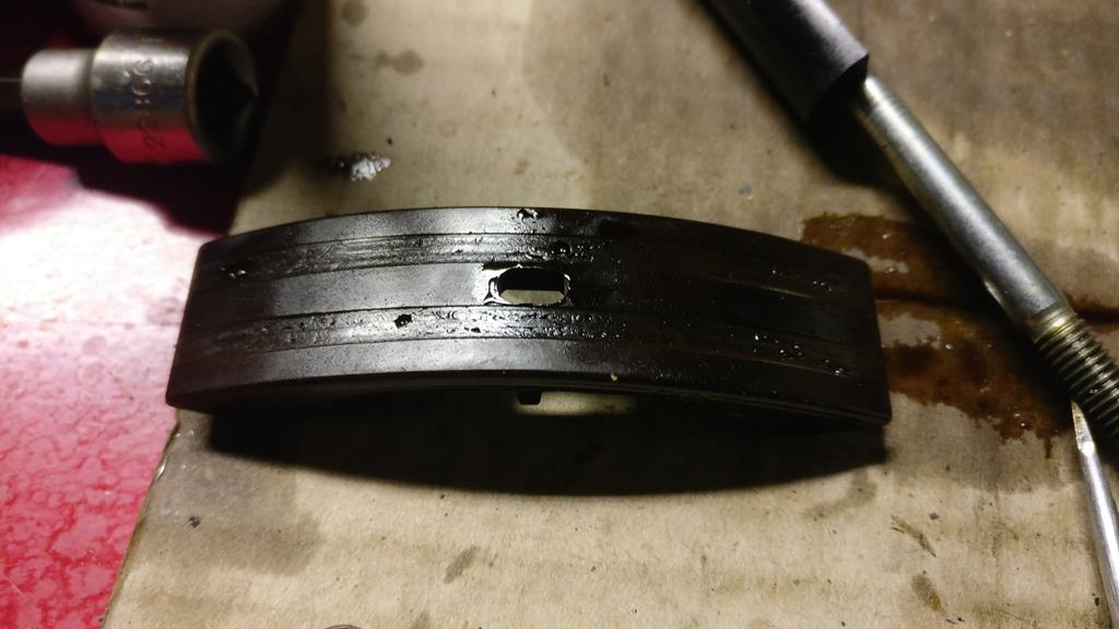

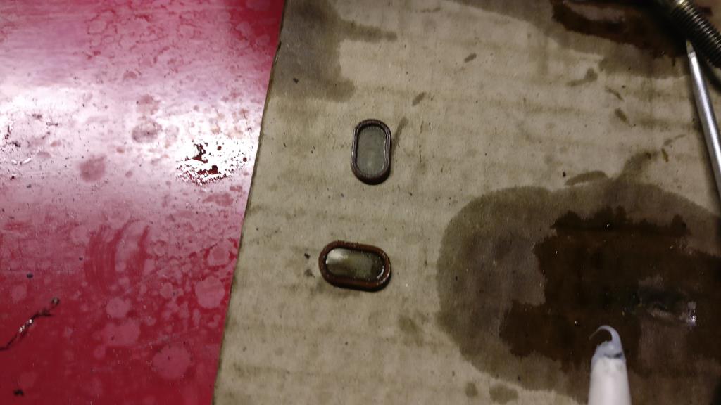

However, dismantling a 130K engine with still-working tensioners has proved instructive. Both gauze filters in this one were still intact, as expected since the tensioners still worked:
Removing one of the tensioners I think I found not only the reason for the gauze filter in the first place, but also the reason for the filter failure and subsequent tensioner failure - carbon build-up from inside the oil galleries. I didn't get a pic, but underneath the gauze there were tiny chunks of the carbon found in the sump, cam covers etc. As the tensioners have rubber o-rings in them, I think Audi put these filters in to protect them from this carbon, whereas camshafts, crank bearings etc, being metal, wouldn't be affected. The problem though, is that the carbon will eventually accumulate behind this non-replaceable filter which then gets clogged and oil pressure just punches through it. The broken filter material then gets pushed through the tensioner and destroys it.
On balance, I'll take my chances putting the carbon through the tensioner rather than stainless steel mesh, and change the oil more often.
The tensioner pads were in remarkably good condition considering the mileage, but of course I replaced them since everything was in bits

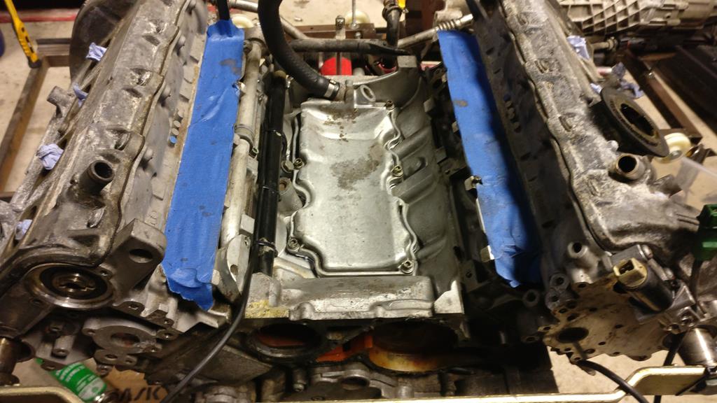

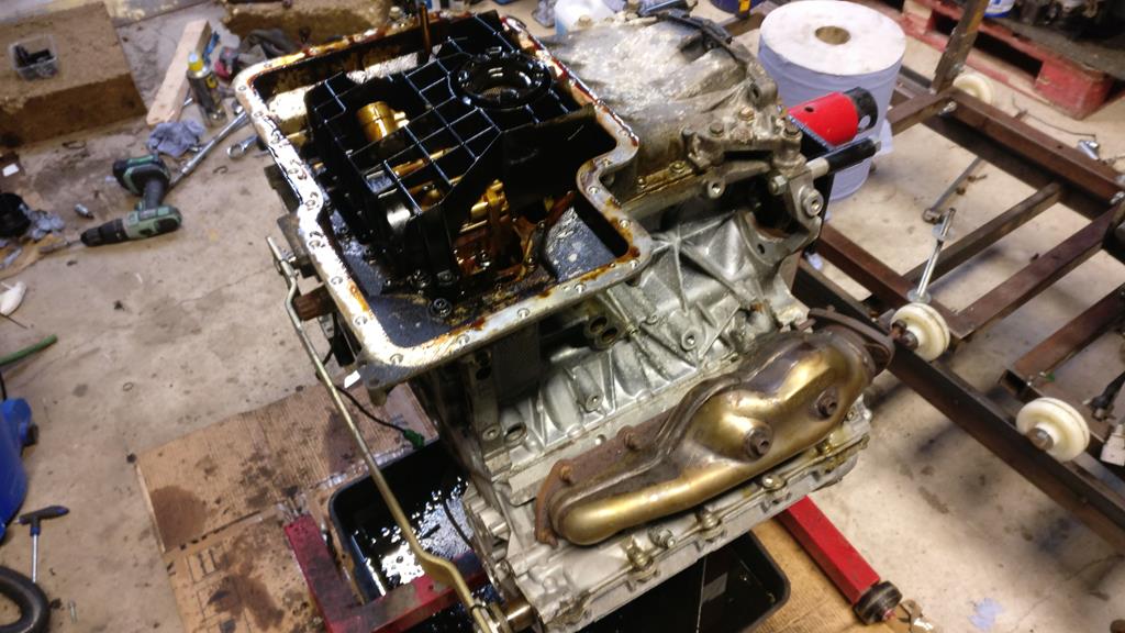

An upside-down engine is oddly satisfying

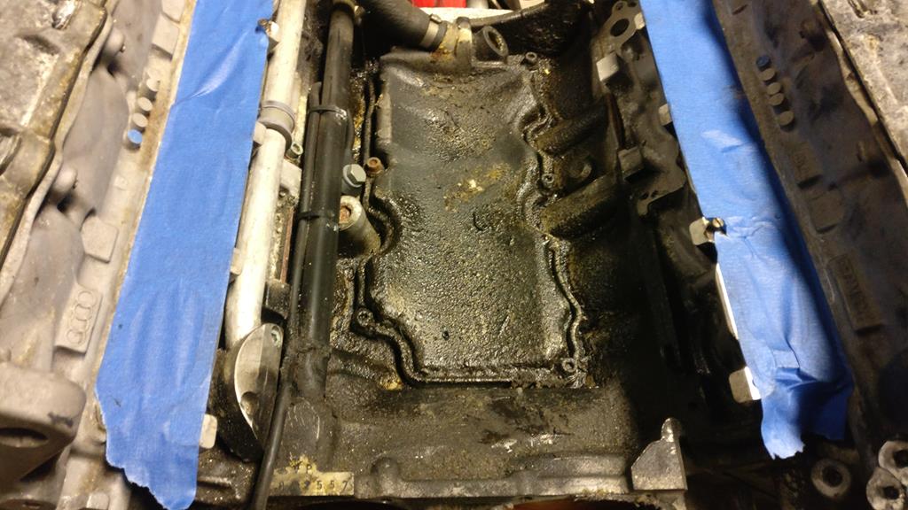

Its considerably easier to replace the sump like this

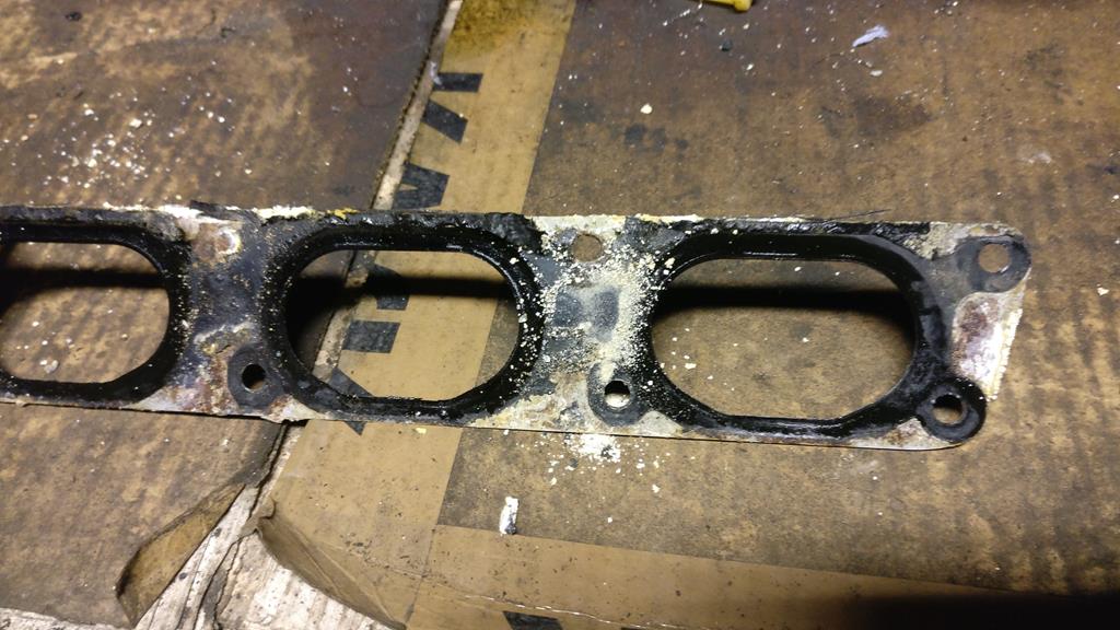

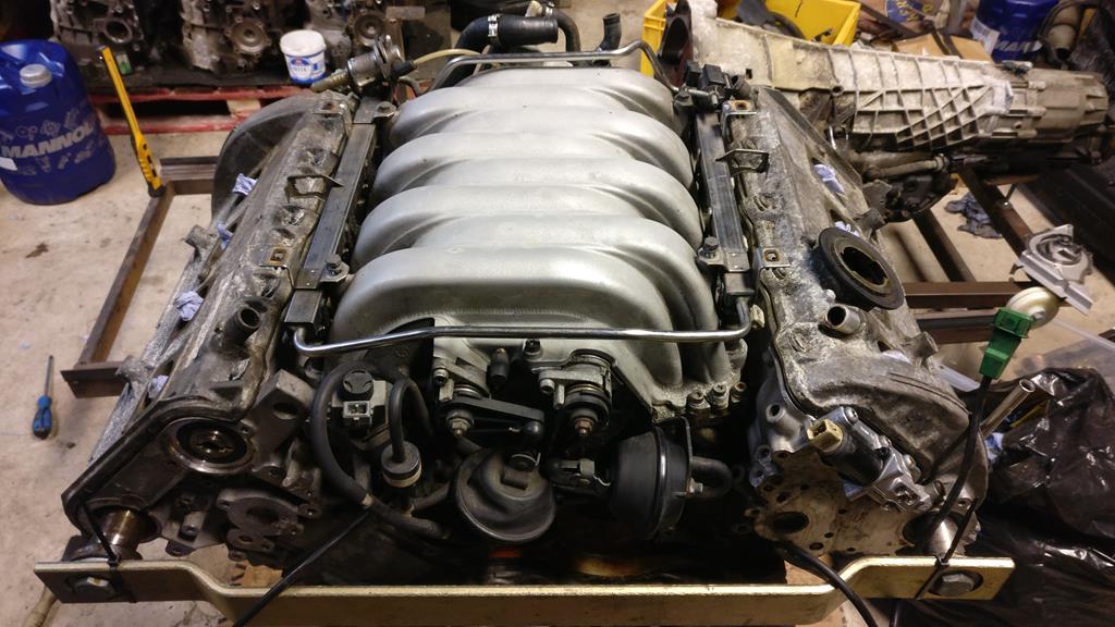

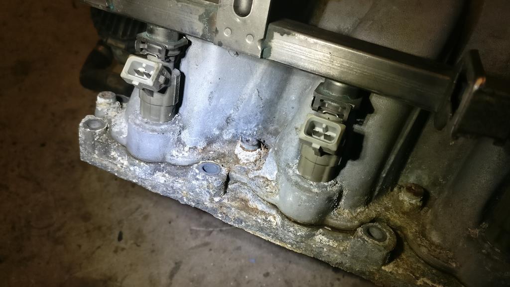

Another bonus of having the engine on the stand is that I can take the inlet manifold off with it upside down, thus ensuring none of this detritus falls down the inlet ports:
I have no idea why these engines collect so much grit in this area

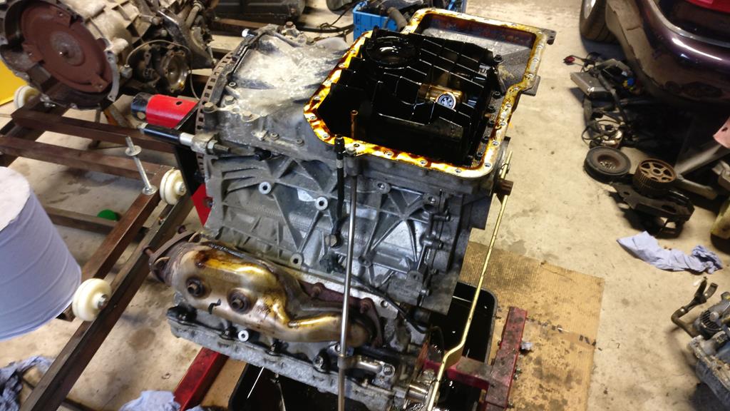

Grit removed, sump re-sealed, and back the right way up again. The usual sand and oil mess in here
Better

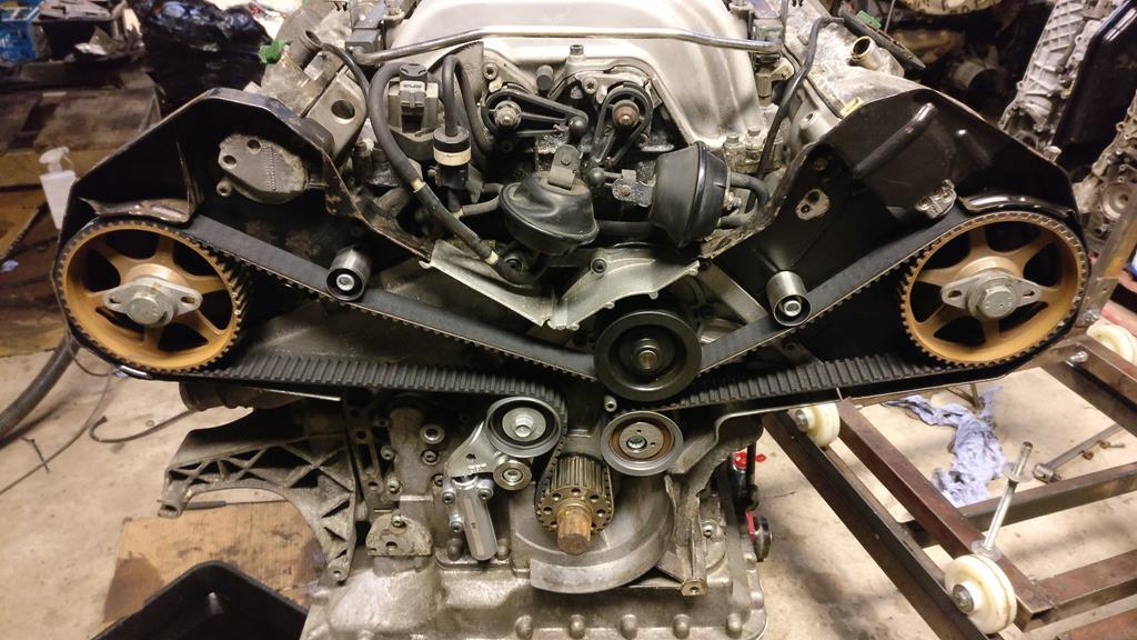

Inlet manifold back on

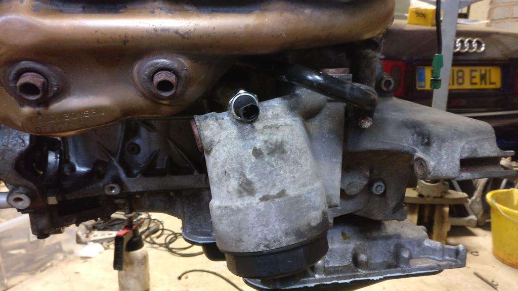

Oil cooler back on with an aluminium link pipe and new pressure sensor
Water pipe and various bits back on the rear

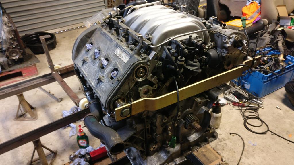

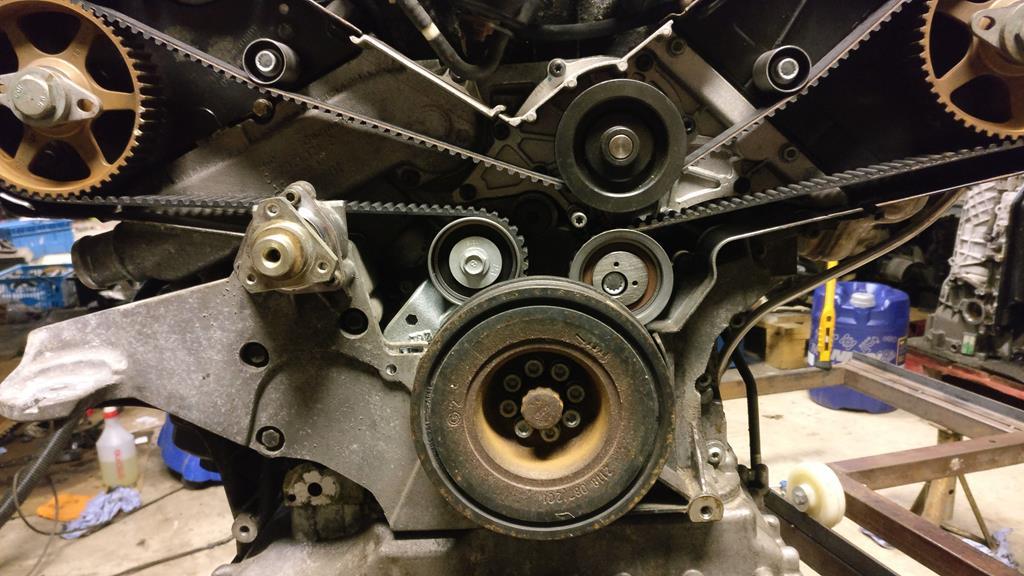

Ready for the the timing belt to go back on

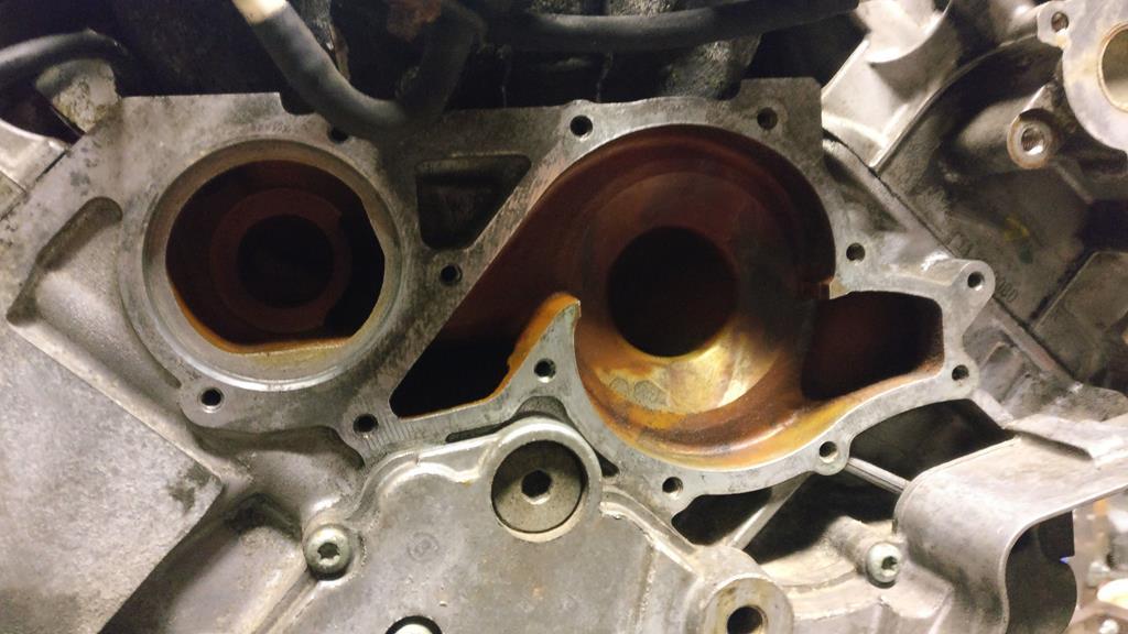

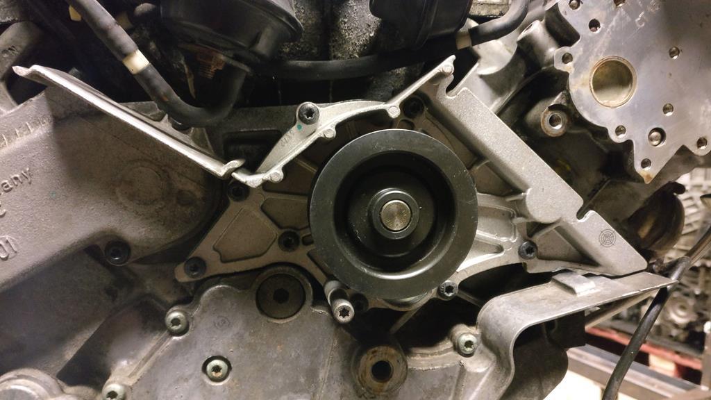

Water pump mounting surface cleaned up
I took the slightly unusual step of chasing out the threads with a tap, since the last water pump was stuck on with lots o silicone which had made its way in to the bolt holes, so that needed cleaning up and removing otherwise it could hydrolock the new bolts
Water pump on with new bolts
New belt kit on

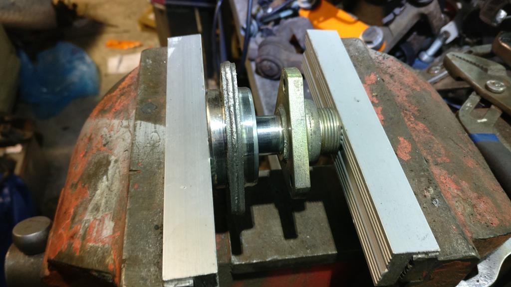

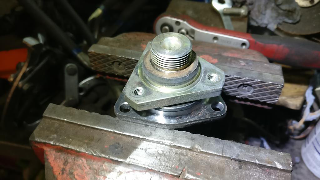

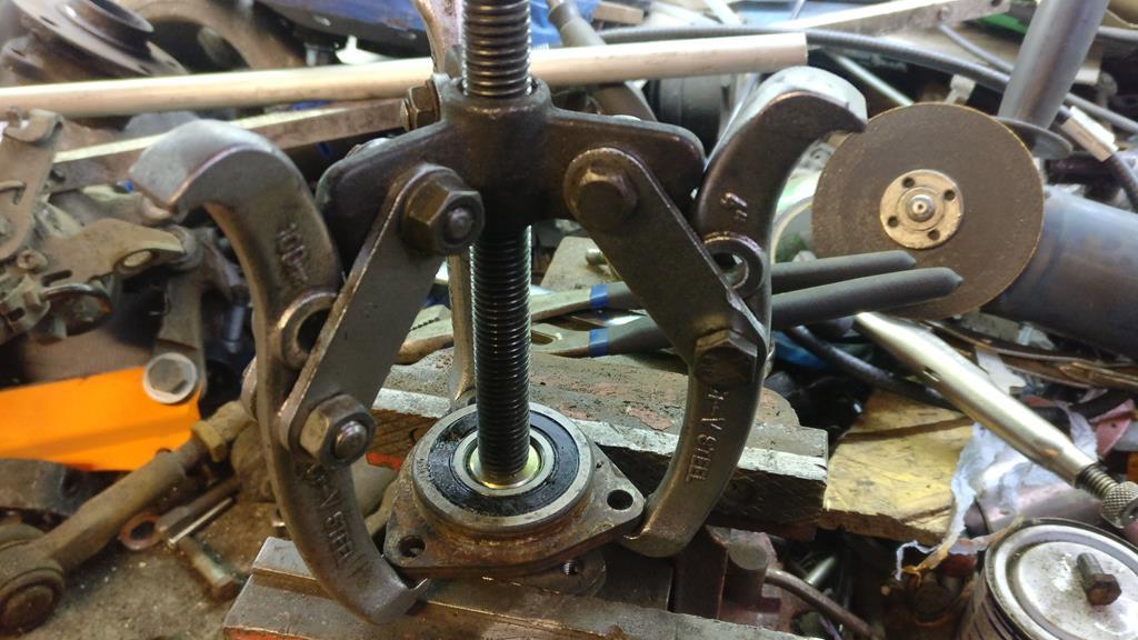

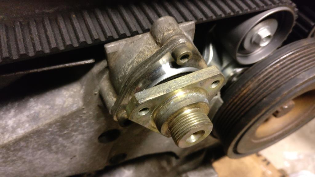

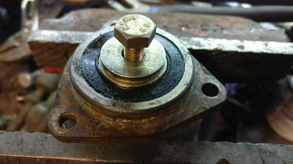

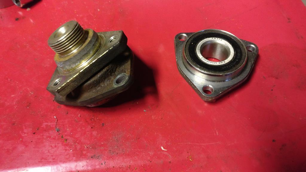

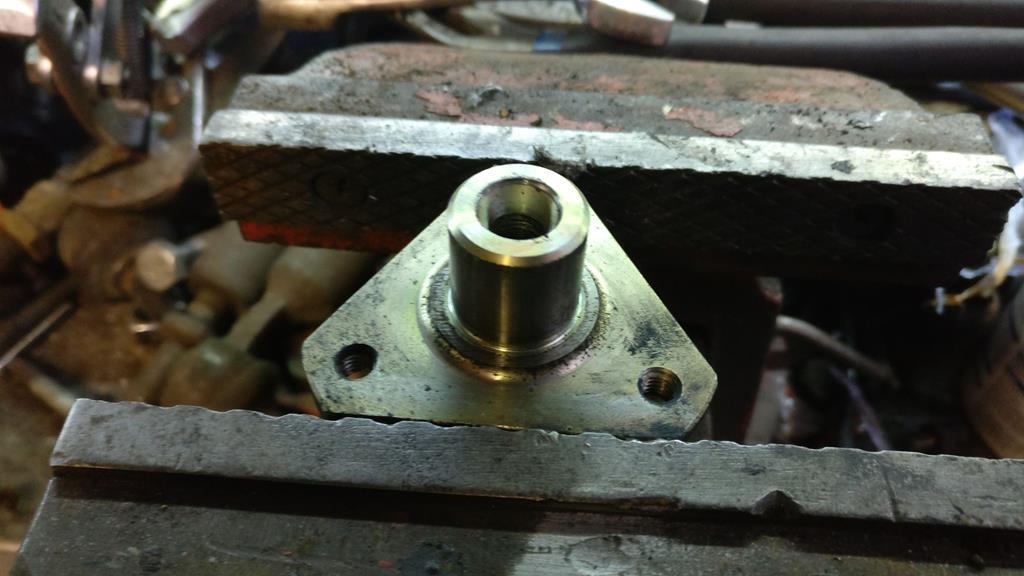

When we got it fired up originally, it was making a lot of noise from the hydro fan, which I thought was the coupling causing the fan to run at full speed, but when I took it off the coupling was fine. It turned out the noise was actually the fan bearing itself which is very loud and grumbly. Luckily I now have a sensibly priced solution to this
The fan mounting hub is bolted in to the bearing
Pull the bearing off the hub
Hub with the bearing removed
Press the hub in to the new bearing
Bolt back in and it runs nice and smooth again
Back on the engine

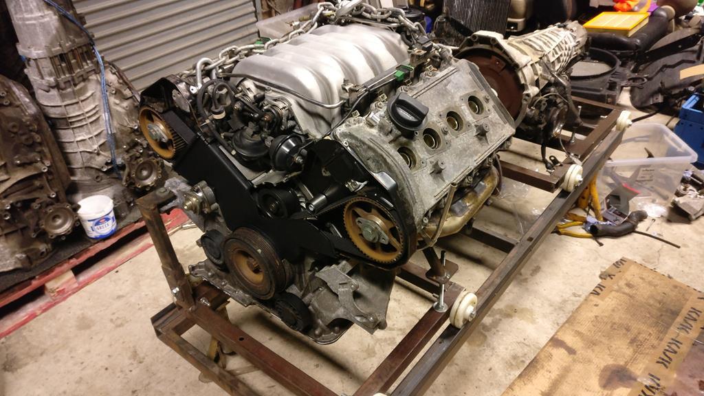

That concludes all the engine work for which it needs to be on the stand so its back on the separating machine. I still need to reattach the coolant hoses, spark plugs & coil packs, ancilliaries, and then fit the replacement wiring harness but that'll happen when its reattached to the gearbox.
