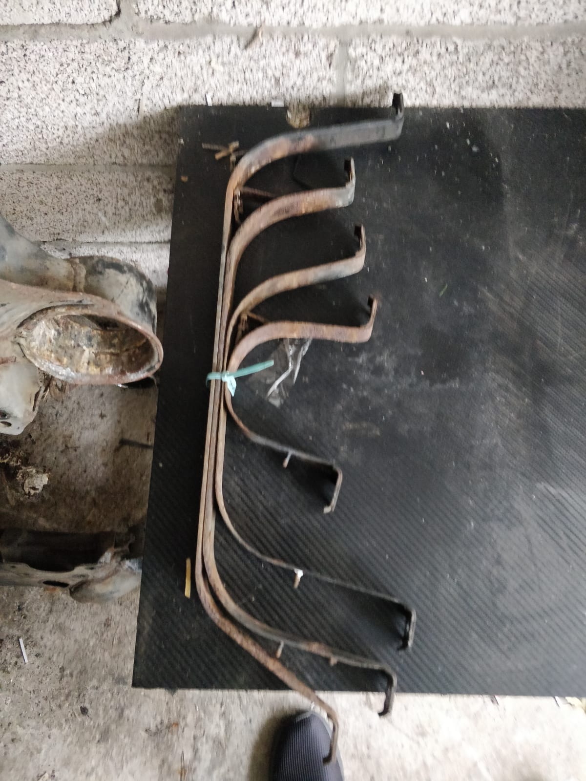

I've got my subframes and fuel tank brackets ready for powder coating, I'll let you know how much it was so maybe we can compare to other parts of the country
ID:	27376   Click image for larger version

this is the type of corrosion i have been seeing on many Audi,s
mainly the scottish ones or been near the coast
we have shot blasted 2 now off audi A2,s that we have been refurbing
thank god the D3 has an alluminum one
