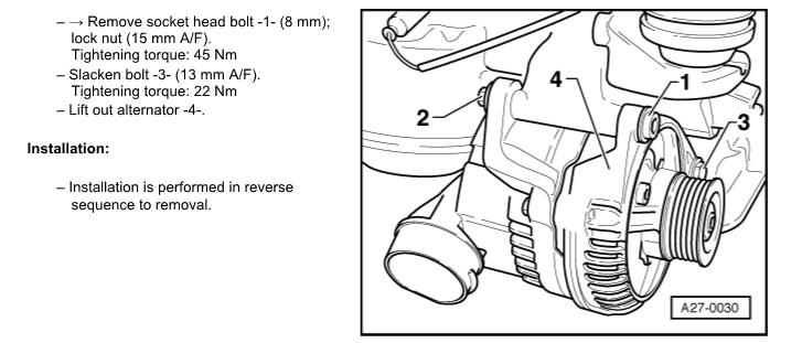

Quick look today, one thing I have an issue getting to is item 2 as indicated below. Info says Lock nut 15mm A/F. Ok is it a prise out, unscrew or what? I can't seem to get a spanner near it as the other dipstick (one being me) tube is in the way.

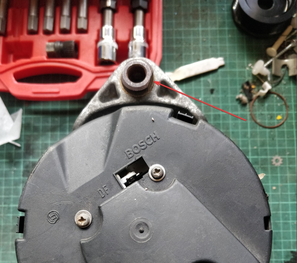

You just have to undo the bolt, the nut is part of the alternator casing and is permanently attached to it
Now that makes sense. Cheers Ronin.

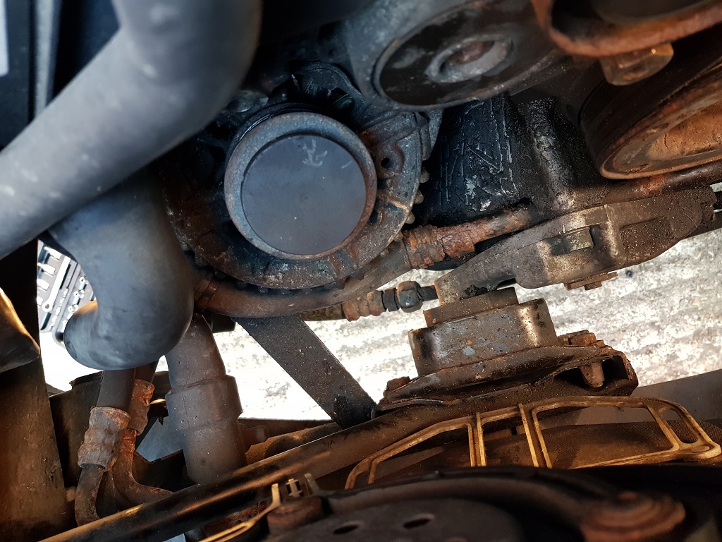

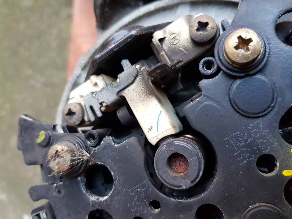

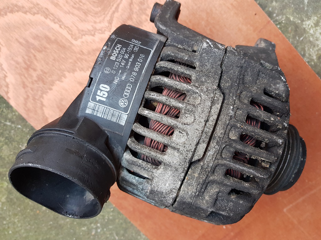

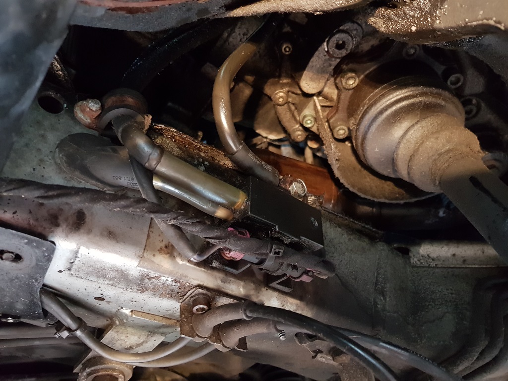

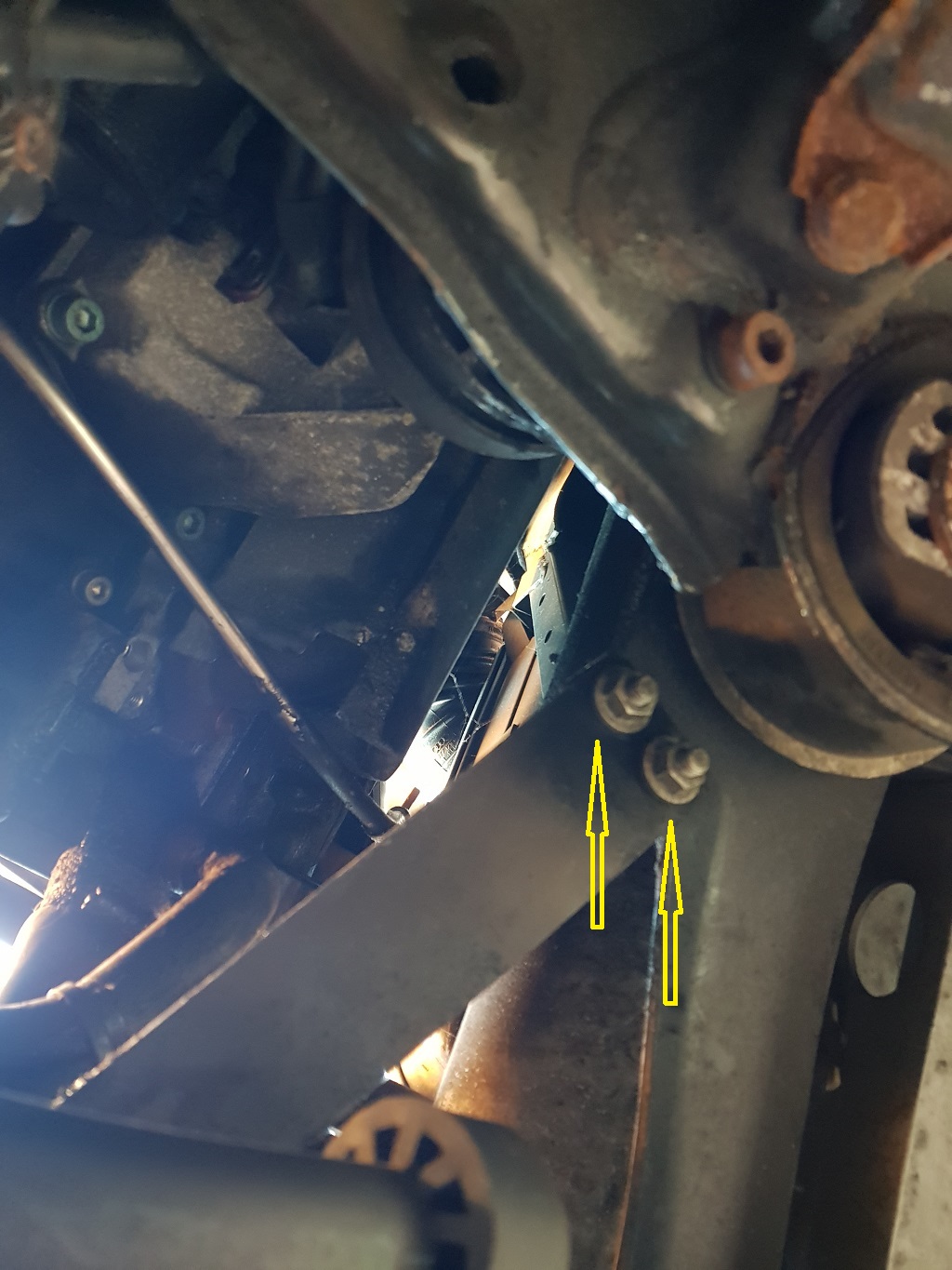

OK. I took out the Alternator today:
Quick look at the junction box - all seems good.
wiggled it so the back end dropped out below.
Removed two bolts from a 'brace' or strap consisting of thin steel which gave enough downward movement to remove the alternator from below. No removal of coolant hoses or fan body to facilitate this
The alternator.
The regulator / rectifier?
I found that there was some 'clutch' when spinning the alternator clockwise, but looking at the overall condition I am thinking it wise to source a new replacement
