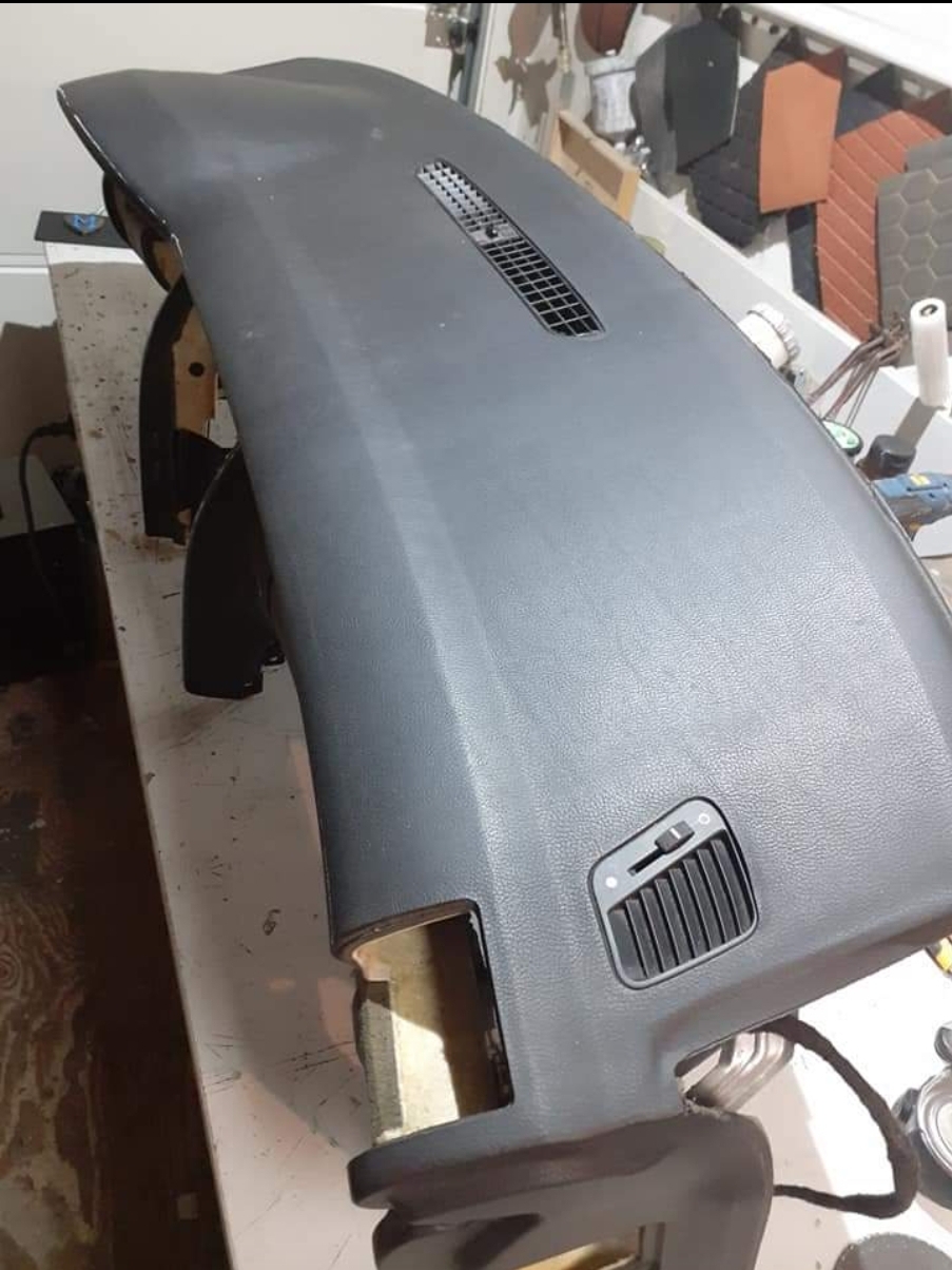

From the windscreen vent being slightly recessed it appears to be the regular dash with leather over the top. I was sort of expecting the original dash moulding without the vinyl to make up for the extra thickness, but that doesn't seem to be the case with it in the car. I'll find out more when it comes out.
I would concur. I was slightly disappointed that it does indeed seem to be a standard dash with the leather plastered straight on top, but as Sarg has just suggested, it does pave the way to potentially doing it aftermarket and it should look no different.
The D3 is the same, with the leather on top, so some of the plastic fittings aren't quite as flush as they should be.

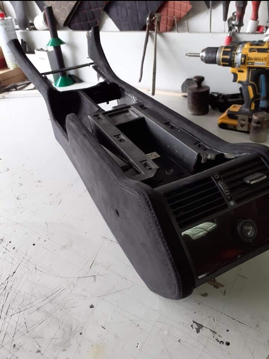

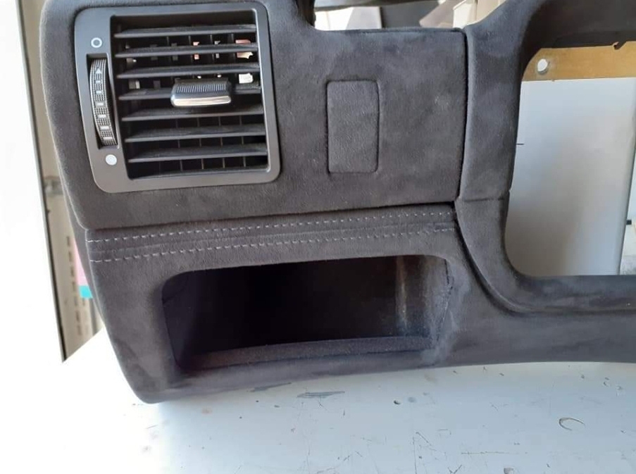

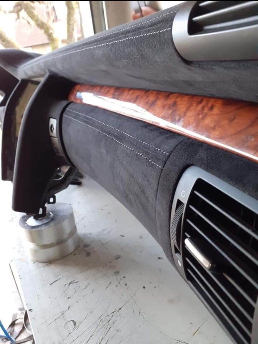

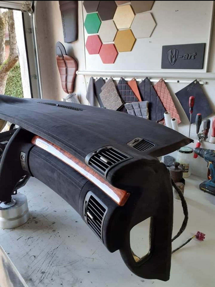

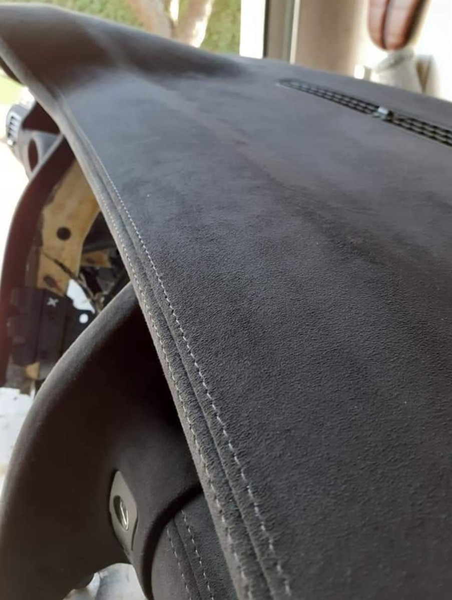

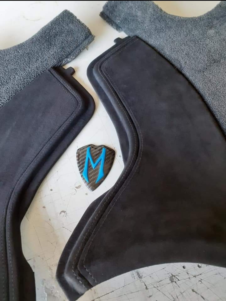

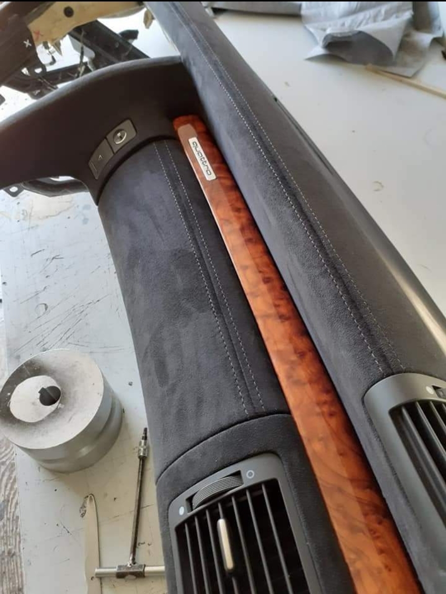

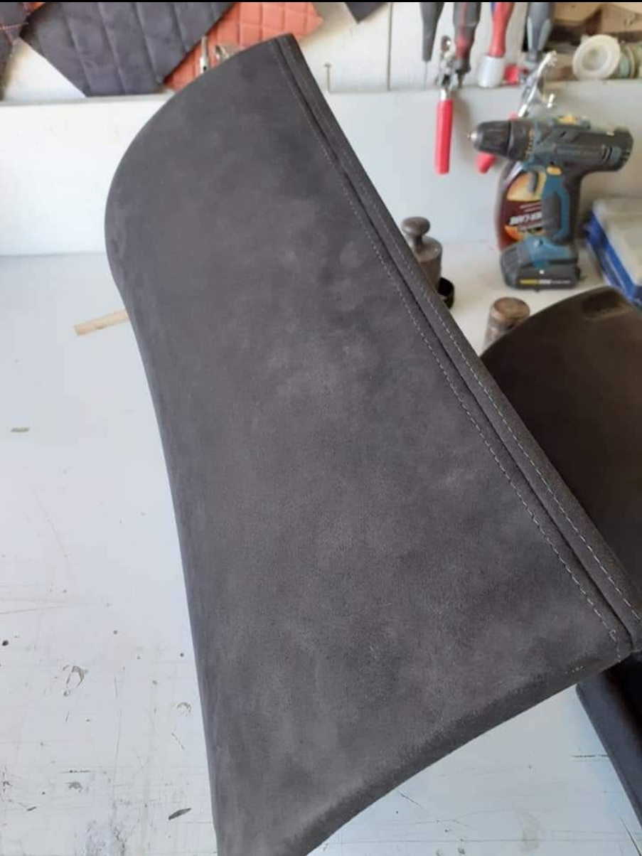

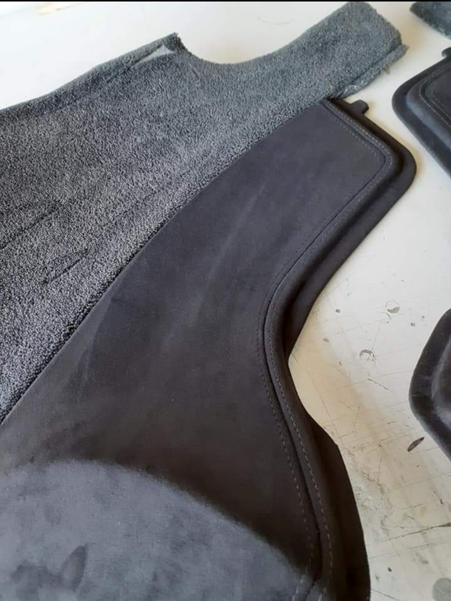

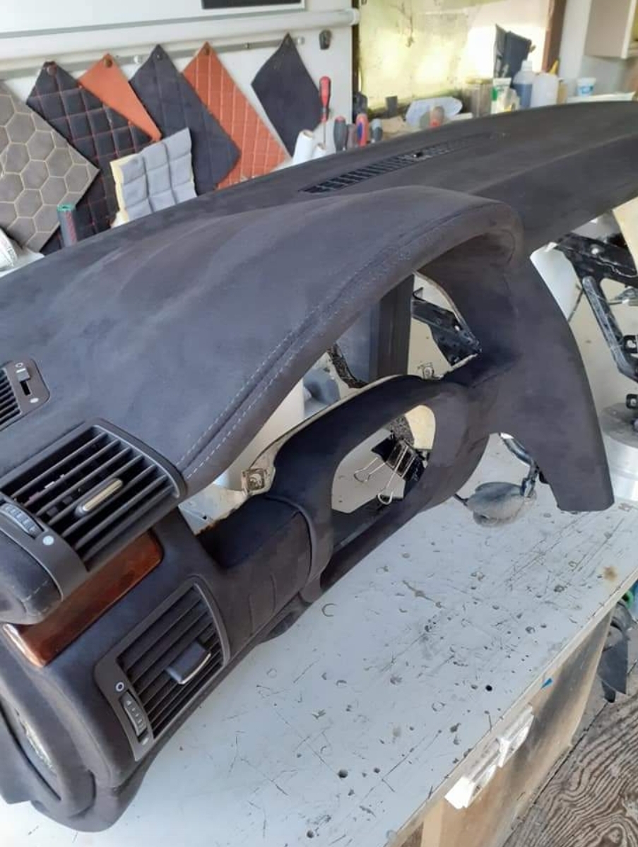

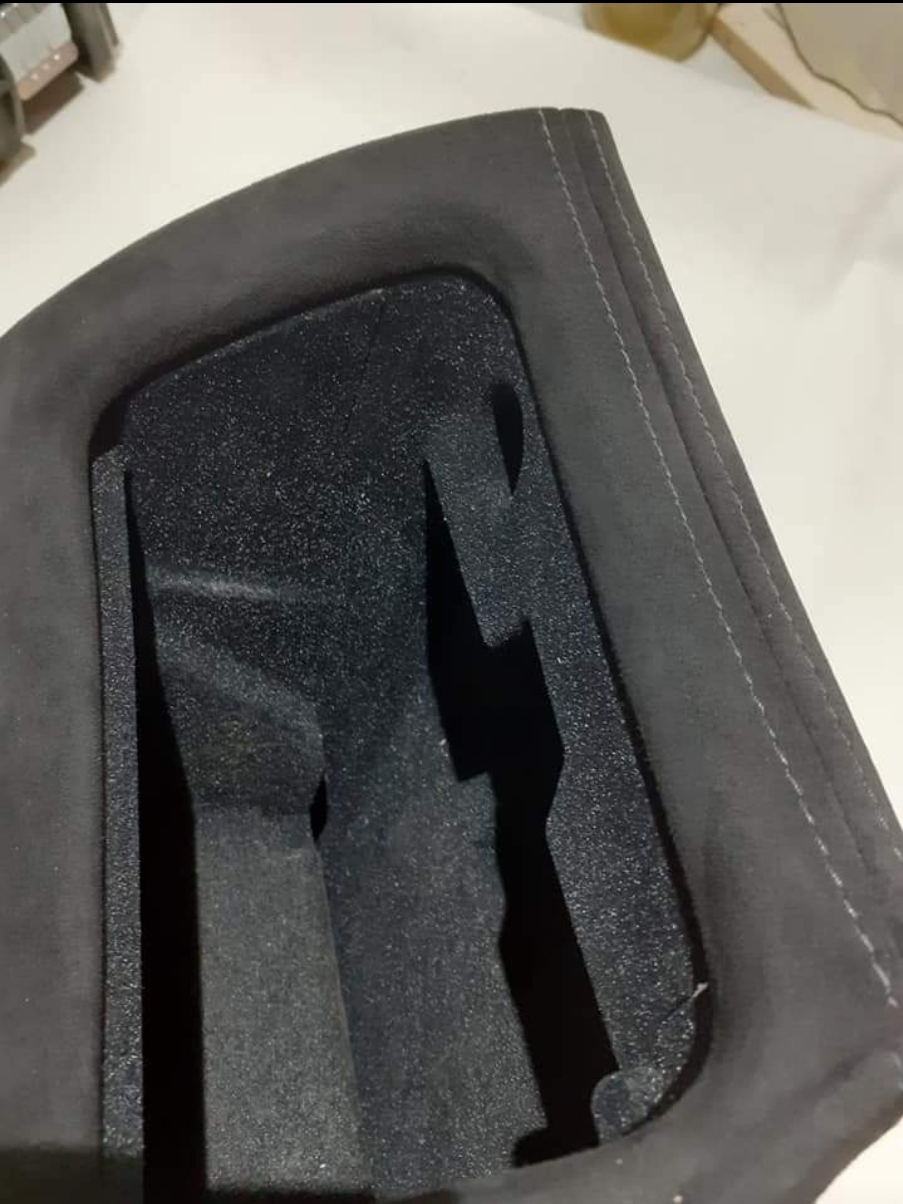

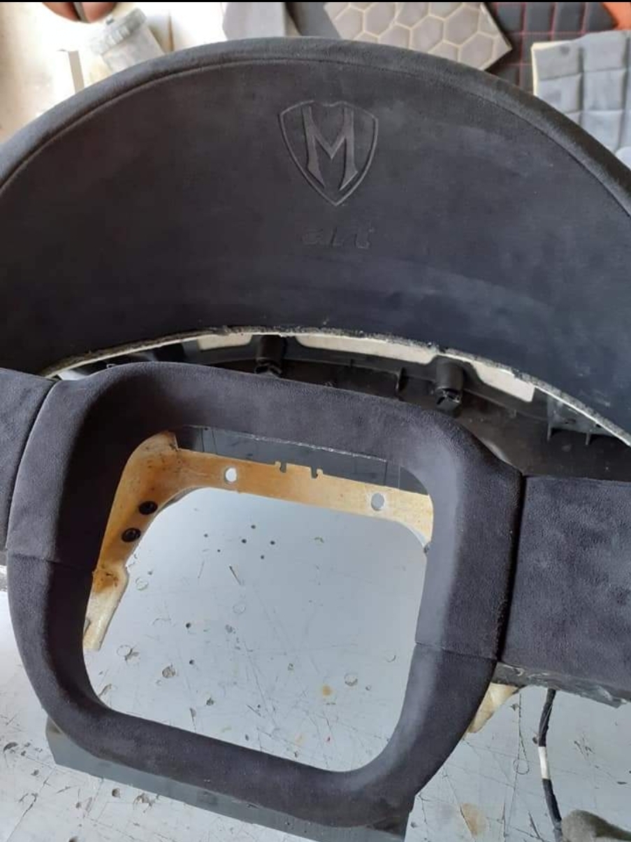

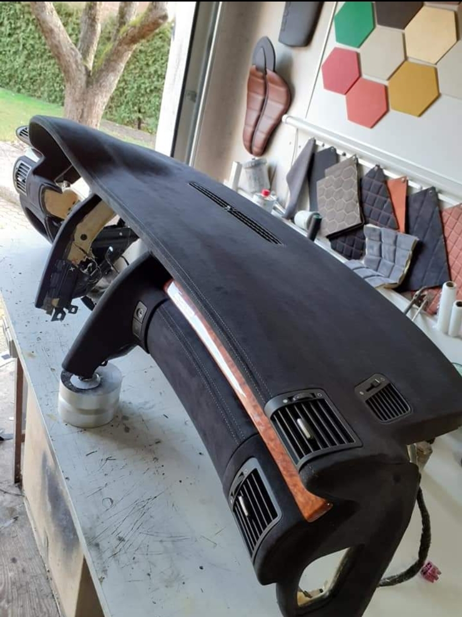

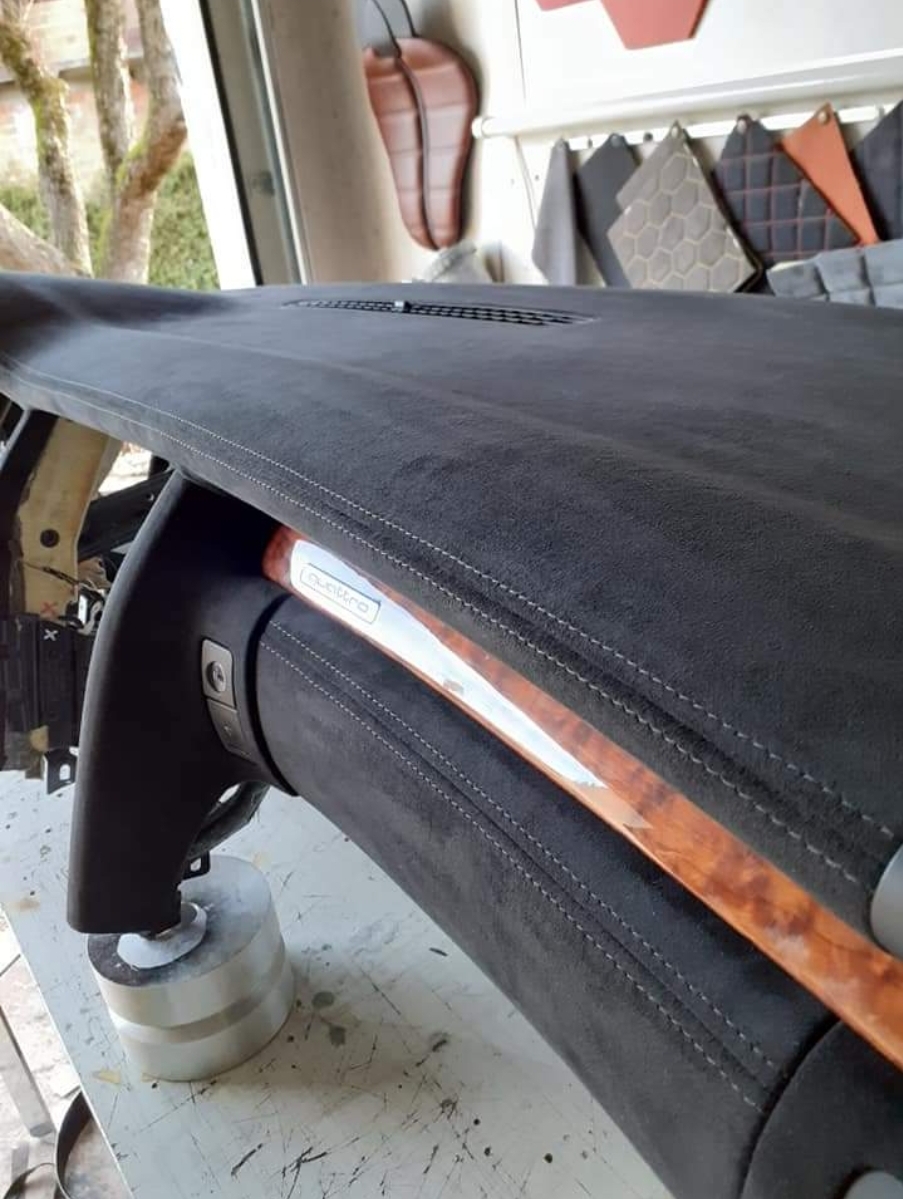

I saw this back in 2019 on Facebook by a company called M-Art. I think they are Croatian.

A nicely hidden logo above the cluster.
Theres a guy on the polish d2 group that has a suade covered dash with red stiching, it makes it look like a golf GTI but this one is tasteful.

I saw this back in 2019 on Facebook by a company called M-Art. I think they are Croatian.[
Oooh that’s rather nice

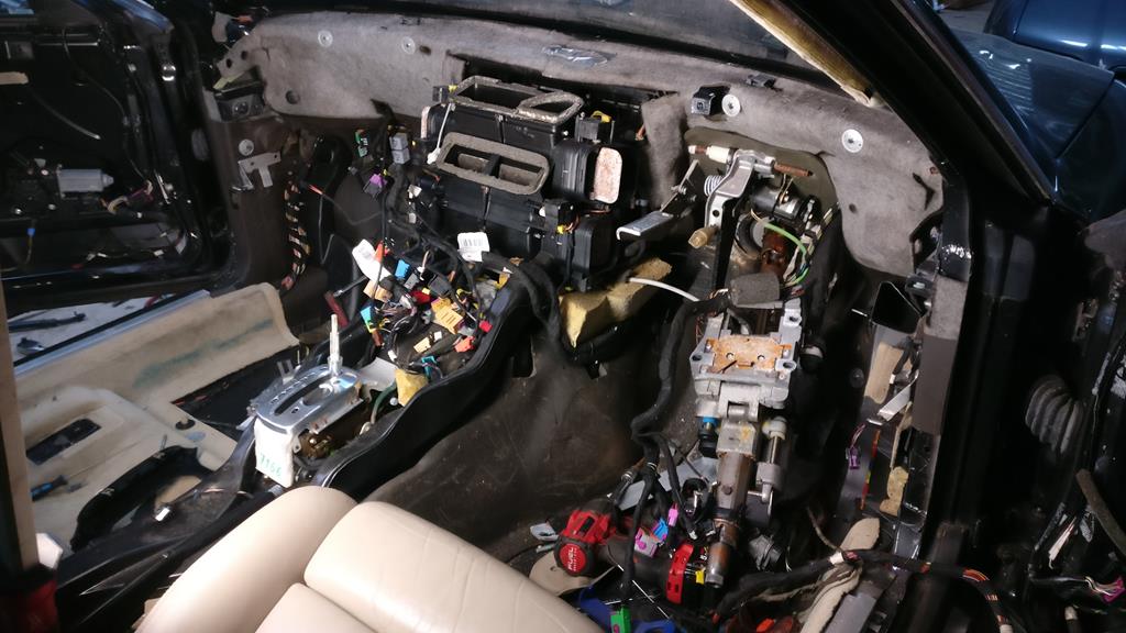

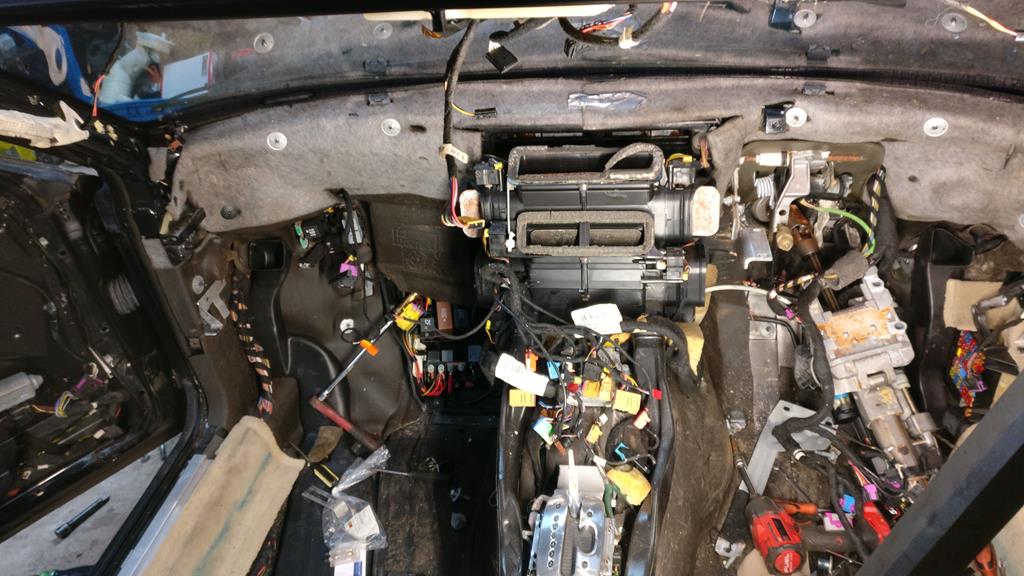

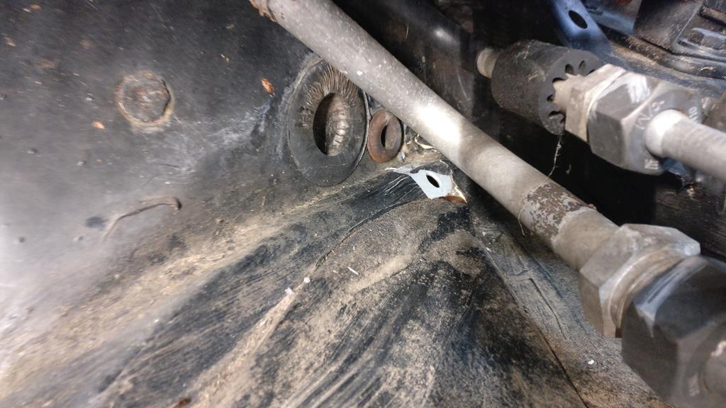

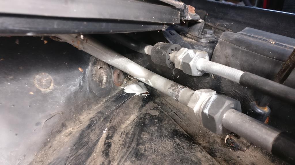

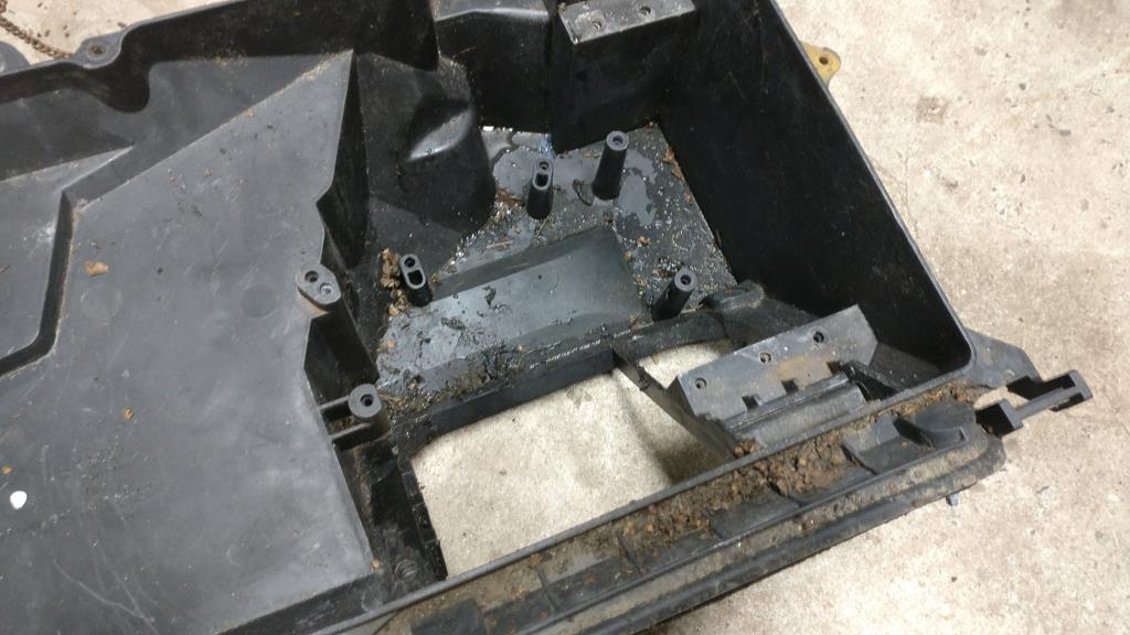

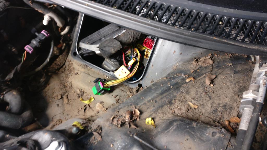

A bit more progress on this, including liberating the dash.
Genuine heated screen, which these days is worth more than the rest of the car!

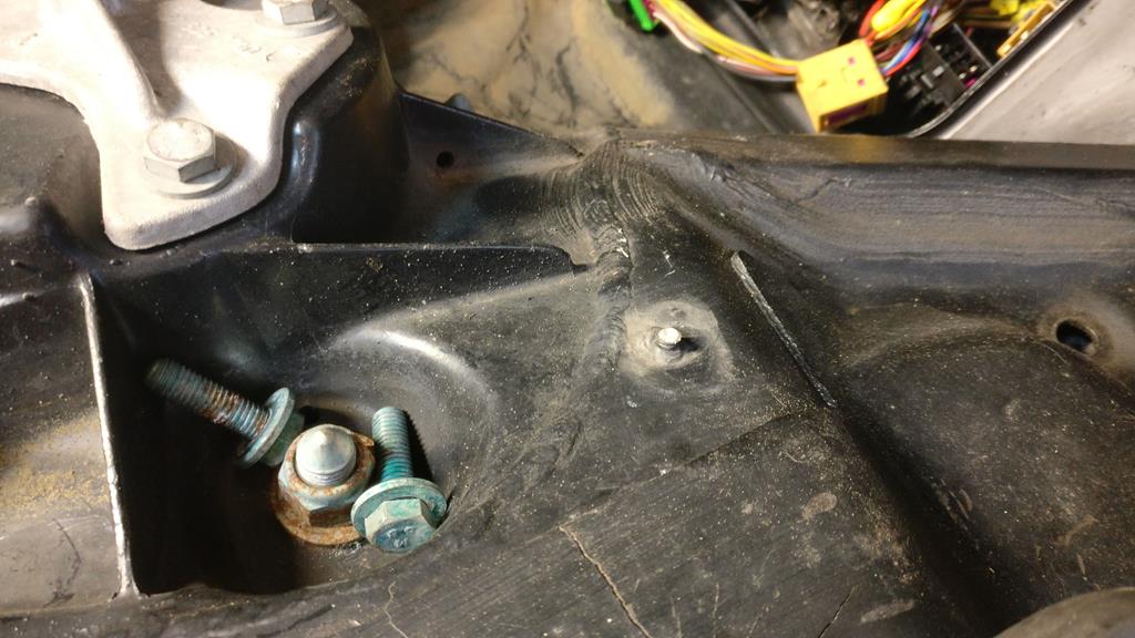

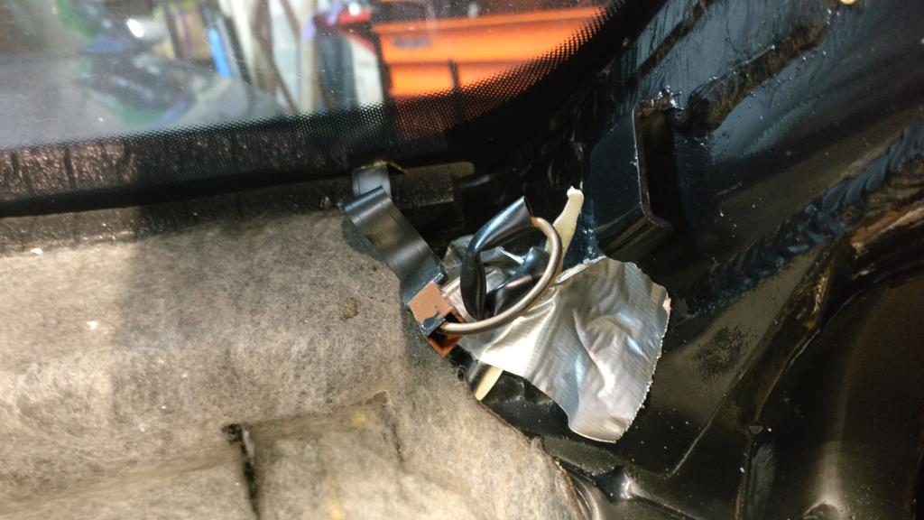

Botang's hole which caused much of the sadness in the cabin. Since the dash is out its trivial to pull the electronics box and fix this now for the next owner

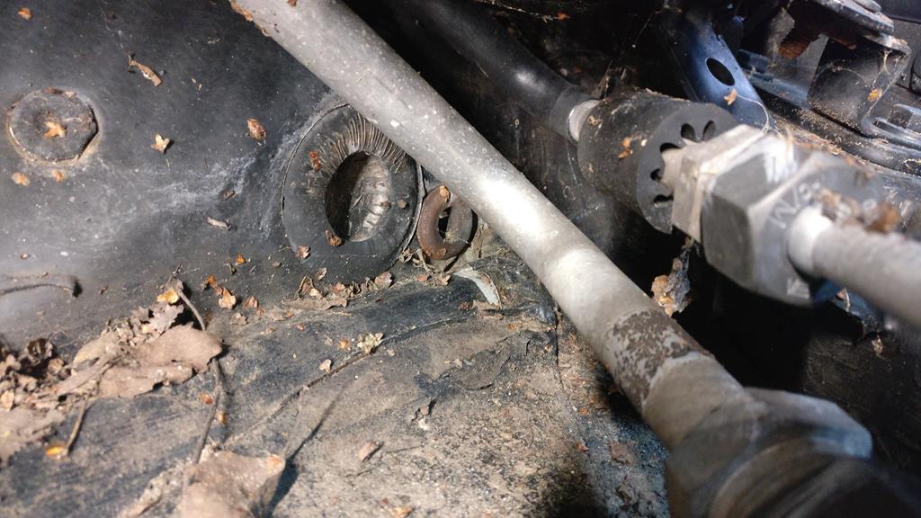

Along with loads of general crud in the raintray
and in the electronics box, which someone had attacked with silicone, trying to fix the leak in completely the wrong place
Tape removed
3D printed grommet fitted, which ought to seal the hole on its own
Coated in seam sealer to be sure

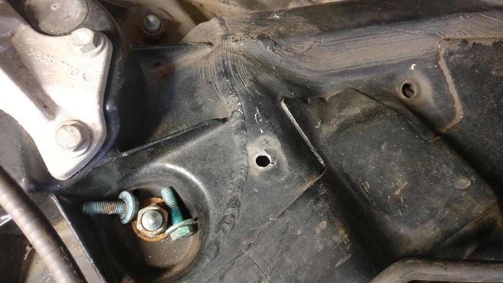

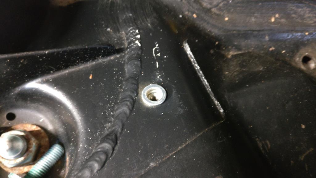

The previous perpetrator had snapped the stud holding the front of the electronics box so I might as well fix it while its out
Grind off the stump and drill a hole
Rivnut

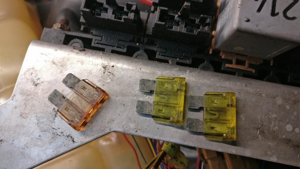

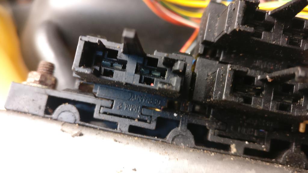

The fuses are badly corroded from moisture so these were replaced
Verdigris on the fuse holder terminals. All these were thoroughly cleaned with contact cleaner, as were all the electronics box connectors
Ship shape again

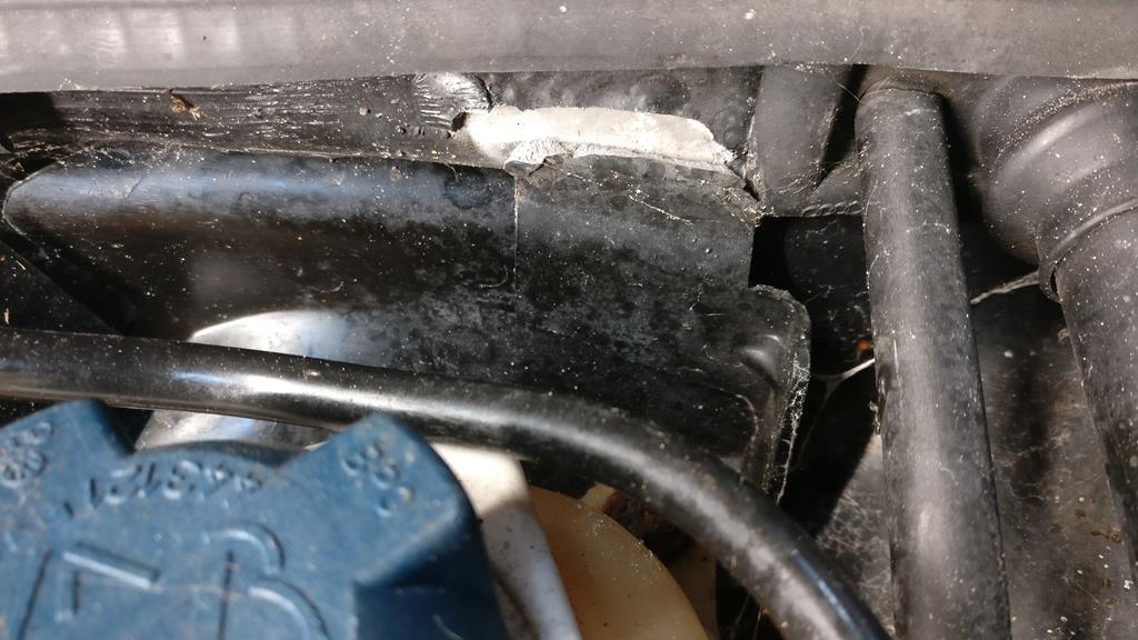

The rear bracket for the header tank is broken off. I've never seen this before but I assume it is from some gorilla leaning on the rusted screw trying to get it out. This is a future-owner problem.
