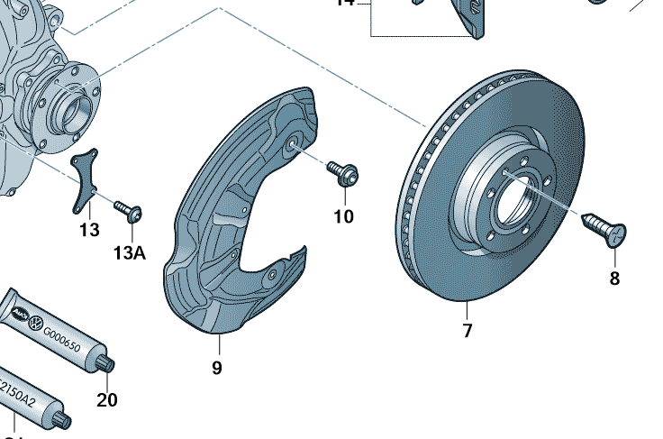

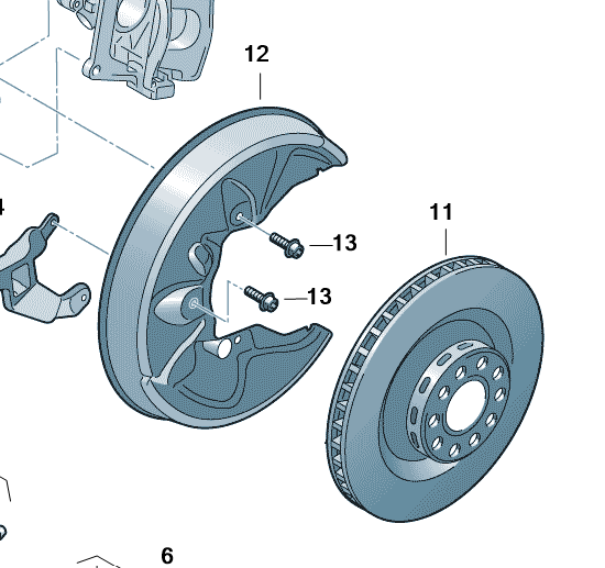

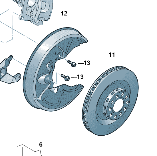

Can't give you an answer, but I can give you the part numbers and figures. I've attached images of the ceramic disks and steel disks. Don't know if these are 100% accurate, but in the image of the front ceramics, the guard appears to have like a large lip at the end.
The front ceramics are 380mm, the steel ones are either 360mm or 385mm. Part numbers for the larger front guards are 4E0615311H (left) and 4E0615312H (right).
The rear ceramics are 356mm, the steel ones all use the same part number regardless of size. Part numbers are 4E4615611A (left) and 4E4615612A (right).
Having written all that, I just decided to check out a site I've used before and they are showing all the four guards for the ceramics listed in my previous post. Some parts are listed as 'special procurement Audi Tradition' but I think it only shows up during the checkout process:

Name:	A8 D3 Ceramic Brakes Front.png
ID:	29413   Click image for larger version
Name:	A8 D3 Normal Brakes Front.png
ID:	29414   Click image for larger version
Name:	A8 D3 Ceramic Brakes Rear.png
ID:	29415   Click image for larger version
Name:	A8 D3 Normal Brakes Rear.png
