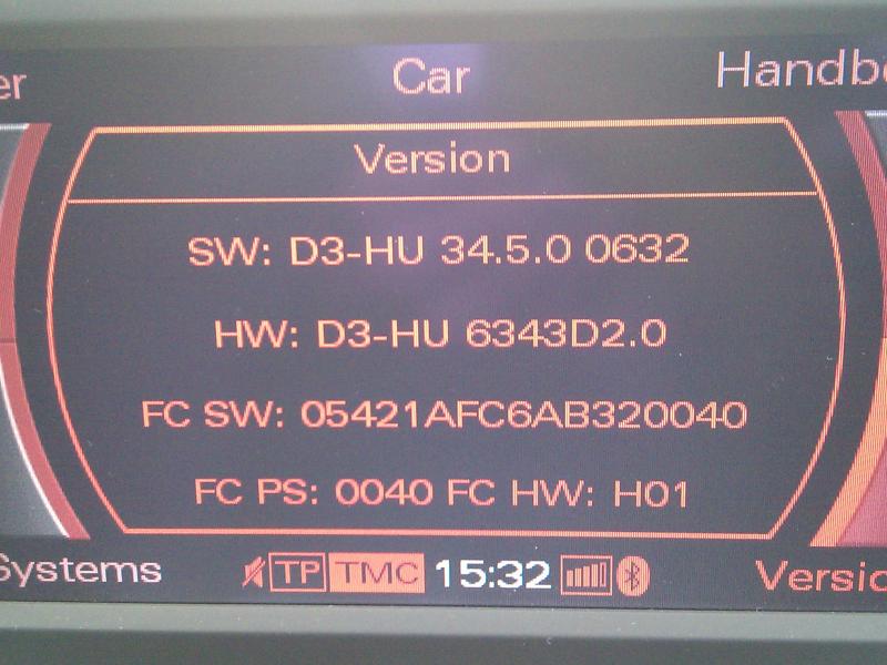

I have had a nosey on the system before trying to upgrade anything and would appreciate advice on how I fine what version is installed
The Sat Nav was easy popped the disk and its the 2007 disc part number T1000-11354
When I went into the MMI system section and pressed version.
It lists a stack of numbers what am looking for please
I can list them here if its of any use?
Thanks

Glyn,
You're looking for the first line.. will say something like 31.2.0 or similar.

The first line reads SW: D3 -HU28.6.00620
Do I need to get this udated before trying to get AMI fitted
Sorry to be thick but I hate making costly mistakes
Glyn
Old 19th March 2011, 06:49 PM
Yup.. you need an update. You're on 2860, AMI needs something like 3320, but you can go straight to 5570 with this version, you just need the update CDs (5 quid ish at the dealer, or various *ahem* internet repositories), possibly need the update menu turned on in VCDS too though.
You'll also get the 3D satnav view and a pile of updates to the Bose, etc to improve sound.

That's a very kind offer, can I take you up on it please. If you want to reach me I'm in the office Mon-Fri from about 10.30am on 01543 473 344, or PM of course. Just let me know what you need from my end.
I've bunged a pict off my MMI with version details, in case you need it
