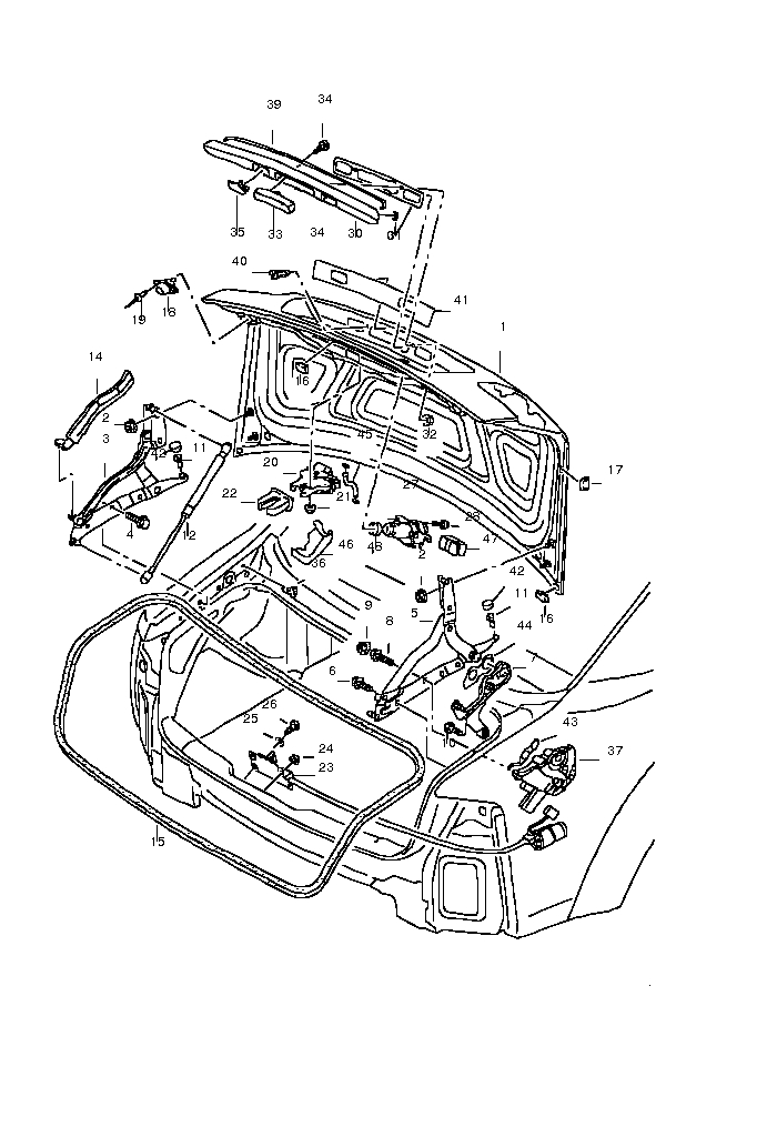

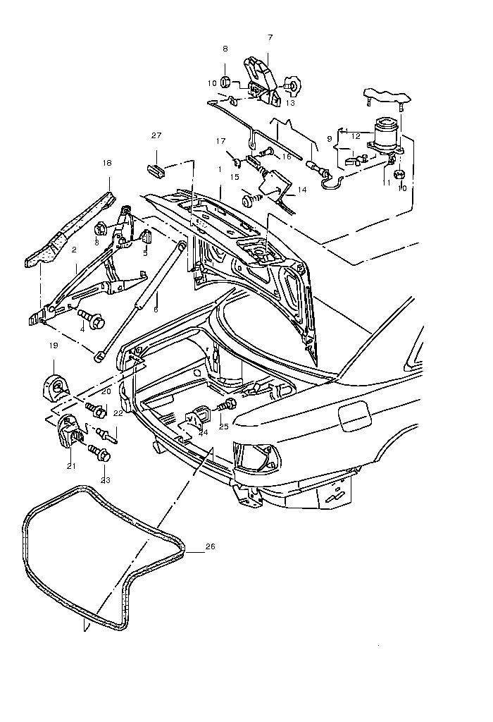

How different is the hinge? If I could get the OE D3 mechanism to work, that would be optimal. Electrically I can make it work fine, I'm just worried about hard attaching points, how different they are.
Old 16th August 2012, 11:47 PM
heres the D3 layout - item 37 is the motor and 3 and 5 are the hinges
and heres the D2 bootlid -

Try again now, I've uploaded and embedded the images this time

That works now. I can't get vagcat to open on any of my devices or machines. I'm not too sure why. Is the site down? Or are my freedoms to browse being impeded (wouldn't surprise me, but I don't dare turn this thread political).
Also, they appear similar enough I may be able to make it work. I'm going to pick up hinges at least, found a pair for only $45 (roughly 29 pounds). I can go from there methinks. I already know the latching mechanism will work.

I thought the hinges looked pretty similar too, would love to get an OEM solution for this on mine.
