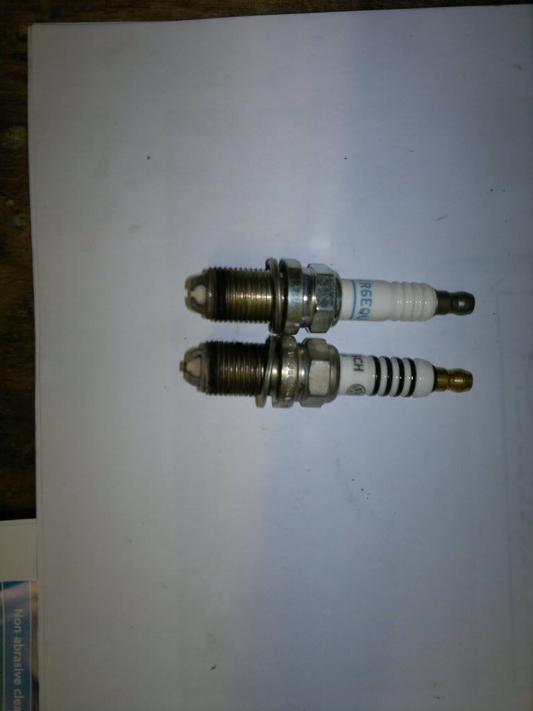

With the coil packs off, I swapped the plugs back to the genuine Audi ones that I put in when I first got the car. They did about 5k miles before I swapped them for some NGK's that were supposed to be better for lpg. I said that I was a bit suprised at the centre electrode on the NGK's and here's a photo with the NGK at the top and the Bosch at the bottom. You need to look closely but on the Bosch, you can see the centre electrode protrude from the ceramic insulator whereas on the NGK it's actually just inside the end of the ceramic. Looks very odd, I know the spark is big voltage but it nothing like the Bosch plug and I can't help thinking it shrouds the spark - I'd welcome views from anyone else who's fitted plugs like these, particularly if they run lpg.

My guess is the car didn't like the NGK plugs. I've had this problem a few times and when original plugs were used the problem was solved

My old car was LPG and I swapped to LPG specific plugs. Next time I took it in for it's LPG service the guy said to get them out and put the standards back in.

You'd think that the lpg would need a hotter plug but most people seem to be thinking it's a waste of time (and money).
