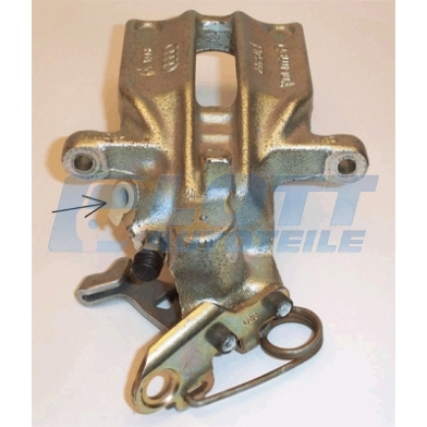

Lucas / Girling are the same thing mate,
I'm not sure about your rear calipers as they are slightly different that the PF type i have
But i wouldn't think there would be any differences for 3.7 or 4.2 on the back anyway.

All FL cars have the same numbers for rear calipers in ETKA
4D0 615 423 E - left
4D0 615 424 E - right
PF cars have different numbers and 2 options depending whether they have solid or vented rear disks.
  #30
Old 9th February 2012, 11:29 AM
Originally Posted by RanjA8 View Post
A while back I had rear brakes changed on a s6....anyhow the mechanic said rear calipers were same as those on vw...might be worth looking into that for comparison ie go to local vw scrappy and compare calipers to one on urs...I think it is worth looking into...Might save u some hassle...
In terms of control arms I think u got good price but for future reference allgermanparts are really good...
Those part numbers come up as only suitable for 1999-2003 A8 and A8Q in ETKA.
They might look the same to naked eye but be slightly different or maybe even physically same on outside but different diameter piston inside
