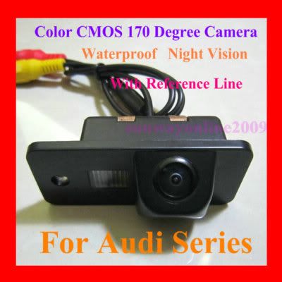

Ian, pleaseee fit me a rear view camera for my RNSE.
I've seen this really cool one on eBay that slots in where the numberplate goes so no drilling required. I could probably do it myself but it will be messy.
Make sure it will fit first, i bought one and though the dimensions are good externally , the bit which goes inside wouldnt fit , take your light cover of - and if you have a full rectangle it will fit, if it slopes away it wont
Old 1st April 2012, 10:34 AM
Might not fit guy, and you'd need to add the AV input.
Also, it would need to be manually selected in the Media input to see it unless you can spoof the system somehow.
