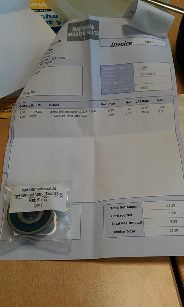

Old 3rd May 2012, 04:02 PM
Seems that size was specific for Bosch alternators and nothing else

The postman delivered
I just need a week when I'm not preparing for a concert!

I finally managed an hour free to get the alternator off and changed the bearing.
Now it's nice a quiet... Shame I've still got a whine from the front of the engine though.
I've ruled out the alternator and air-conditioning pump. Just the tensioner, roller and power steering pump to go.
It's not mega noisey but it's annoying.
