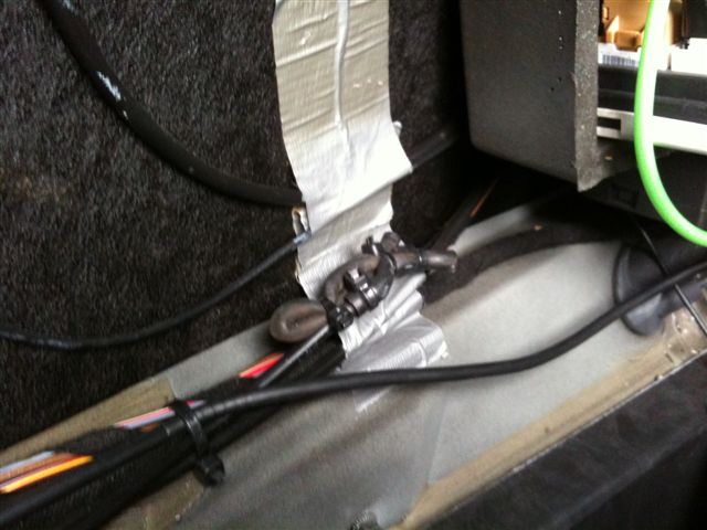

OK, back to the boot lock...
I've replaced the vacuum driven 'actuator' that applies the central locking to the boot, but to no avail. The actuator works fine if you blow/suck (don't you mucky lot start again!) but nothing happens when the central locking is activated. BTW, there are no electrical connections here and just one pipe connection.
So, I went on the hunt to trace the pipe back the the central locking pump. First mystery was that the pipe from the boot lock disappears into a wiring loom behind the pump (photo 224 - the black tube at the bottom of the photo), so I have no idea where it goes from there.
Second mystery was a tied up pipe (see photos 225 and 226). There's been a rubber pipe added to the harder plasic pipe which has then been folded over and cable tied, apparently to seal it. But this isn't the pipe that goes to the boot lock. And I couldn't find where this might have originally been connected. But someone has clearly been here before, as the pump wasn't in the right way around (it should be upright with the wiring at the top and the 2 green pipes facing the rear)!
So the boot lock still doesn't work fully!

Do you get any suction on the pipe when you activate the locking?
  #29
Old 29th September 2012, 04:07 PM
So, simple question, when you activate the central locking does the pin behind the fuel flap move in and out, thus unlocking/locking the flap?
I'd guess from the fact that the red emergency release moves that it does.
The would show that the vacuum pipe is intact and working up to that point; I believe that then leads on to the boot via the grommets (that are giving me and Mannyo some grief) in the offside wing and boot near the boot lid hinge mechanism.
All that tied up plumbing suggests someone has had a problem and sealed up the end before it gets to the boot lid. I would imagine it can be fixed by splicing in a new section (with suitable reinforcement) unless the leak is in a difficult area. A bit of sucking and blowing on opened-up pipe ends would probably trace that.

Back over on the "plumbing" side as I was in the boot anyway I had a quick look at mine just through the access panels and the plumbing to the boot lid after entering the body through the grommet turns forwards and disappears behind the fuse carrier. How it then connects to the pump and/or plumbing to the fuel flap release I can't see.
