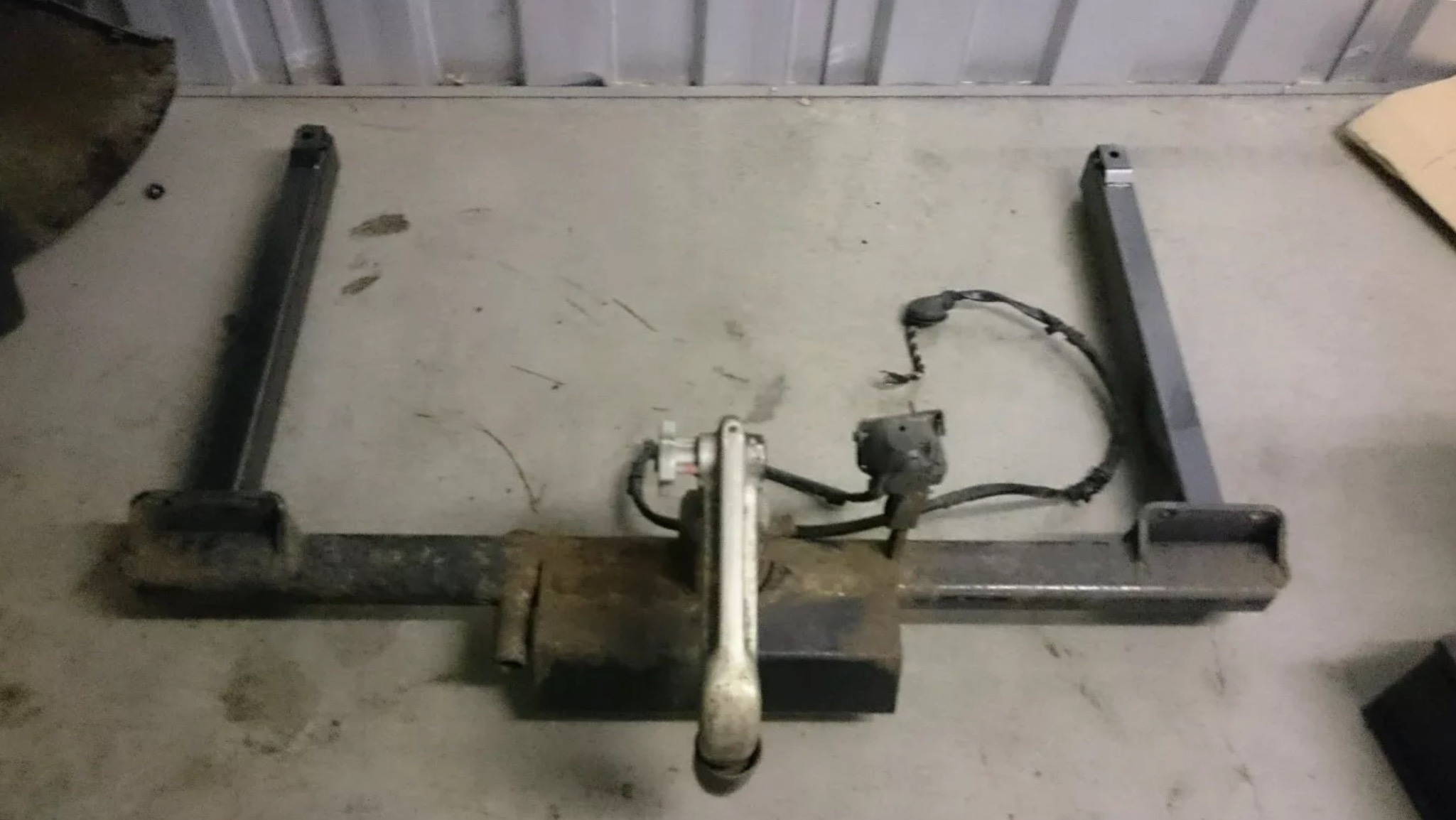

To revive an old thread...
Hi. Help!
I'm still after a towbar for my D3. I've found one second hand, but the seller assures me this all that is needed, see pic, and all A8s are wired to accept this.
I'm of the opinion that a loom/controller/etc is needed to interface between the Towbar and the car.
I'm utterly confused at this point, but really want a towbar, and can't justify the cost of a new one.
Thanks. John.

You can fit that tow bar and use standard single or twin electric sockets. All you need to do then is put the car in towing mode manually. I did this with mine using an original Audi tow bar and it all works perfectly. It's also handy having the battery in the boot for the wiring. You will need a 7 way bypass relay for the lights which will prevent any issues with the cars lighting system but it's a doddle to fit.

Do you have a part number for the swan neck towbar detachable bit? I've just bought the towbar frame (sans electrics and swan neck towbar).
I'm intending to get the bits together as and when, and get around to fitting it in the spring/summer/when I have time and it's not cold,.. or raining...
