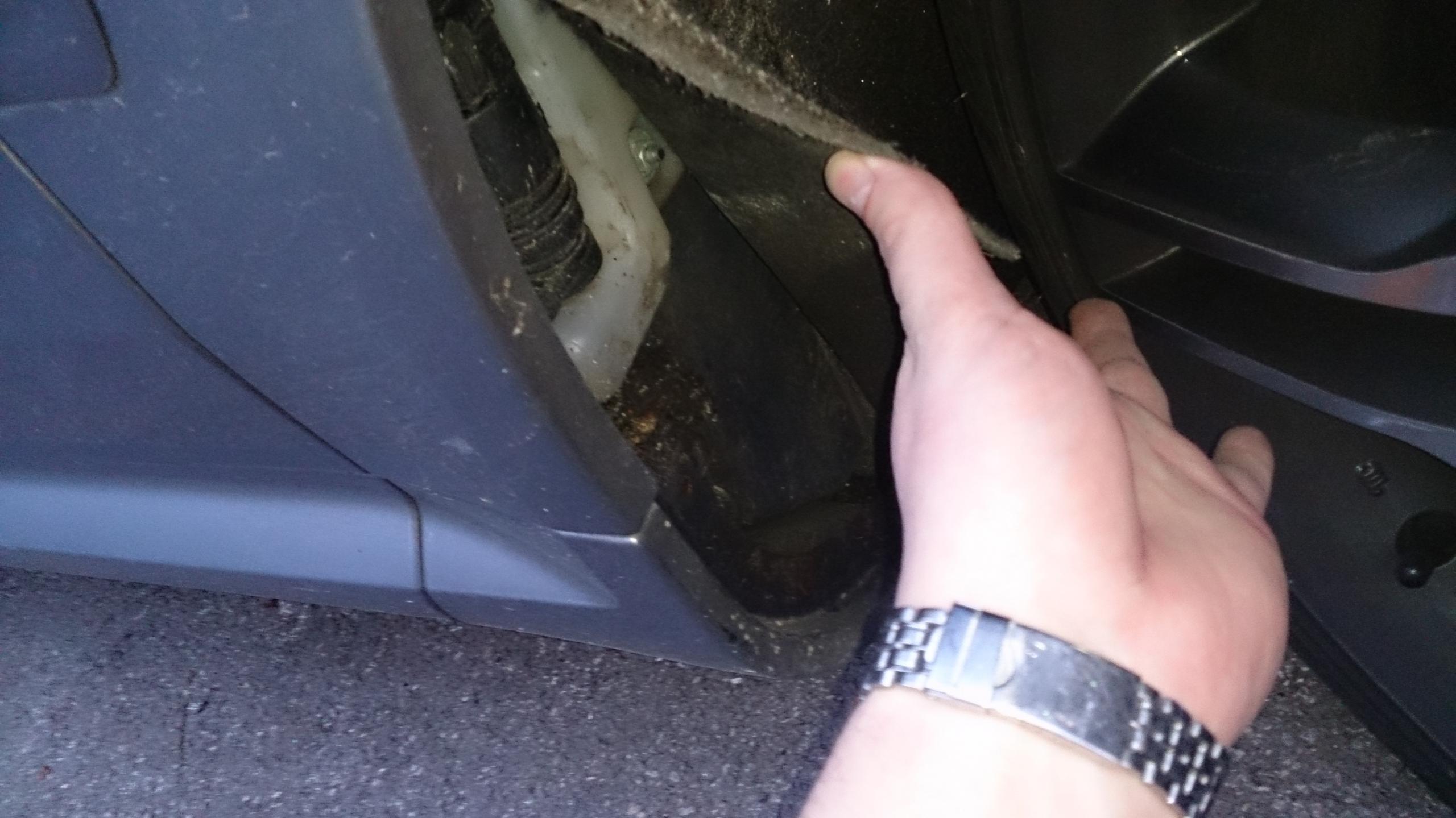

Just done it, picture will follow in next 5min, let me just edit them, it takes 5min to do it and put the lining back is as easy as making a cup of tea, you have to pull only a part of it.

All you need is a TORX but certain flat head screwdriver will do the job as well
Just pull the lining, impossible to damage anything
Unplug the connector
Pull the pump out a little so you can have enough room to unclip the hose
If your bottle is full and water water is not gashing out at this stage then you know this will fix your issue.
Put pump on side as now you will have to pull a little rubber ring which is a filter and as soon you take it out water will gash out so keep the connector out of the way.
Let it drain and crack on with the rubber ring/filter
Remember, legionnaire spreads in the form of spray or steam.
You water company delivers even up to 4 bacteria of legionnaire a day, but its only dangerous in situations mentioned above. survives only in the range of 20-60 degrees
Clean the plastic mesh/filter, put it back, clip the hose back, insert the pump where it was, push the connector back on until clips, bend lining so the edge goes first behind the panel and it will all slide in nicely, 3 screws back on and you are done

I have been unable to get on the forums for a while, just forgot my password and so on but today managed it. Just wanted to say that your step-by-step guide was invaluable and that it solved the problem instantly.
I'm not mechanically minded or anything, but the guide was so simple even I could do it. So many many many thanks!
