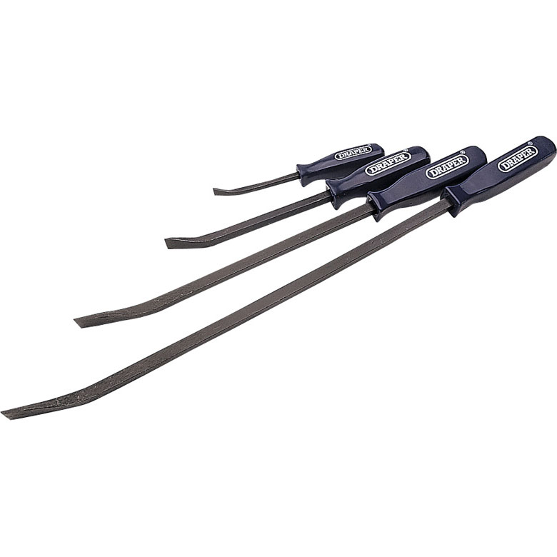

They normally have a wire clip around them at the top and while compressed i.e. fitted to the car you'll not have much room to move the rubber anywhere. MOT tester would put a bar (something like this)
between the arm and the part the arm locates into and will apply pressure so see how much it moves, it is then his discretion as to how much is excessive movement.
So how about that dry ball joint which you guys suspect, tools will determine any movement, but that weird noise isn't cause by worn out ball joint but dry ball joint or I'm just getting confused here??
Would excessive movement caused this sound but ONLY when warmed up, remember guys, it happens only after 40min of driving when everything is up to the temp, gets worst around city when most of driving is at low speeds or in standstill in traffic so all the heat from underneath the engine but no much cooling.
