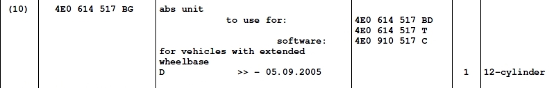

Well the only one with 4E0 910 517 C software is this one but it suggests it's for LWB W12
Edit: Or maybe it's meant LWB up to 05/09/2005 and W12
This one is for 12cylinder only as per attached picture and lets stick to 8cylinder Petrol engines as this is what Guy has in his Big Black Stuff correct

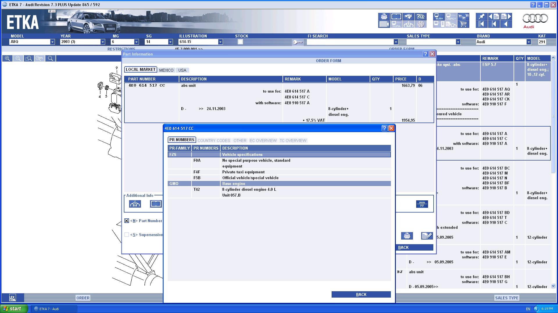

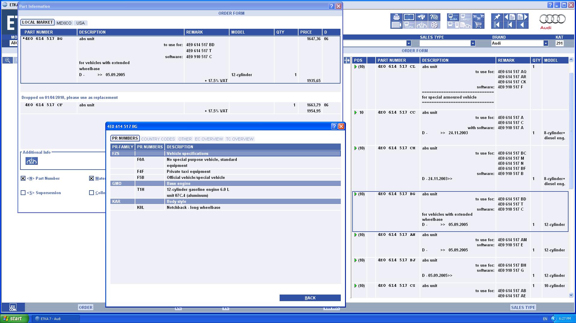

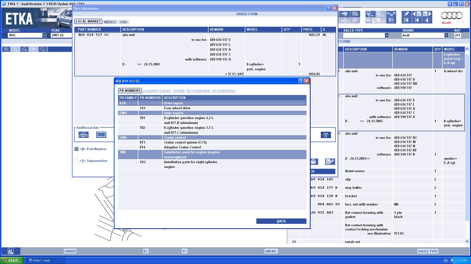

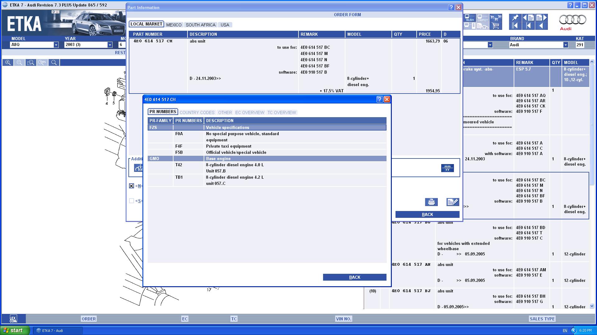

See this (additional info for each module)
Looks like we need to focus on picture 1 only, poss. 2nd as well.
Also additional info gives you the PR Family codes and actual PR numbers, I think they need to be matched with your PR numbers??
This is were my knowledge ends, so I wont be pretending I know exactly what is going on, but I think by matching the PR number we can get correct module for your car, that is based on my common sense which usually is OK

Old 21st June 2014, 06:10 PM
Hold on, I'm getting confused as well, but we will get there.
Don't look at H44, its irrelevant, can't even find what that means, could be a batch number or something like that.
All we need to focus on is 4E0 614 517 and then 1 or 2 letters at the end
4E0 910 517 is the software version.
From my observations you need 4E0 614 517 CC, now I just need to prove it

Old 21st June 2014, 06:12 PM
BD is clearly for 12cylinders engines only (4E0 614 517 BG)
  #29
Old 21st June 2014, 06:17 PM
Elimination process
Application of VW 4E0 614 517 BG
Make Modle Engine CC KW cylinder Type Year
AUDI A8 6.0 W12 quattro 5998 331 12 Saloon 2003-2010
  #30

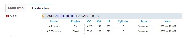

Old 21st June 2014, 06:22 PM
Look at 4e0 614 517 C, which is apparently original/older unit which was replaced by 4e0 614 517 CC
xxx CC is for 4.2 petrol engines and 4.0 diesels (see attached)
