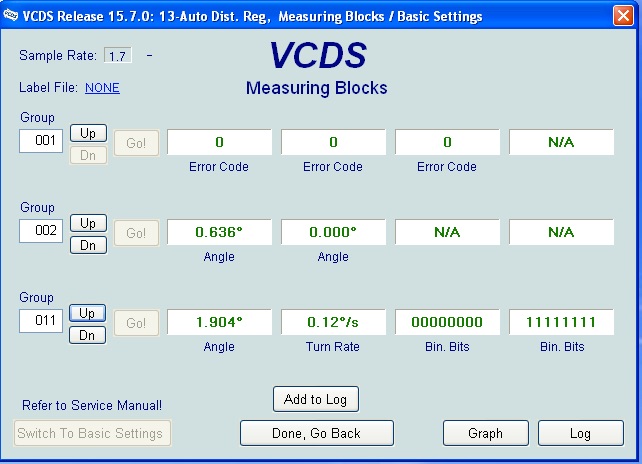

After the retrofit most of the driving had been round town but yesterday I went to Norwich to meet with Matt for breakfast so had a 60 mile round trip, the ACC performed well apart from the slight bias that was noticeable during sweeping bends.
So I was surprised to get readings like these.
I am reluctant to reset and think I will let it play out for a while yet and see what happens to it as we don't know know the criteria for setting the values.

This morning I added 1/2 a turn anticlockwise to the horizontal adjustment screw, and reset the basic settings. Having driven 150 miles since I now have different readings. I'll not post another screen shot, but the channel values recorded as follows:
Channel 2 first block -0.083 degrees
Channel 11 first block: -2.016 degrees
Observations when using ACC, it now at least seems to see cars in front but needs more adjustment I think.
From this I think we can deduce that channel 11 is horizontal alignment and channel 2 is vertical, and to get from negative figures to towards zero on the horizontal seems to need anticlockwise on the allen key.

Ok guys I asked over on Ross-Tech forums about the measuring blocks for the radar and a helpful chap posted this link that shows what each reading is.
Sorry for the misleading info before.

Interesting as that would mean mine was pretty close at the start and should have worked, but it quiet clearly is miles out.
I guess adjusting the horizontal is correcting the steering offset in block 11 position 1.
I know my wheel alignment is spot on, i've had it checked twice in the last 12 months on a hunter 4WA rig and its never required adjusting.
Manny
