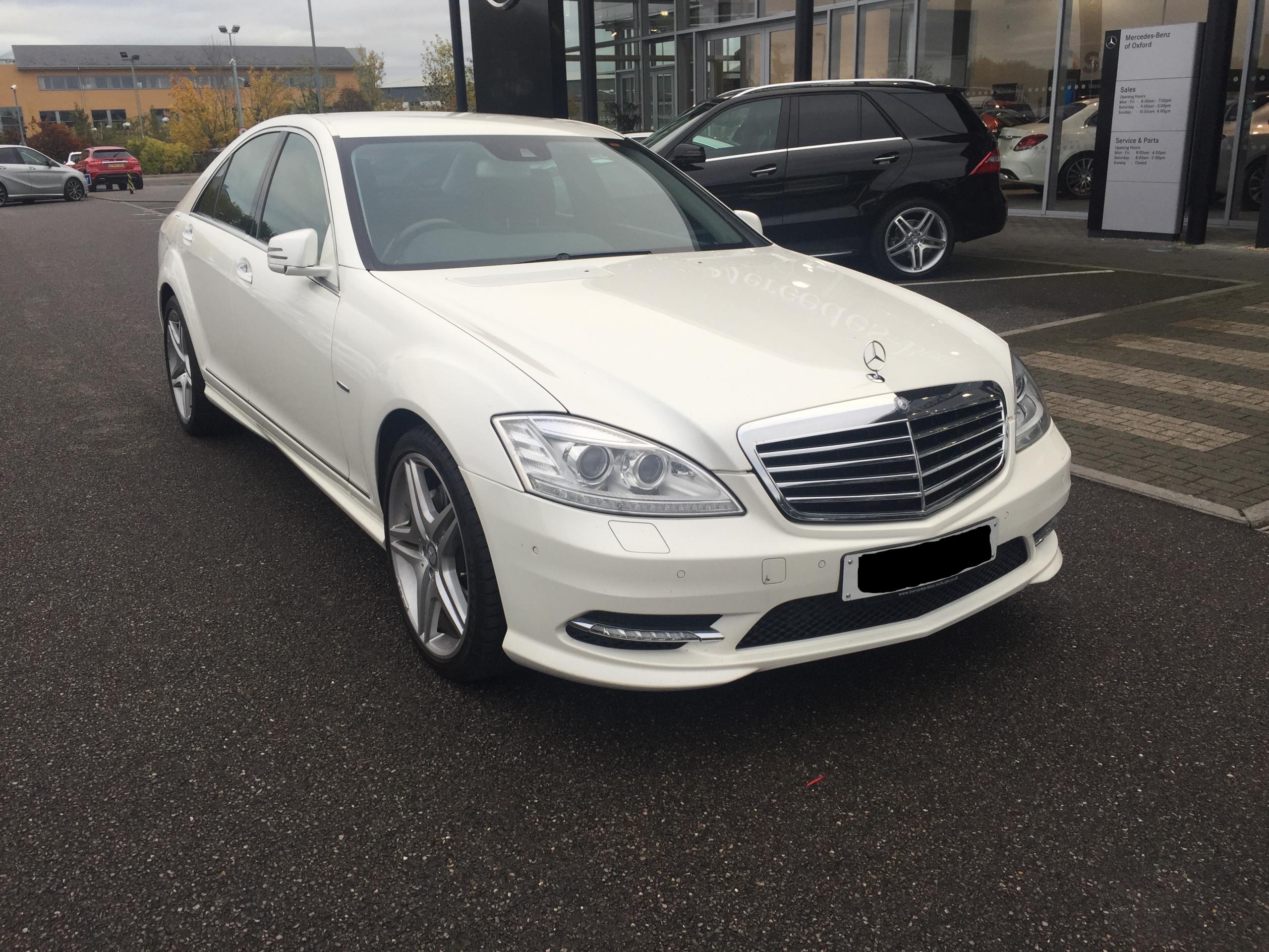

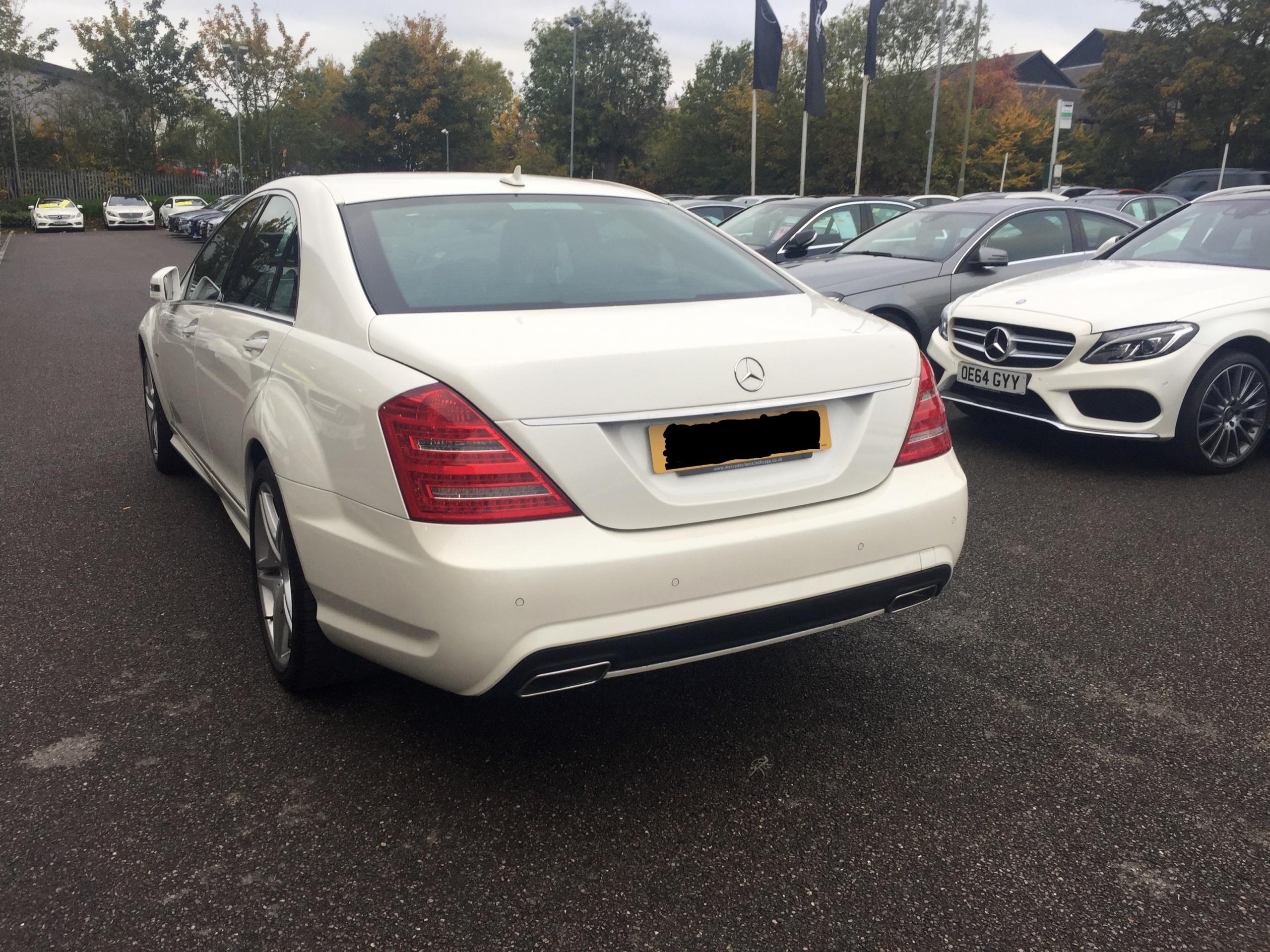

Well, I'm not too much of a fan of the brand new-new shape, because the last one was so aggressive. So I've purchased a 2012 W221 S-Class, AMG body kit, 50k miles... I get to pick it up after they complete their pre-delivery inspection, so likely Monday or Tuesday!
Some pics I took when I was there are attached here if you're interested... worth noting I took this particular one as 1) I've never had a white car, and this is a designo paint, and 2) it has a B&O sound system which quite literally ****s on the Bose of the D3 A8 I have!
Drive wise it's nice and comfortable, just kind of glides over everything. It's a strange one to describe, but it is nice, and you sit in a commanding position with a lovely long bonnet ahead of you. Space is aplenty and I just love it from every angle.
Anyway, aside from that basic overview, I have only really gone on a long test drive and played with it at the garage... so can't give anymore detail than what I have so far... once I have it here, I'll do something more detailed for you.
(Just blocked out the number plate in the pics) ... sorry they're so dull, wasn't exactly a sunny day when i took the pics...

I found the W221 cramped and claustrophobic, a bit like being stuck in a Mini with 5 other people. It's a big car but the interior space is pathetic IMO

Seriously?! I can only assume you went from an LWB A8 as a comparison then because by all measures the SWB W221 is far larger inside than the SWB A8 !
