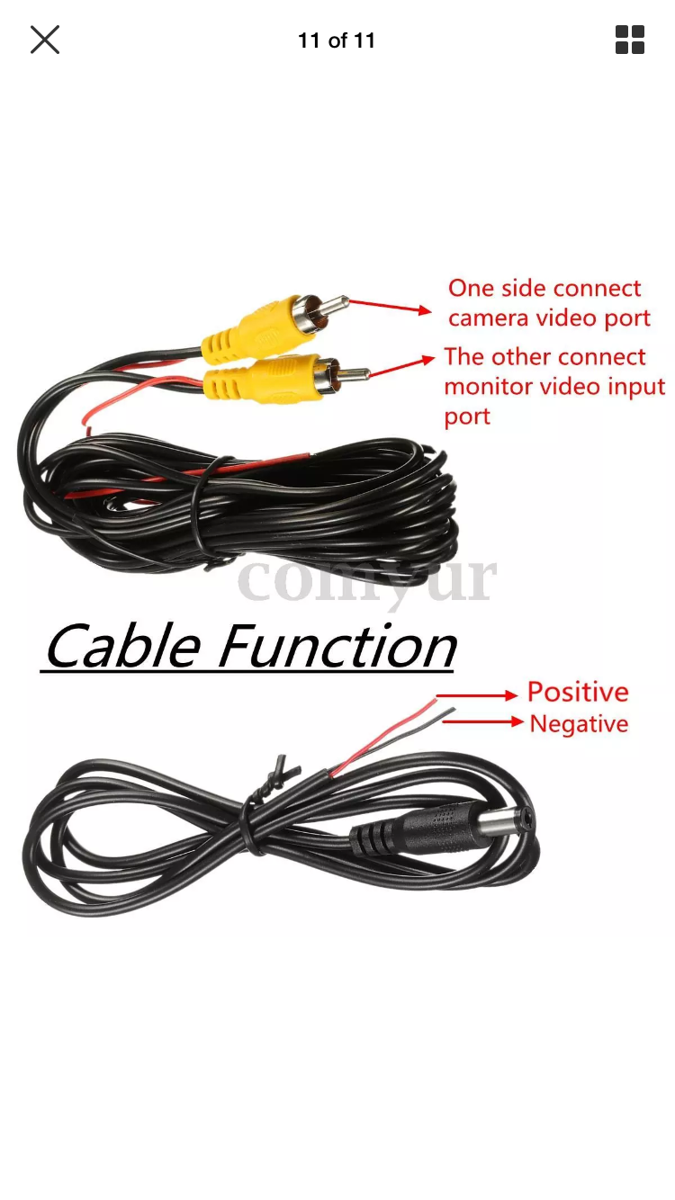

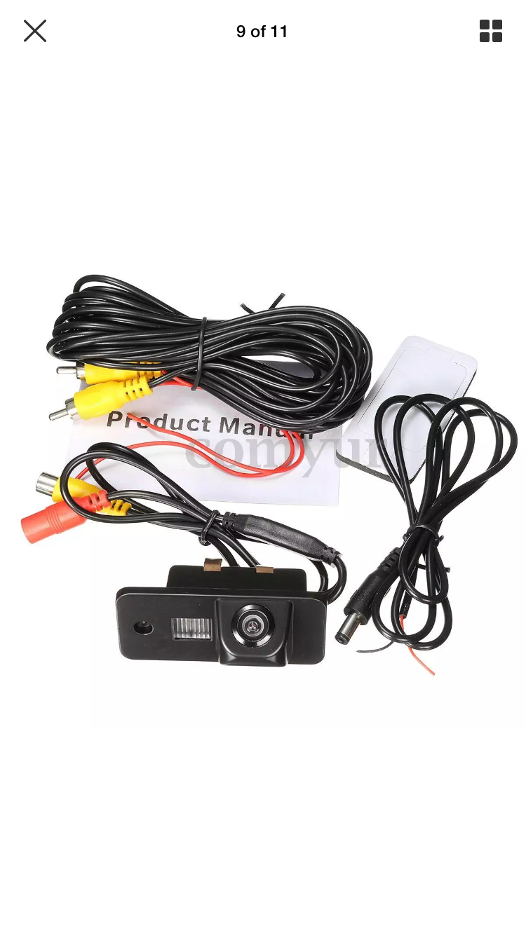

Just to add a bit more info, the wire from the camera to the interface is sort of phono to phono with red wire pigtales, if that makes sense,... I'm not entirely sure what the purpose of the red wires is.... I don't have a wiring diagram as such, just the 'manual'.
Hopefully the attached images will explain what I'm going on about.

The red wire is to send power down(+12v) if you need it. Either way, as required.
In my reversing camera install I take the +12v locally from the reversing light to power the camera AND feed it down the cable to power the interface box (which is in the cabin at the front of the car). The box is earthed using a convenient earth point - there are loads.
BUT mine is a D2 and interfacing to an RNS-D so lots of interface differences. Also I can live without the 3 different power feeds as I have to manually switch the display to TV (= camera) whatever power setup exists.

Cheers HP. Having thought a bit more, and read a bit more I've realised they're trigger wires. I'm now wondering if the MMI will resort to normal after the car is driven above a certain speed... Like when the parking distance control switches off. I'll have another bash when I've more time/light/patience.
Cheers Chaps

HP, thanks for your input, you are correct about the red tails.
Because I have used a video transmit/receive between the camera and the add on box I did not run a video cable front to rear, as an afterthought I do think that I managed to overcomplicate it, but it works absolutely hands free for me. But I used the more expensive x-carlink.
