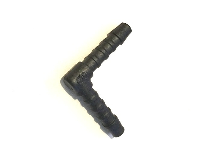

Minor problem: the vent tube wasn't connected to the old battery (no evidence of overflow thankfully) and can't be connected to the new one.
It's missing an adapter on the end that plugs into the vent hole on the battery.
Anyone know where they can be sourced, are they a standard VAG part or eBay item?
I found an easy solution, using a connector piece for windscreen washer tubing.
Rummaging around in my "bit bucket" I found some washer plumbing from my old Ford Focus. The 90-degree connector shown below was a perfect fit into the battery vent hole and vent tube.

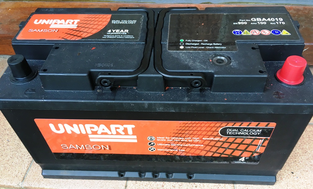

the old battery
As Adrian pointed out, the condition indicator was showing discharged even though it was still working (to an extent).
What uses can such a chunky battery be put to, given it's still working reasonably well, just not up to working well in an S8?
I think I may have found it a home.
Mate of mine recently acquired a 3.6 V8 and it has a "tiny" (and at least 15 years old) battery in it, though it does amazingly start the engine!
It's currently being repaired/fettled and he thinks this will fit and be better (for now) than what he has. And it will only ever be used occasionally so will be fully recharged before use.
So which 3.6 V8 you ask and from which era?
And the answer is (I'm telling you this time Ian!). Ford. 1950. It's a Ford V8 Pilot. Wonderful old beast and probably fairly low compression so not too difficult to turn over.
(And it does also have a starting handle, showing significant wear from being used)
