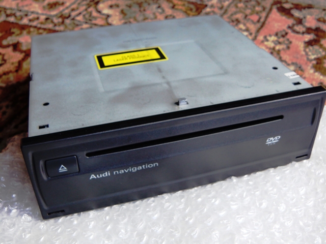

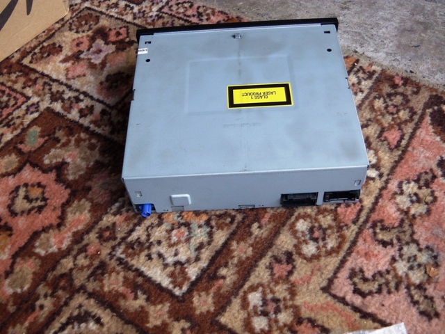

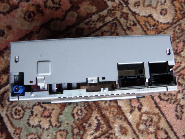

Locate the nav player
Best to take the nav out to get to the cables.

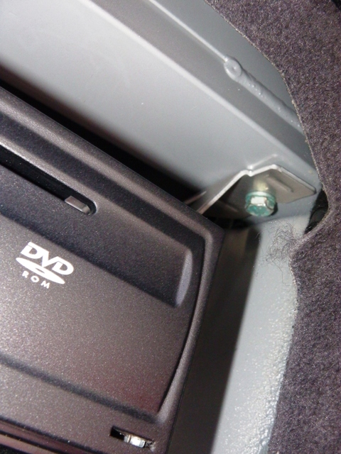

Slightly loosen this 10mm bolt. Nav carrier slides into it:
Take this 10mm nut off and remove the nav carrier:

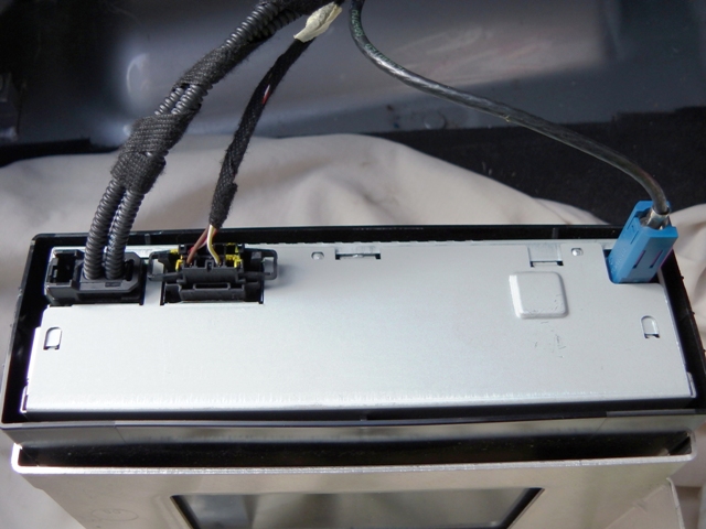

Remove the cables:
I didn't have the fancy radio extraction tools, so just used a pair of tweezers to shove in the slots and pull the nav out of the carrier just enough to see the red retaining spring thing:

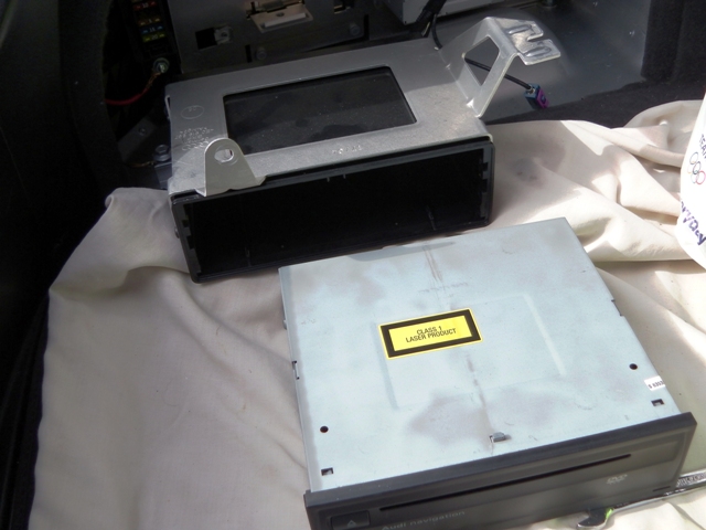

With a biggish flat screwy, push the red spring in on both sides and pull the nav all the way out of the carrier:
With the same flat screwy, place it in the slot and twist the nav case lid up. Same with the other slot. Comes up easy enough:

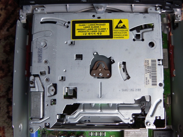

Remove the lid:

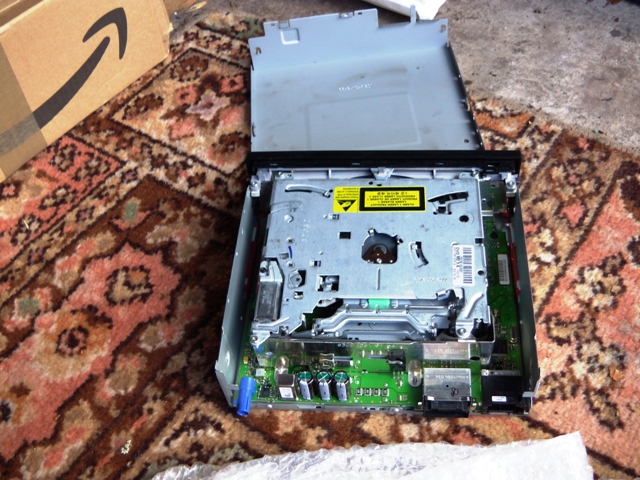

Remove 4 little screws with a tiny star head bit, T8 I think. One on each corner:

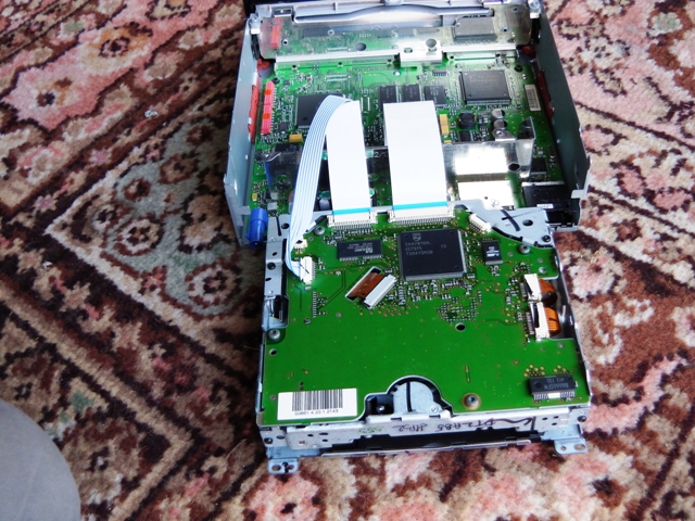

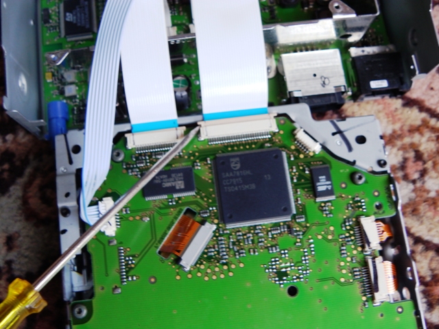

Lift the mechanism out and flip it over, careful with the ribbons:

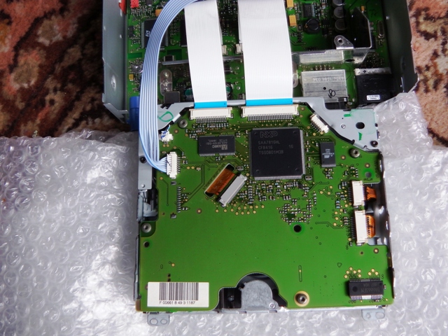

Remove the 3 ribbons:
Line up the new mechanism:
Insert the 3 ribbons back in the same place:
Flip the mechanism back over and fit it back in the nav case, careful with the ribbons again. Put the 4 little screws back, then fit the lid back on:
Slide the nav back in the carrier. Reconnect the cables, then secure the nav player in it's cosy little home.

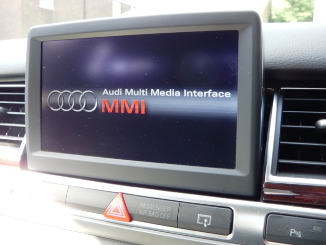

Okaaay, time to test it!

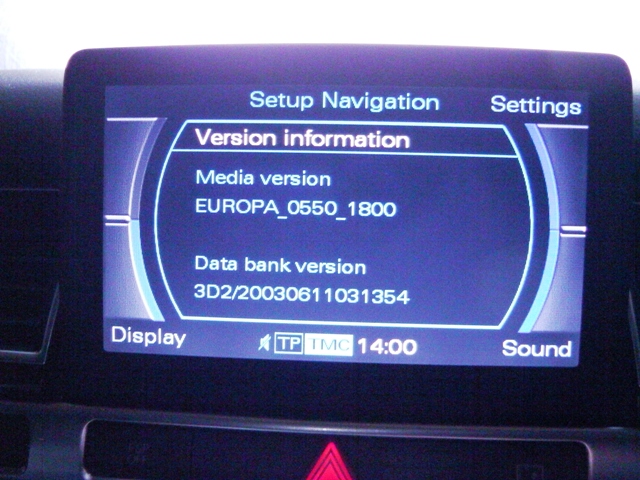

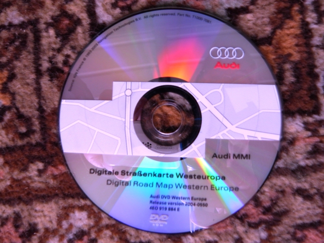

Latest (final release for MMI 2G), DVD in the slot:
Nooooooooooo!
Right, try the old 2004 DVD:
Well this works ok:
So, I tried the 2018 DVD again, but still got the same 'check nav DVD' message on the screen. I kept changing the old and new DVD's over until the mechanism eventually recognised the 2018 DVD and then started loading up!:
At last, she lives!
There are some scratches on the DVD, maybe this had something to do with it, dunno?
