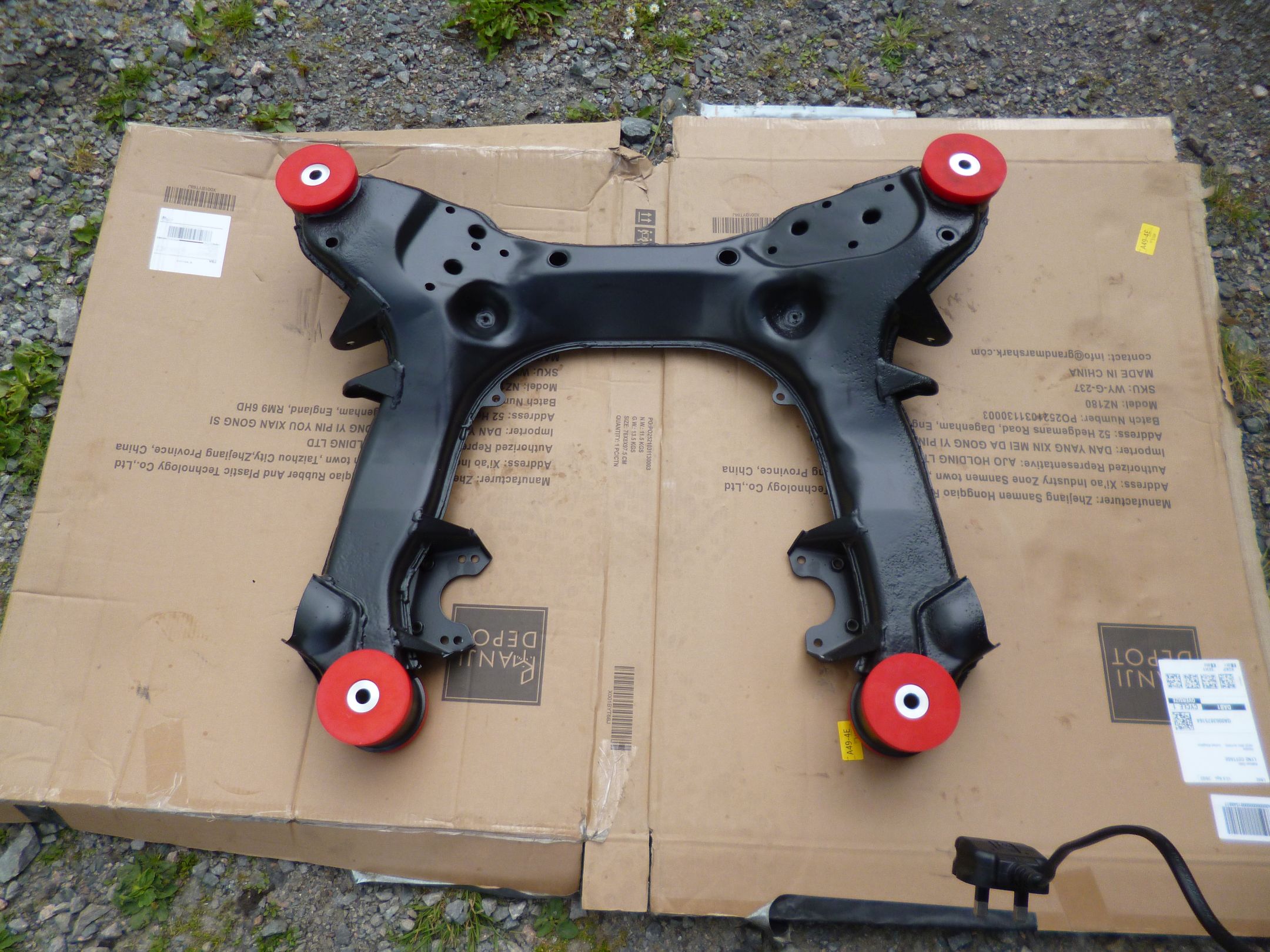

Progress on this has continued to be slow but steady… long gone are the days when I got to spend all my evenings and weekends playing with old cars!
The front subframe is now off and away to get blasted and painted (along with the front springs). It cleaned up well with the needle gun and looks solid enough, but we will see if the blasting picks up any issues.

I have also now got a full set of Bilstein B6s, and the brakes are finally on their way back from Bigg Red. I also got that last bush that I wrecked replaced and pressed into the upper link, so these are all ready to go.
So I am now looking at the final(ish) items I still need to get for the rebuild. There are a few mounts/bushes and bolts which I am unsure whether or not are worth replacing, and thought I would see if anyone had any thoughts on this 😊 (for reference, the car has about 123K on it, and I assume these are all still original bits).
• Top mounts and ‘rubber buffers’ for both the front and rear shocks. These all seem in pretty good condition, but I obviously don’t have new ones to compare with. Are these typically worth replacing? Front mounts seem pretty cheap and available, but rears might be hard to get/expensive? The buffers look fairly cheap.
• Engine and gearbox mounts. How do you know if these need replaced? They look intact, but are reasonably ‘flexible’. Do they typically ‘go’? Availability seems to be questionable.
• Subframe bolts – do people typically use new ones when refitting? Are these stretch bolts? An online search suggests they are not particularly available, but I have not spoken with Audi/TPS yet.
I have also been wondering if there is anything else that I should be looking at while the subframe and front suspension is all out? I am changing both the output seals as they are both leaking (the left side badly). Is there any known issues that are worth addressing?
Thnaks, and sorry for all the questions!

Front top mounts are cheap and available from Febi. Rears are NLA as far as I know.
Engine and gearbox mounts are NLA. They settle slightly but rarely fail.
Subframe bolts get reused. They are technically stretch bolts (150Nm + 90) and the manual says to replace them but I never have. They're used on the D3 so should still be available if you do want to replace them. N 90711602

the subframe bolts can be reused, be sure you thread them in properly when you put them in as some people have been known to cross thread or strip them

The left output flange will also need a replacement bearing 6007C3 and a square-section o-ring 01V409133.

Thanks for that – very helpful as always! I already have the o-ring on order, but I had not noted the requirement for the bearing. I now have that on order too – thanks for the link.
I have also ordered the front top mounts (as you say, they are pretty cheap), but will reuse everything else.

The blasting of the front subframe revealed no further issues and it looked great all newly painted with the new bushes. I got the front springs blasted and painted at the same time and rebuilt the struts with the new Bilstein dampers (but forgot to take pics).

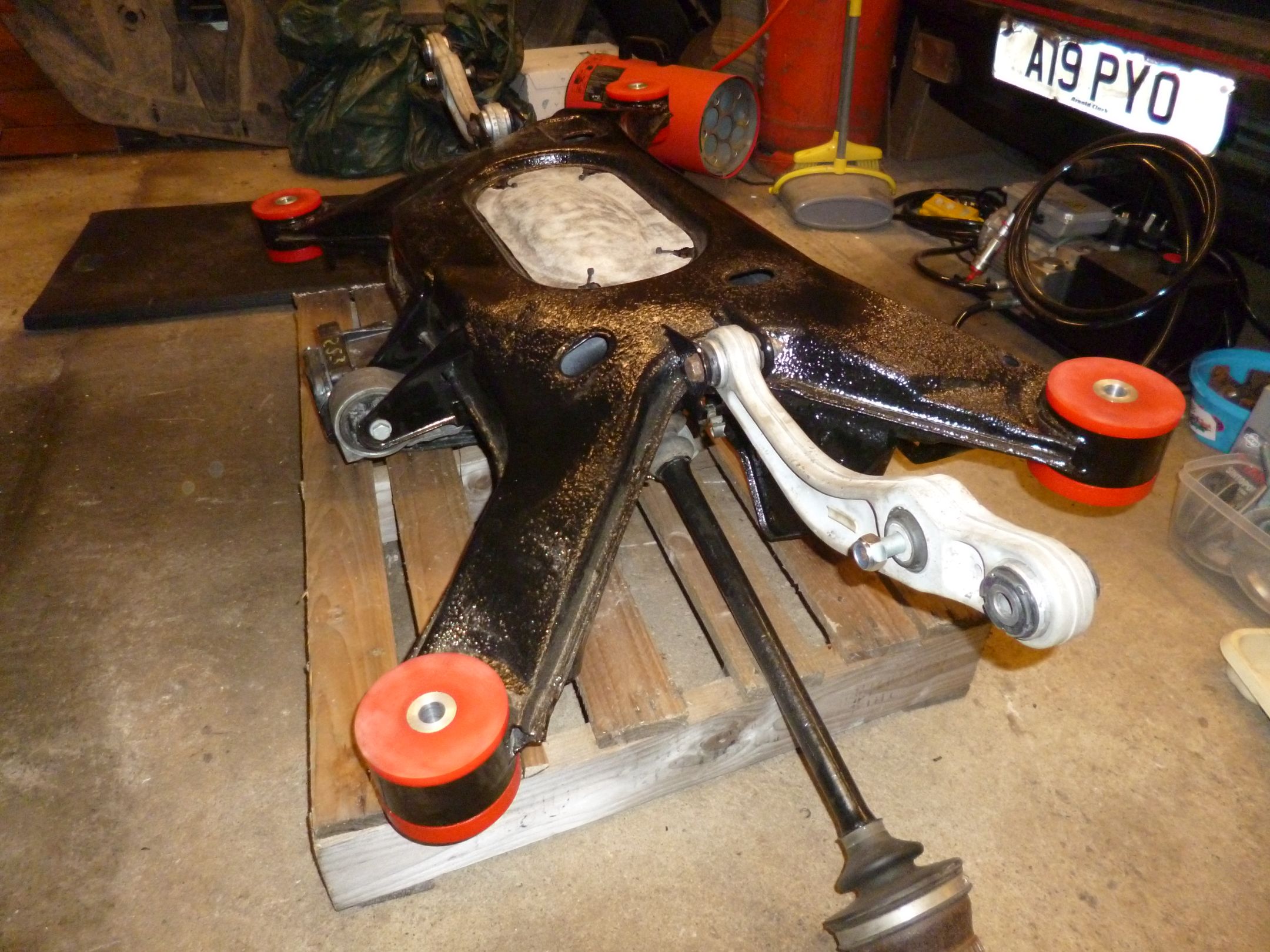

The front subframe went back on first while I waited for the final bits for the rear (thanks for these MJ!), and then it was its turn. I left most of the bits to be fitted once it was installed on the car, as I had to lift it up with a jack while balancing it and getting the bolts in, and I though the less weigh the better... MJ made some 3D printed alignment spacers to fit the polybush holes (which are smaller than the original ones) which worked a treat for aligning it.

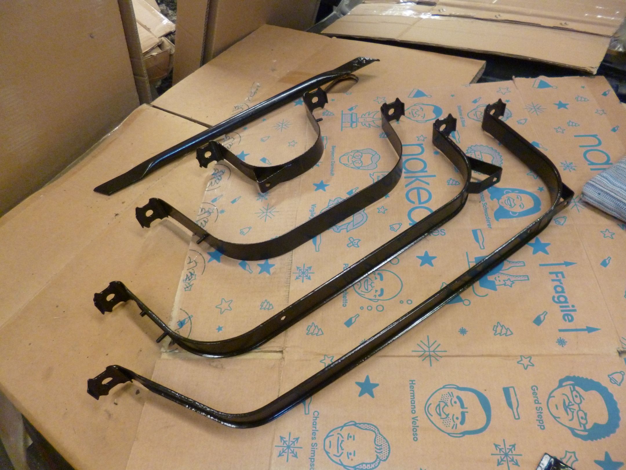

Next it was onto removing all the fuel tank straps and blasting and painting them, along with the exhaust and handbrake brackets. Following MJ’s notes in one of her last WITWs, the nuts for the straps came off with no problem, so thanks for that!

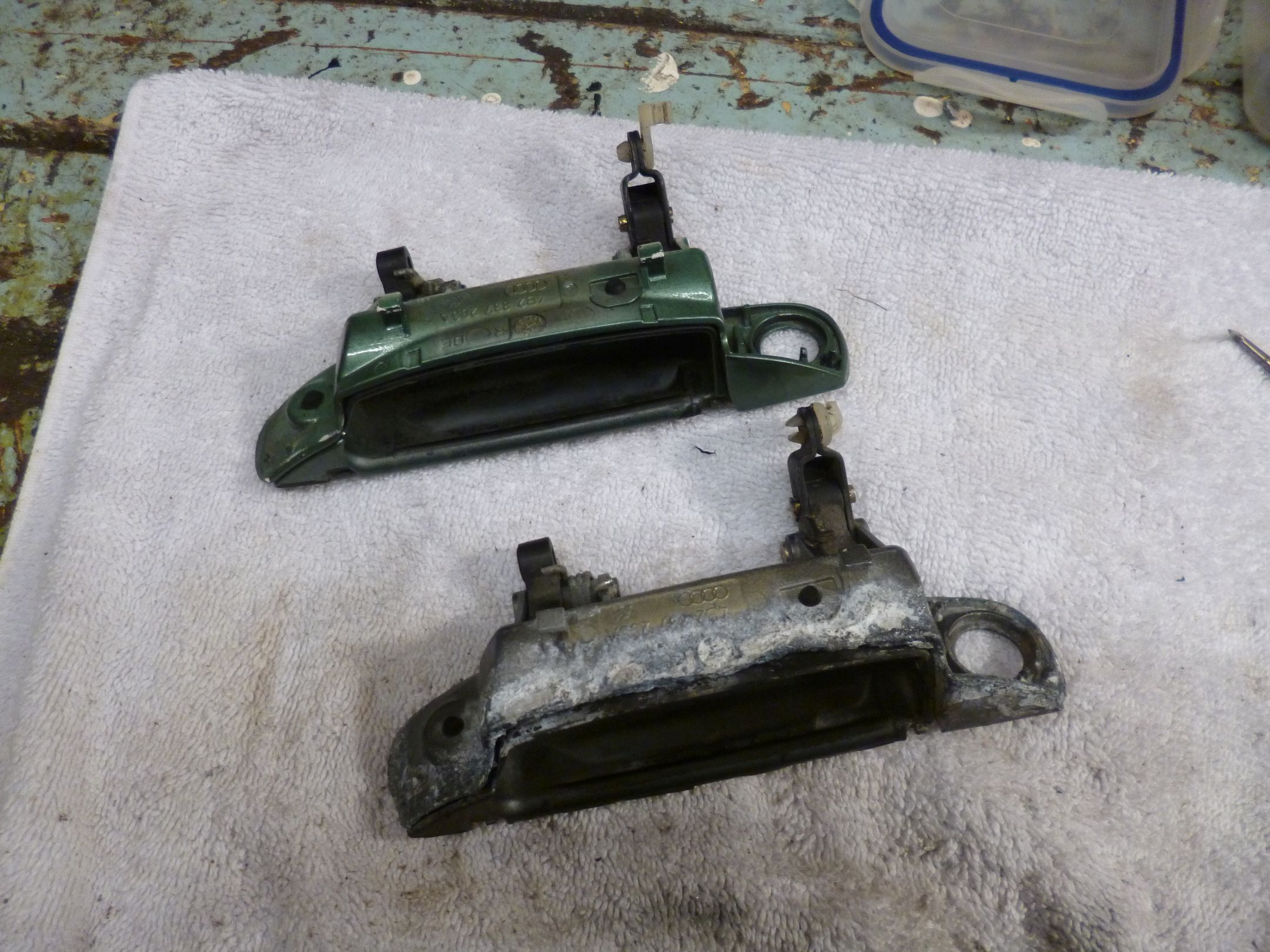

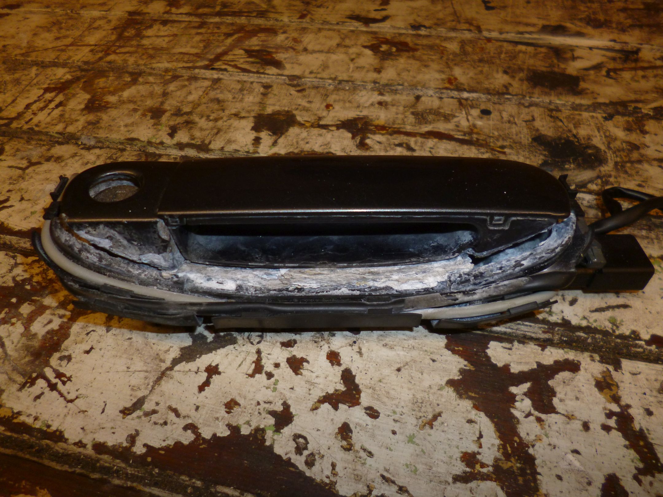

The next big job was a weird one. The driver’s door handle has always been corroded around the handle, but it was starting to get really bad, with the handle feeling a bit loose and stains running down the door…
I got a replacement frame from Prestige in the correct colour (which thankfully matches very well) and went about stripping down the door, which as has been reported elsewhere, is a fairly major task. When it came to removing the handle, once everything was disconnected it just pushed through the frame in one piece – no need to separate the parts!

I had assumed it was just the frame that was corroded, but it turned out that the middle part of the handle was also in very bad shape, so it was back to Prestige for a handle, which fortunately they had. It was green, so I got my dad to spray the visible bits (mainly just the lock cover) to Dolphin Grey.
