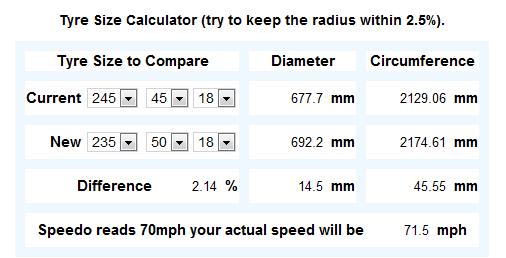

Thanks. I'd already looked at Camskill and everything was out of stock.
Missed those Toyos somehow, I think 235/50 is very close to 245/45 in overall diameter so wouldn't be a problem.
should be ok -
Name:	tyre calc 1.jpg
