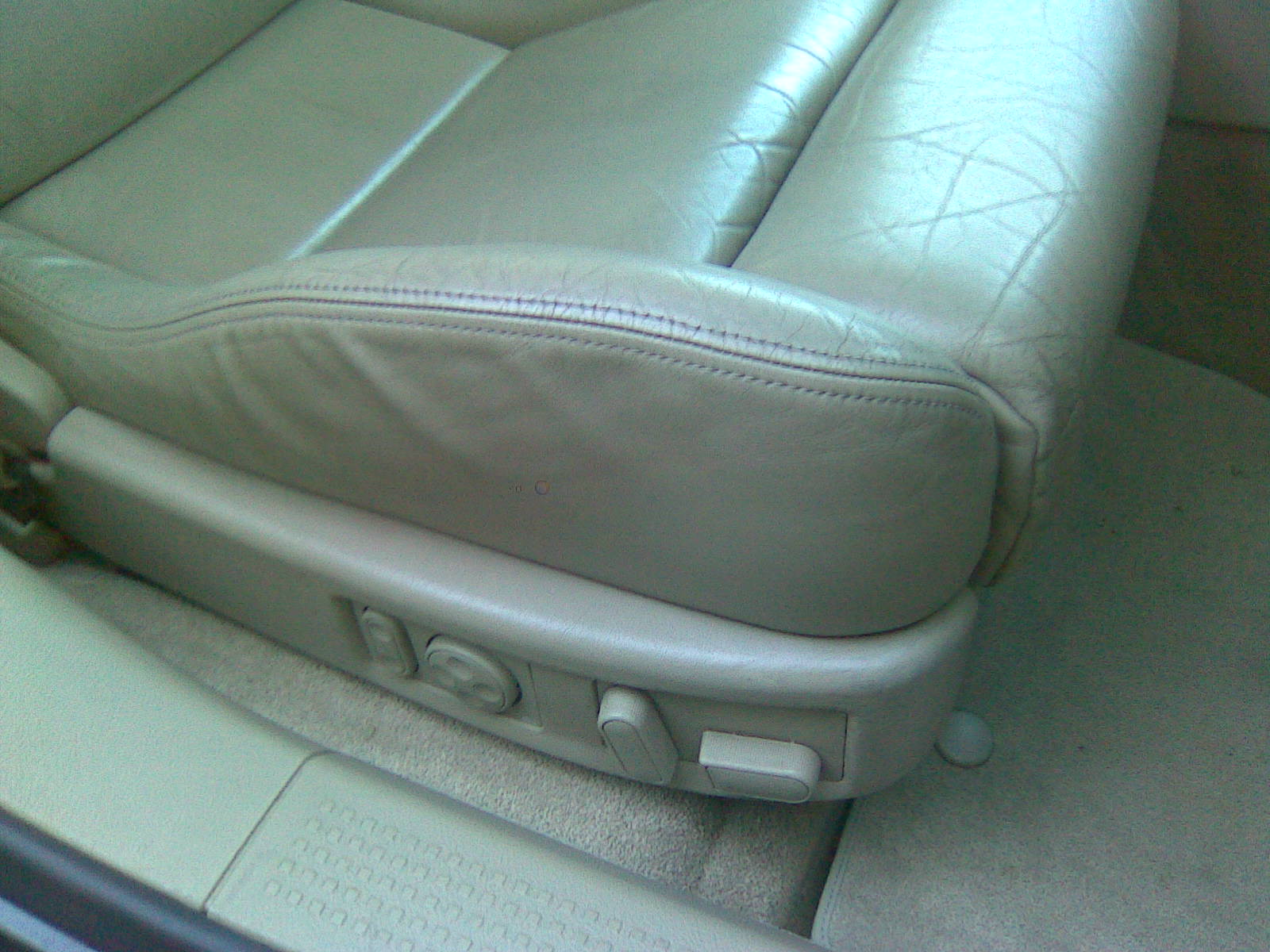

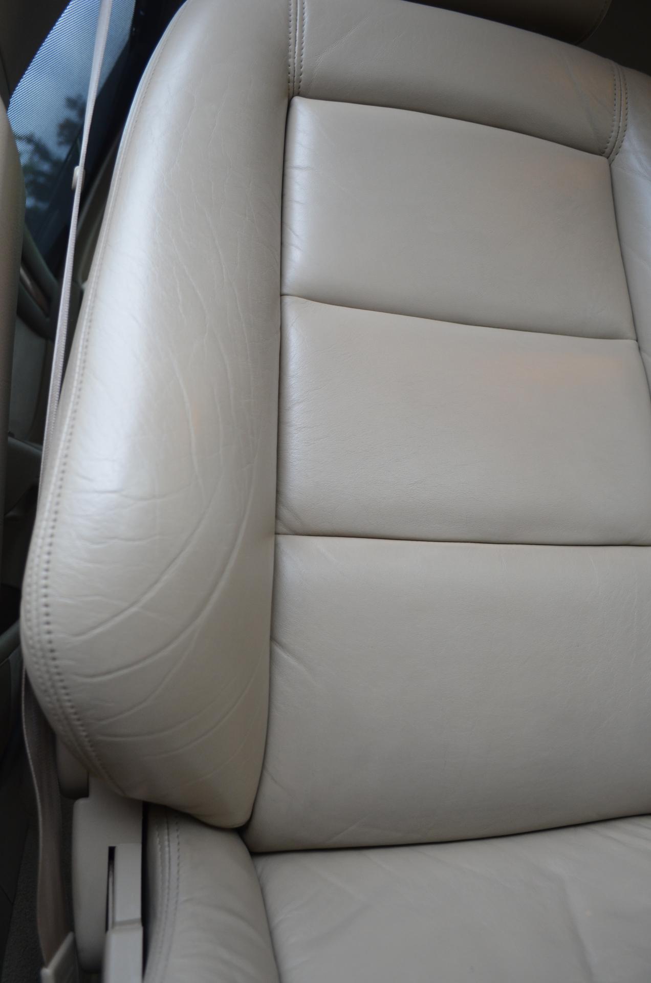

the code referred to earlier in this thread (Audi Beige - 26658)
So I went ahead and ordered that a while back, made a start today as the weather is finally OK!
Didn't have much time so began on the seat base which has a couple of big scuffs, mainly just in front of the buttons where the top surface is completely worn off (by shoes?) leaving dark patches.
That seemed to go well so I decided to attack the outer side section on the drivers seat back as that was the most visible bad area, creased and grubby.
My technique obviously needs improvement and practice ; after cleaning I think I put too much coloured renovator on so it was a rather patchy, even after waiting and doing a second application.
I think I rubbed the first one too much and broke up the surface so the next coat was more "dabbed" on and looks a lot better. I think after a 3rd thin coat it will be fine.
The colour match when dried is excellent, so I'm feeling positive about the rest.
Photos attached:
The first one shows the base fully treated, the front corner of which was badly damaged with a large dark area (and some marks elsewhere). Not quite perfect but not noticeable unless you inspect closely.
The second one shows the seat as it is now, part-treated. Only the side support next to the door has been cleaned and partly-coloured, you can see some streaking if you look carefully. Needs another thin coat (or 2) and then the finishing cream.
The thigh support is probably the next worst section, along with the door-side hip support, both are pretty grubby as you can see.
