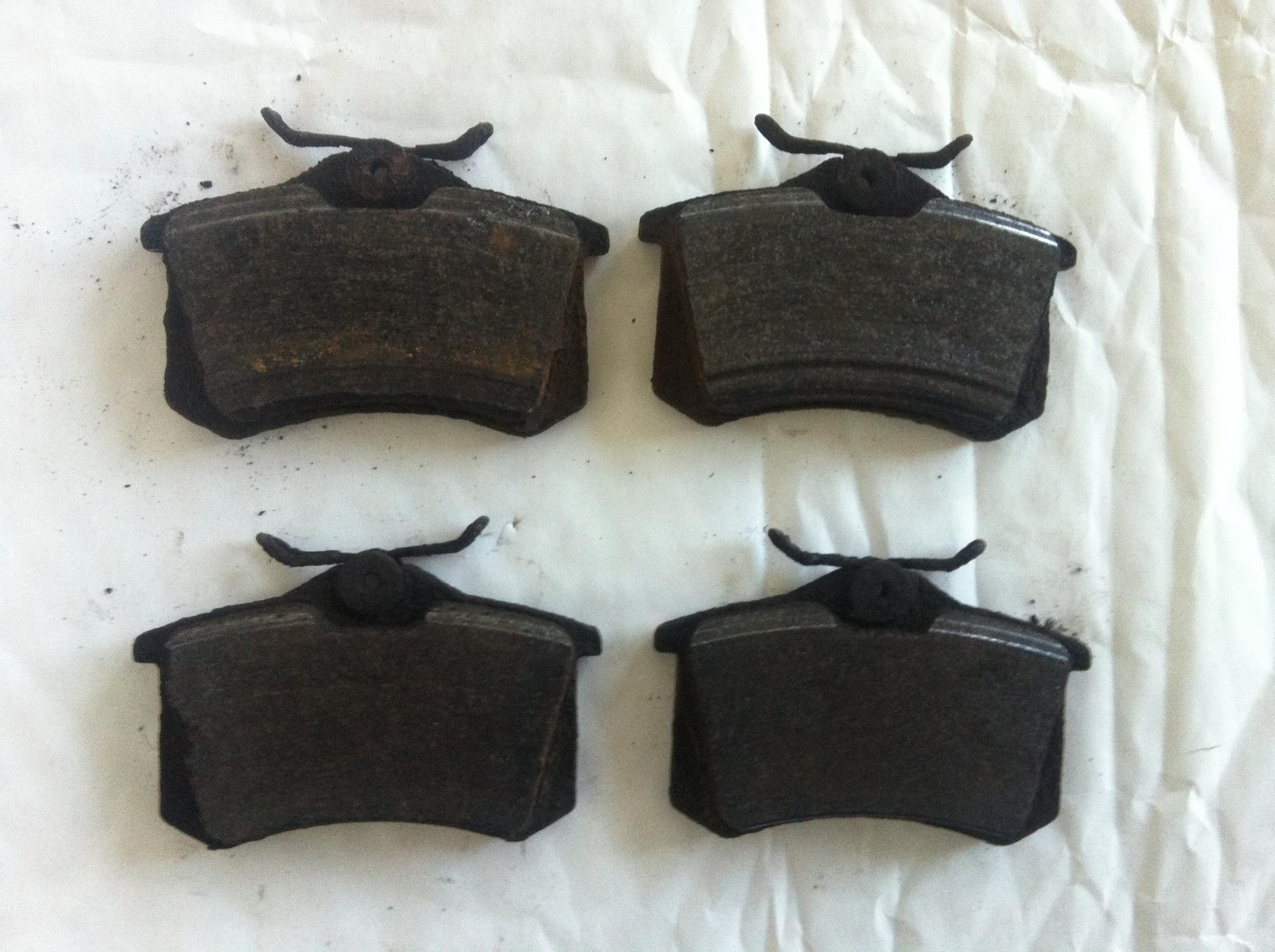

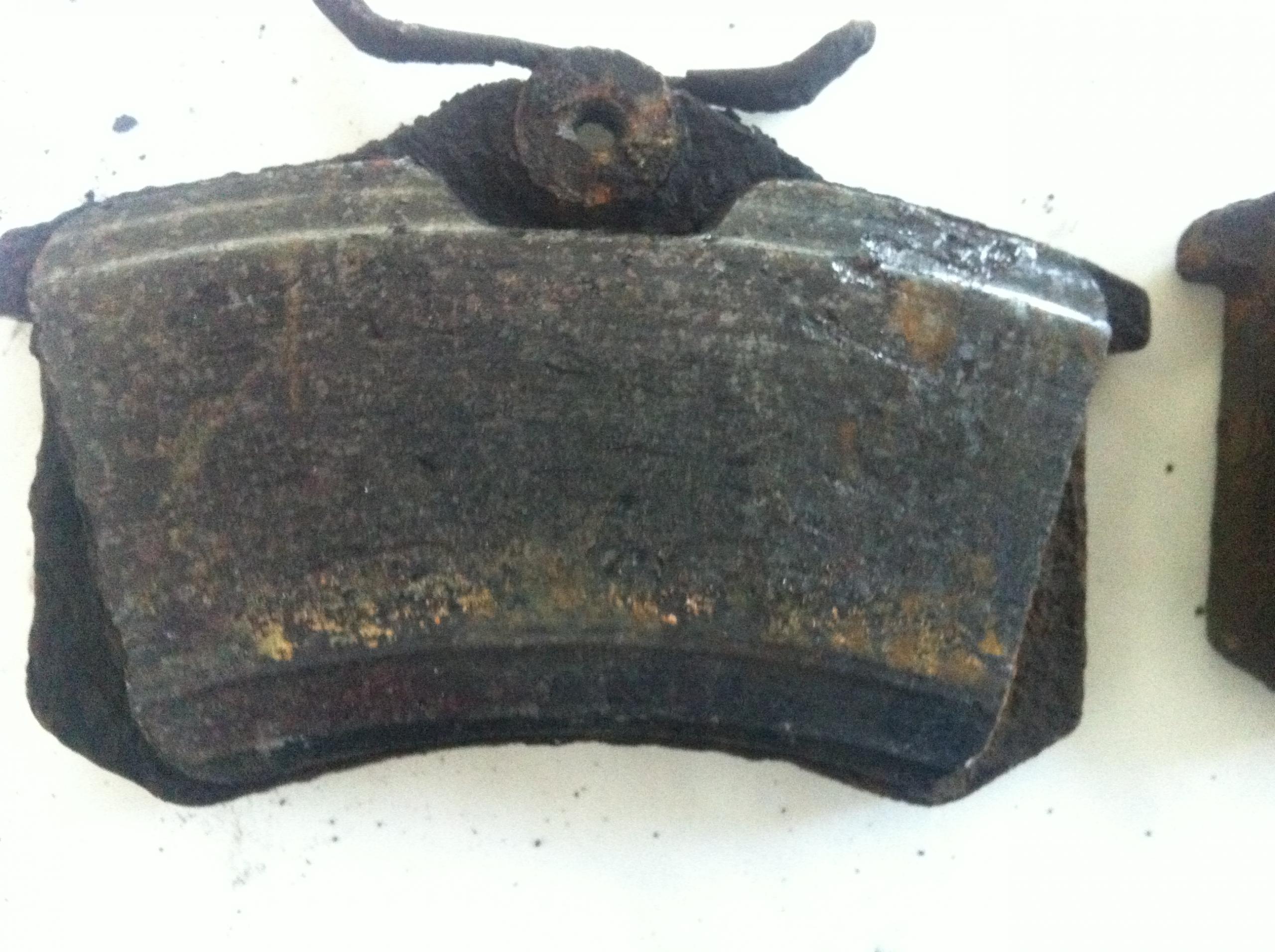

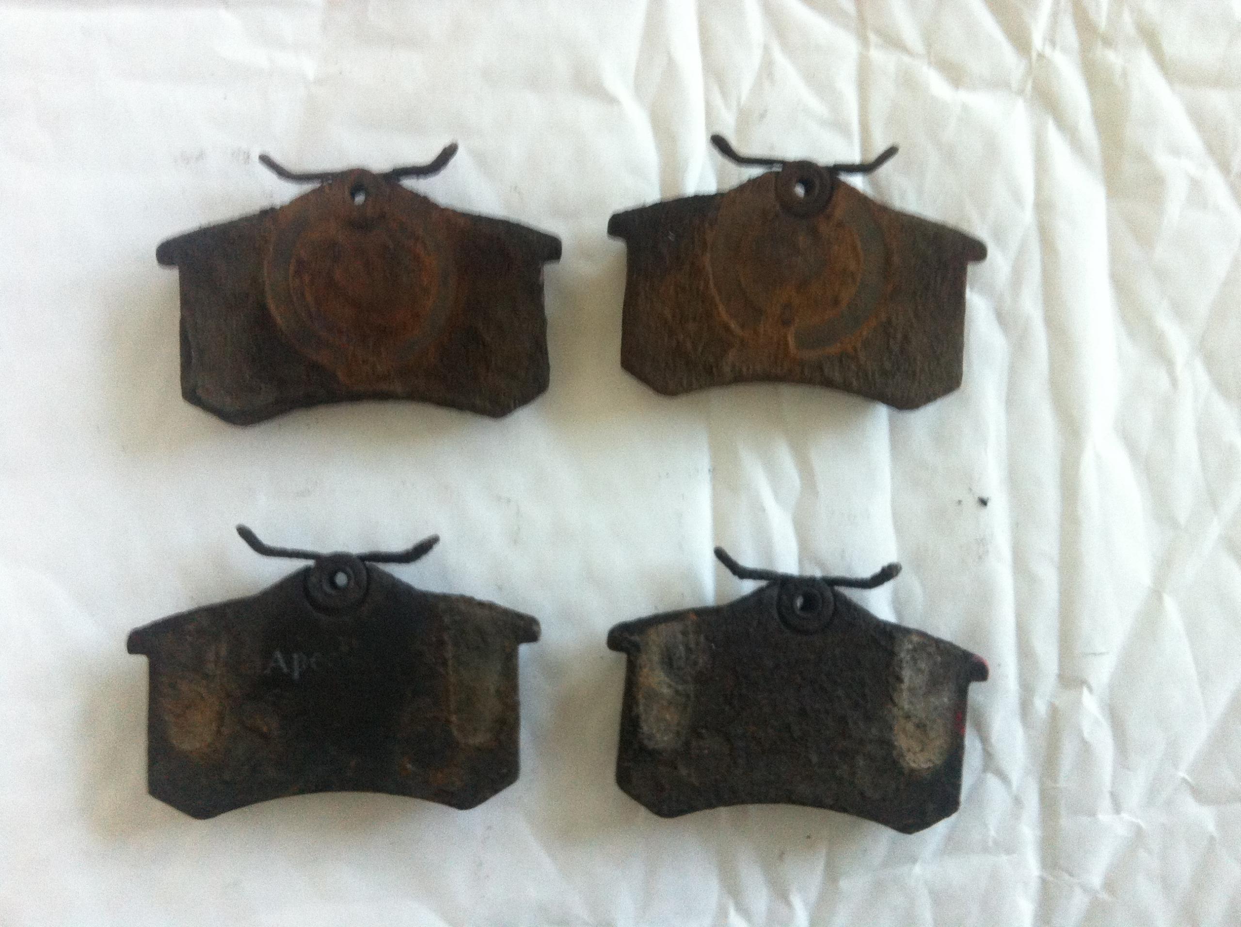

Got the car back from Owen Ferry Automotive a couple of days ago and, fingers crossed, all seems well!
They have a gadget that measures the temperature of the discs and Owen had phoned, after they'd taken it for a run, to say that one of the rear discs was hotter than the other three and he was going to investigate. Earlier in this thread, someone said that you can't always tell whether the problem is front or rear brakes.
Now, that's 2 things I like about a garage already: keeps you informed and investigates (doesn't just replace parts).
So, as the photos below clearly illustrate, one of the rear calipers had the pads stuck (the rusty ones at the top of the photo) and these were catching on the disc (see the grooves at the base of 2 of the pads).
Another thing I like about a garage: they keep the old parts to show you what the problem was.
Owen phoned again to let me know the score and recommended that he replaced the rear pads and skimmed the discs. They have another gadget that does this on the hub to compensate for any 'hub run out' (I think that means it doesn't spin in a perfect circle). He also suggested that I should consider having the front discs skimmed too.
Point 4 that I like about a garage: ask the customer before racking up a big bill.
So, I had all 4 discs skimmed and replacement rear pads. Owen took the photo of one of the front discs after he'd skimmed it (another point for Owen! ) and sent it to me.
Now, I know I have to wait to see if this resolves the problems that were recurring at around 3,000 miles, but I have never had such beautifully smooth brakes - the effect of the skimming is amazing! I drove David's S8 last weekend and thought how nice his brakes were (before mine were fixed), but mine are even better now!
So, full marks for Owen Ferry: nice guy; clean, well equipped garage; brilliant customer service; cares about what he does!

  #36
Old 24th April 2014, 08:21 AM
Good result Jim! how much did he charge for the whole lot then?
  #37
Old 24th April 2014, 08:37 AM
Six hours labour at £39 per hour plus £28 for the pads (all plus VAT). Total £314 incl. VAT.
He'd also checked that the calipers were all working OK so, if this is the cure (and the brakes are better than they've ever been), I think it's money well spent.

Yes, there is a scenario that fits as well:
The last set of new front discs and pads were a different make of pad to the first 2 attempts. So, it could be that that the front set-up was fine and it's just coincidence that the problem with the rear pads occured around 3K miles after the front ones were last fixed.
The old rear pads look like a make that begins 'Ape---' but I can't make the full word out. Ring any bells with anyone?
  #40
Old 24th April 2014, 09:47 AM
Could be 'Apec': http://www.apec-braking.co.uk/
