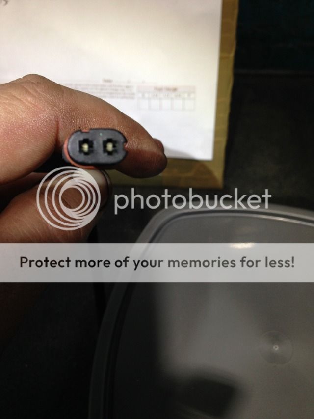

Scott is it this type of plug for the aux heater pump, just go on there site and search for webasto connectors .
I got the pump off ebay somewhere and just cut the incorrect plug off and soldered the correct end on .
The rest pump is present but like already said by Snap D it looks like it will not come in on the timed function ......well as far as we have worked out up to now .
Ive done mine and when the bumpers off its afew more hours of labour to get the pump on the webasto unit ........in my opinion its worth doing .... but perhaps up North its a bit colder than the sunny south

That's the badger.
I could never find it on their site.
Still can't. haha.
Did you find the plug for the pump side?
EDIT: This is helpful.
http://www.webasto.com/fileadmin/web...-catalogue.pdf
Found this on ebay.
http://www.ebay.co.uk/itm/171208163899

http://www.ebay.co.uk/ulk/itm/201468274208
Think it was this one Scott , see it's got a bit of loom already , just cut the plug end off and soldered the one on in my first pictures

My pump does not have the cable.
I got a plug on my bump side.
I need to go back through my parts and double check what I'm missing for the pump.
Been almost a year since I've looked at it.
Thanks for the link though.
