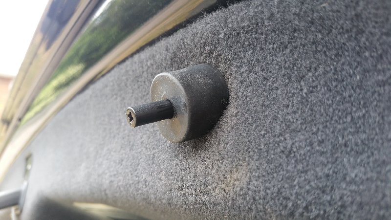

That is not the adjustable type.
This is the type we are talking about. It was an upgrade to solve the boot lid problem.

Posts: 1,669
Attachment 19411
This is the version I have but when I try and turn the outer part, it does not budge. I will try again with mole grips.
