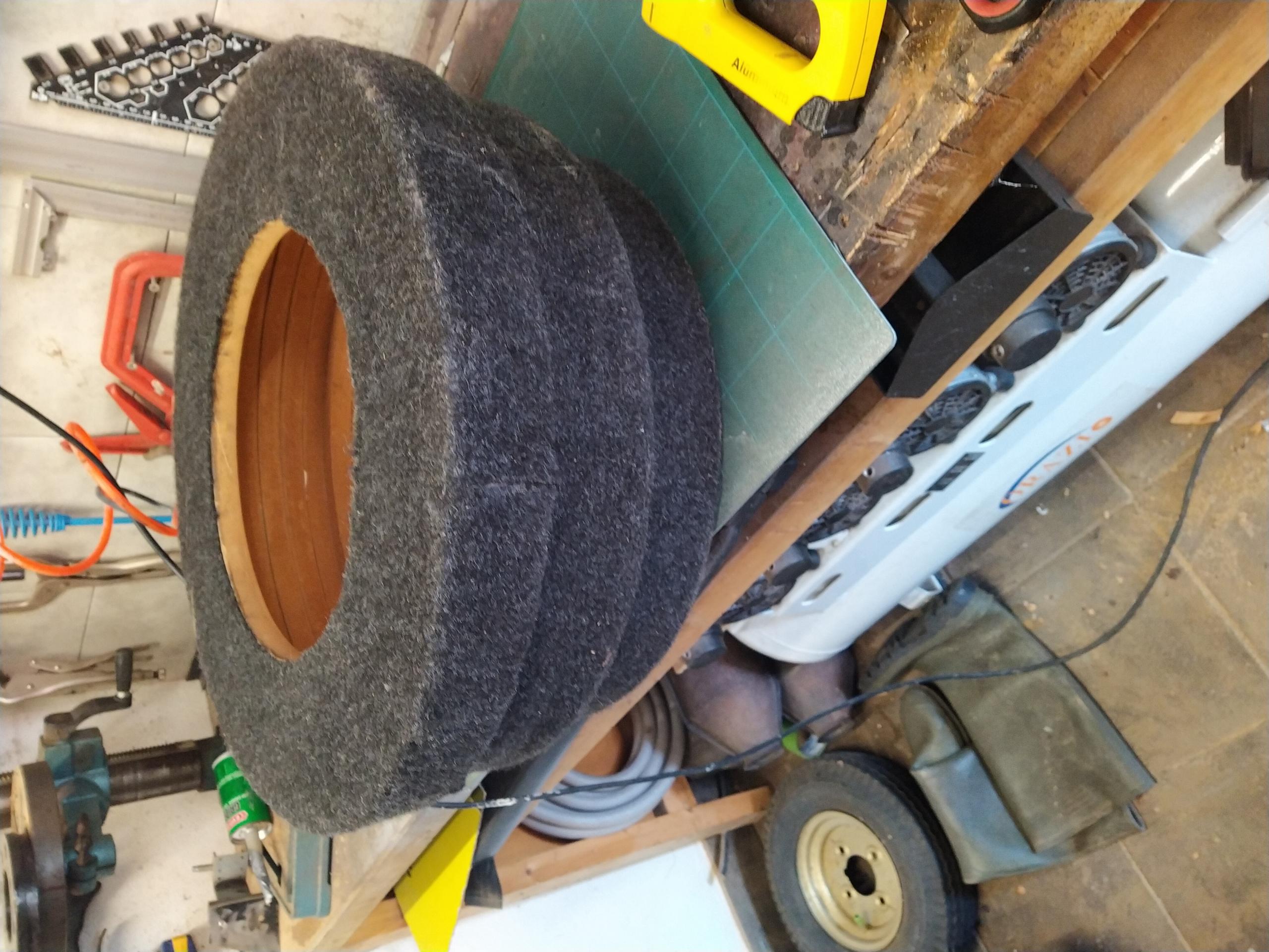

Been a while since I've worked on the audio, as got sidetracked by more urgent things however back on track now
Genesis Amp fitted,
Sub box made to fit inside the spare wheel, not as hard as I'd feared. JL 12" low profile sub installed.
Just waiting on my DSP and speaker cable to arrive before getting things connected up
