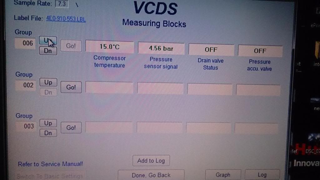

Starting pressure on Comfort was 4.56 bar

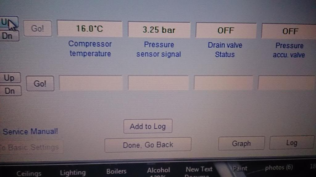

Then lowered it to dynamic and pressure after shutting off the valves was 3.25 bar

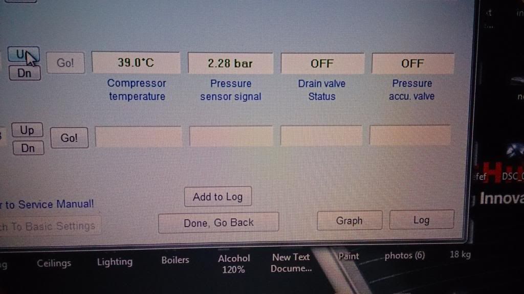

Then lift and 2.28 bar

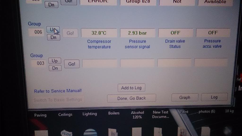

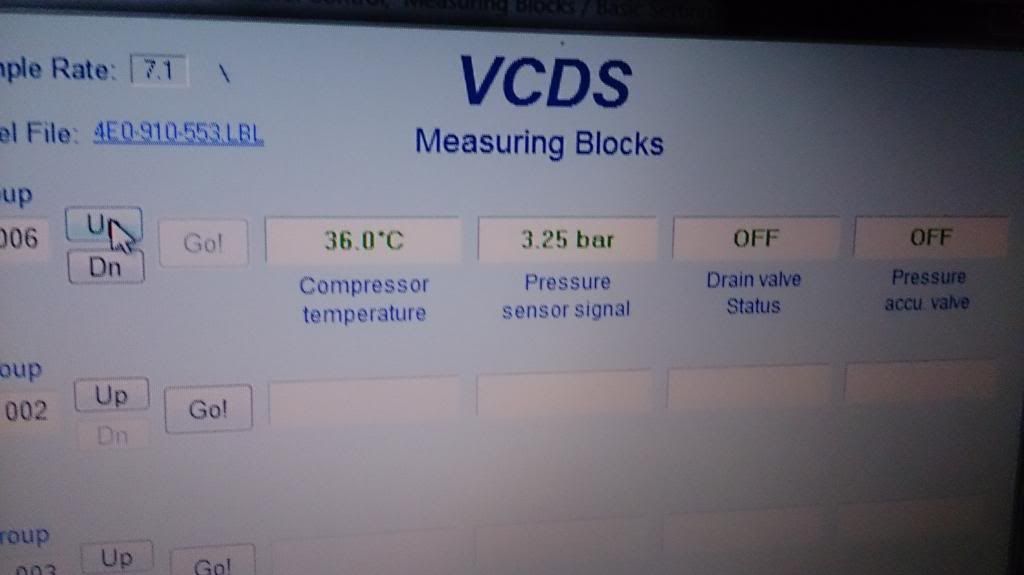

Then pressure on Dynamic was 2.28 bar
[IMG][/IMG]
...and comfort just over 3 bar
[IMG][/IMG]
