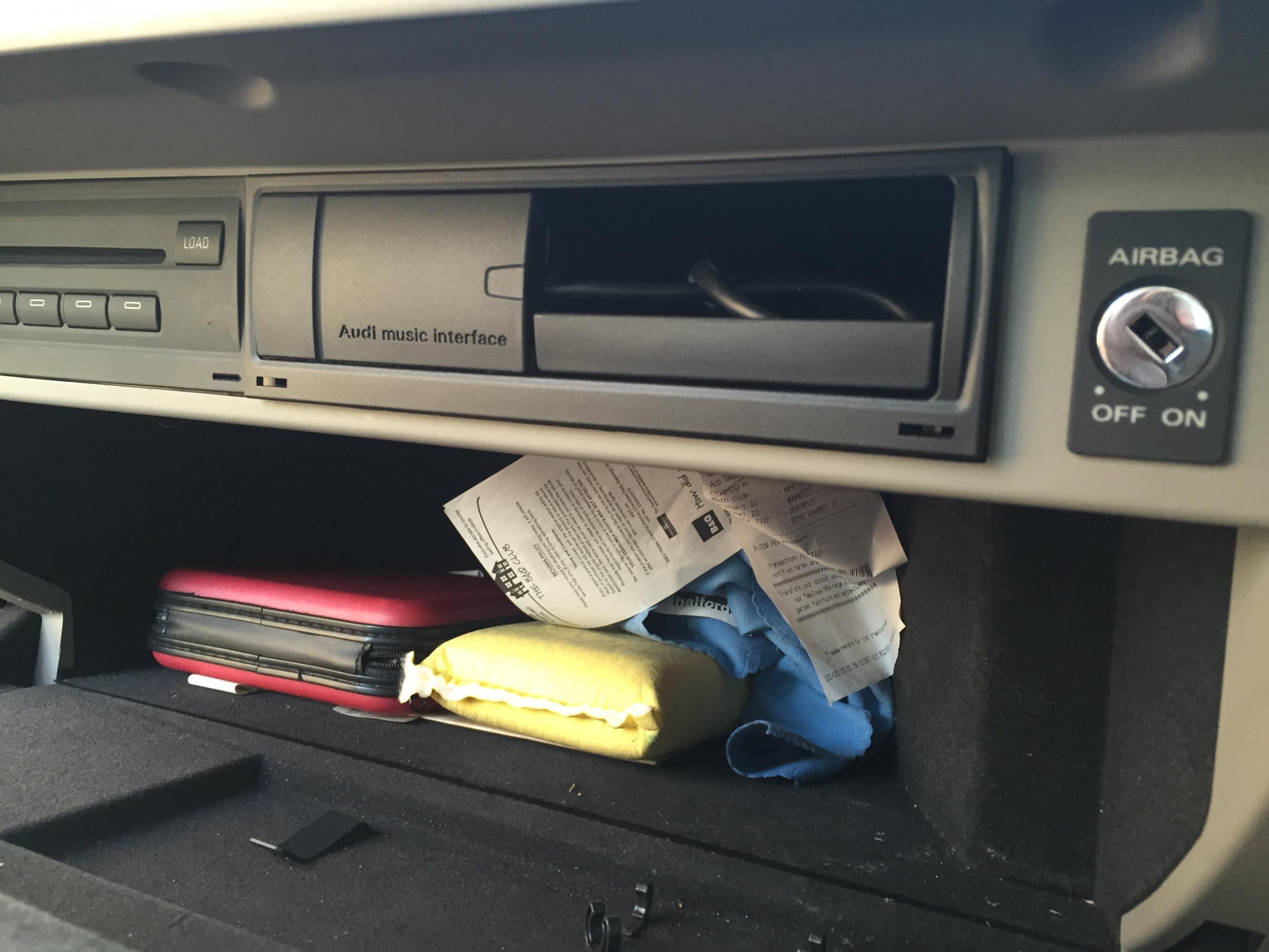

Now I am trying to put the car back together properly, and failing miserably.
I have got the CD changer back in place, all clipped in nicely but the AMI does not want to play ball. The module seems to be getting pivoting on something in the front of the slot, I can get either the left of the right side in but not both at the same time. I've tried applying pressure dead centre but it refuses to go click into place. Its not the wiring or fibre in the way, its something in the front of the glovebox slot or on the AMI itself getting in the way.
To make matters worse I cannot now remove the changer, the removal tools cannot seem to get a good hold on the metal tag on the changer. The same tools seem to get a good purchase on the AMI ones. When you push them into the changer, they appear to engage but when you pull they just come out again. My only concern is that something has caught on the back of the changer, thus causing it to sit slightly off distorting the slots slightly.
I was hoping to remove the whole kit when I sell the car, but unless I can get the changer out that is not going to happen now either.
So to summarise, the AMI will not fully locate in slot 2 for the reasons above, the CD changer is clipped into place fine but now cannot be removed.
Manny

Just been out and had another play, changer still stuck and it does look like the right hand bay is not as deep as the left. The AMI unit is quiet a bit deeper than the tray I removed, I guess because my car pre dates the AMI no allowance was ever made for it to be fitted.
The pictures below are as far back as it will go.
Also spotted the glovebox light does not work.

  #50
Old 28th May 2015, 07:38 PM
Posts: 2,341
Mannyo,
Mine is a 2004 D3 3.0 TDI.
When I was pondering the AMI fitting I read the post that you found about cutting the rear of the glove box and was prepared. When I actually fitted the AMI there was not a problem.
CD changer on the left and AMI on the right. I have since had the glove box completely ouit on three occasions whilst fitting a Reversing camera and did not have any probs with removing or refitting the two units.
Looking at the small amount your AMI is protruding I would think that something is fouling at the back. Pity that you will not be at the meet because I am planning on bringing my Snake Scope with me. That is a flexible stalk with a camera on the end that plugs into my laptop. We could have poked it behind the glove box to see what is happening.
Good luck with it, so frustrating to be so near but no cigar.
Ray
