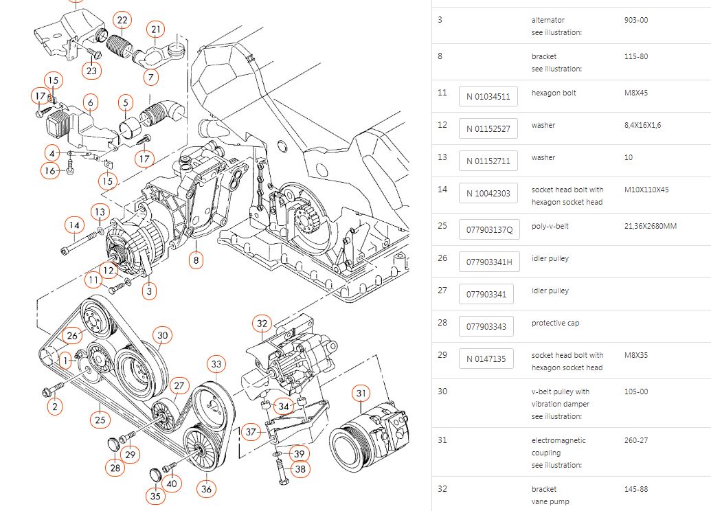

Old 3rd May 2019, 12:56 PM
Hi Mikki,
I am getting ready to do this swap. Is this the right part number for the RS6 idler pulley please?
077903341H
No. 26 in the picture.
Thanks!

  #55
Old 3rd May 2019, 01:39 PM
Yeah that's the one Still available from Audi last time I checked. Mike and I have laser-cut alloy plates for mounting the Spal fan now too if you want one.
