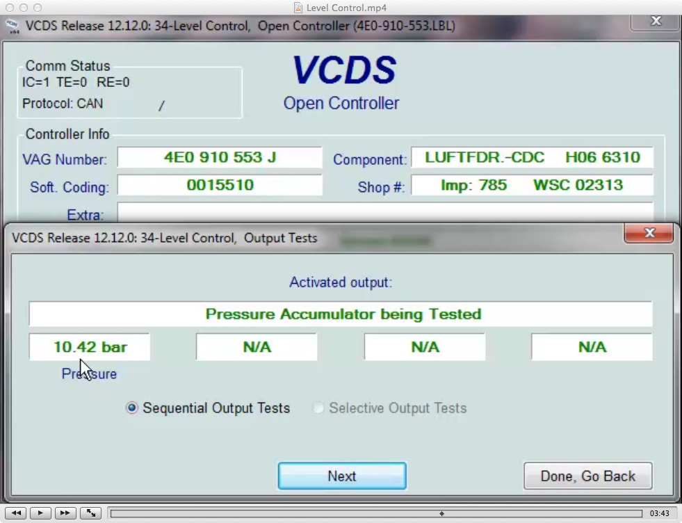

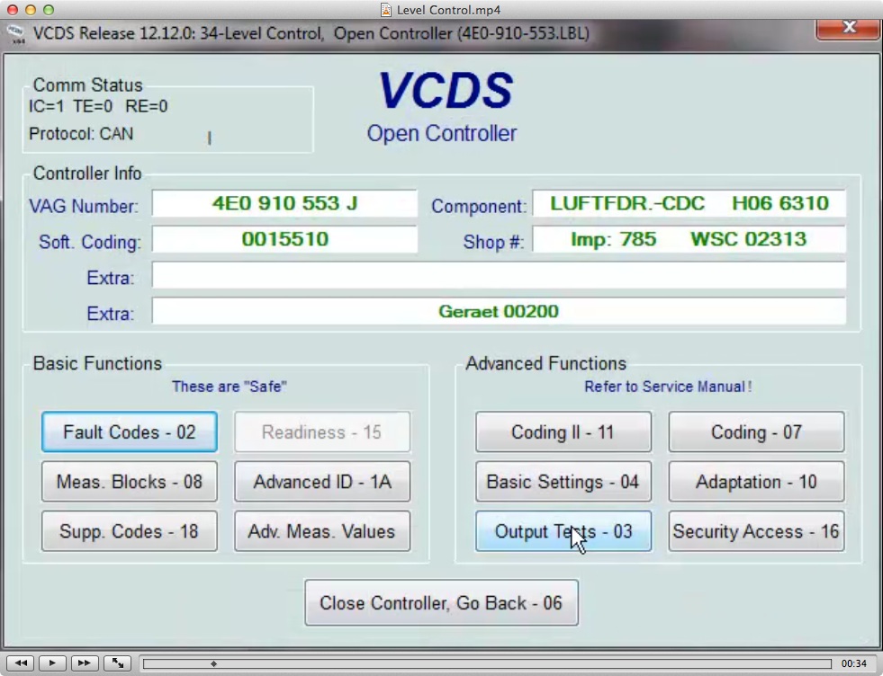

Old 2nd February 2014, 10:02 PM
Default Max pressure on my Comp
Hi Chaps,
As promised heres my pressure (max) reading.
To carry out the following test the engine does not need to be running, which helps as you can hear the compressor start and stop.
To get the true output of your compressor, open Level control module (34) and select output test
Then keep clicking next through the tests until you get to Pressure Accumulator test.
Once you have started the test you will hear the compressor run, let it run till it stops and you will see your max pressure.
ID:	7230   Click image for larger version

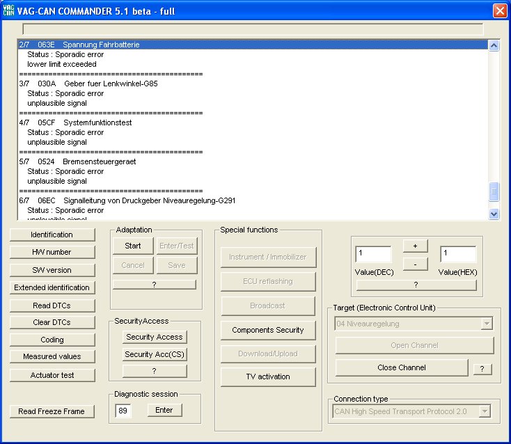

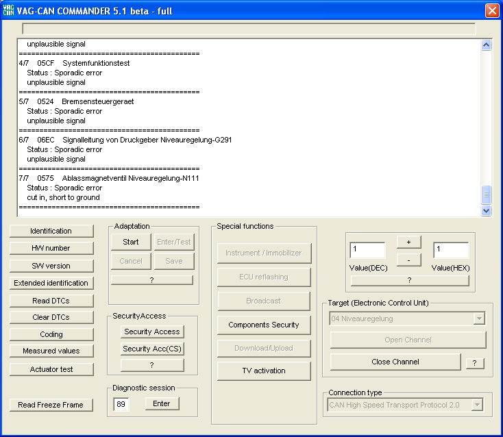

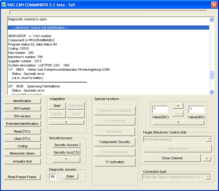

gninnam gninnam is offline
Location: On the computer
Posts: 1,404
Found this using the VAG-CAN cable that M-A8 gave me
Do the error codes mean anything to anyone??
Andy.
Current cars:
BMW i4 M-Sport
Peugeot 207 (the sons)
Gone but not forgotten
  #70
Old 25th April 2014, 08:13 AM
Posts: 1,404
No one can help me ??
