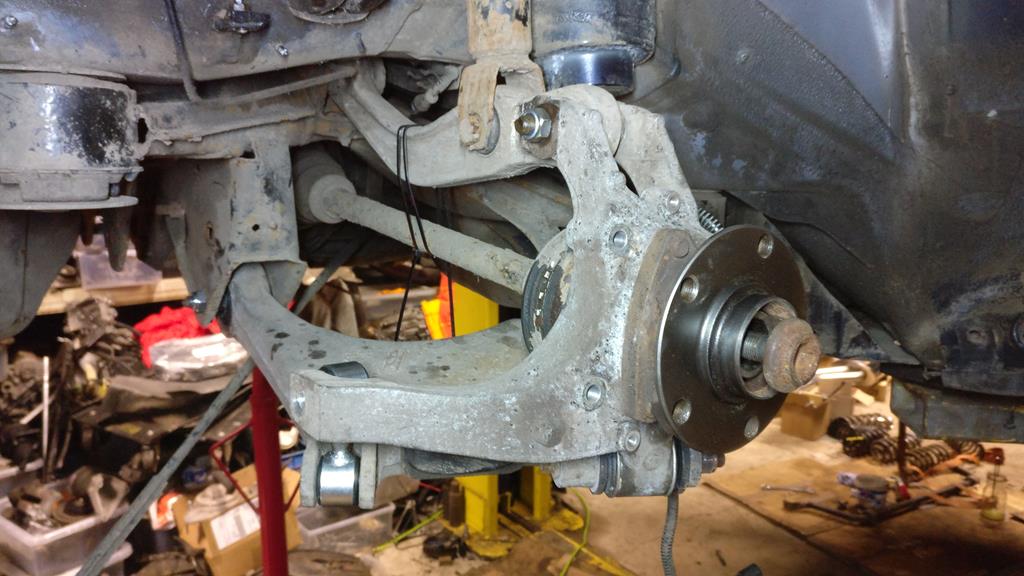

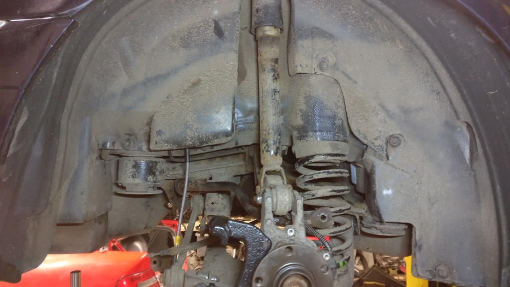

Started putting the suspension back together with new bushes

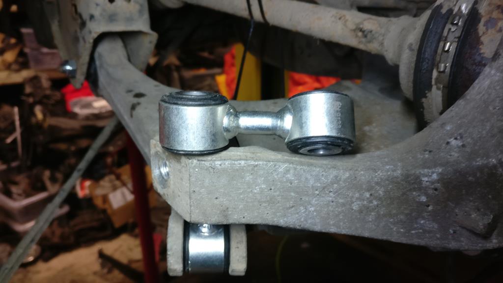

Replaced these little link arms as they were very tired. These don't wear out very often, but perhaps they see more movement in a comfort suspension setup.
The brand new sport bump-stops are very sad because they have no new sport dampers to live on These will just have to sit in their box for now.

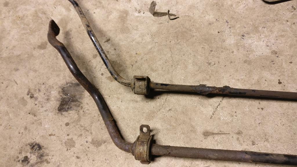

S8 rear ARB compared to the A8 comfort one

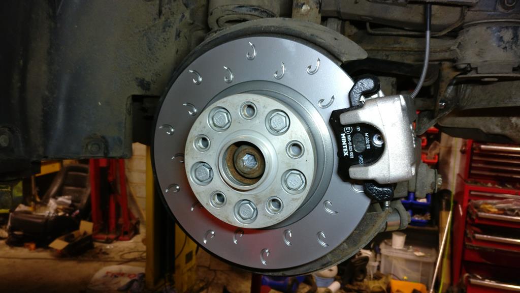

Not particularly exciting at the moment - just putting suspension components back on. All the lower arm bushes are replaced now, along with the tie rod link. I'm still waiting on the new ARB links, then the disc backplates and discs can go back on.

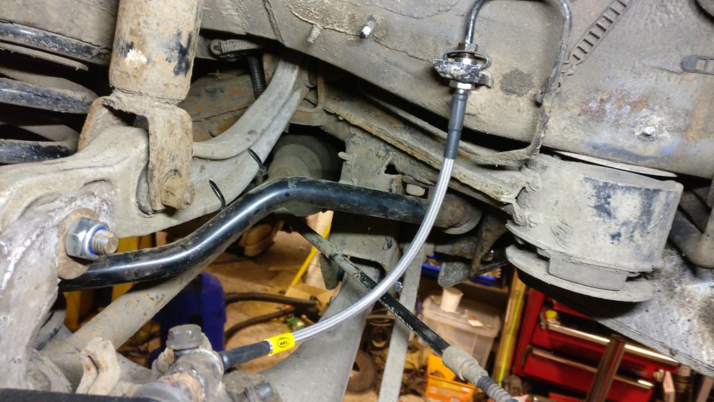

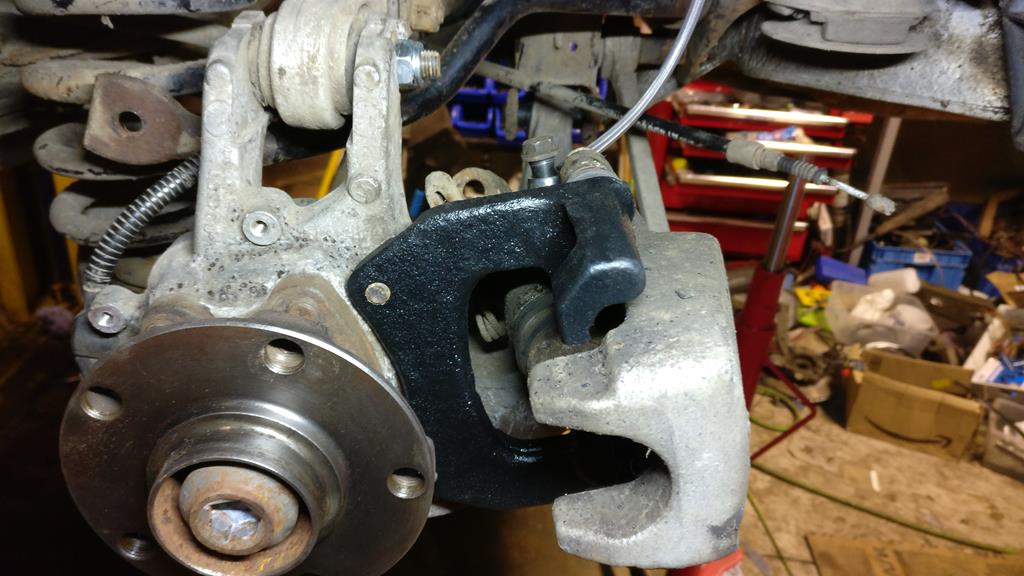

HEL brake hoses fitted on the back, plus the blasted and painted S8 rear caliper carriers. This is one of the original calipers mounted up so I can get the angle on the hose correct
One of the hoses in place
Rear end as back together as it can be pending parts turning up

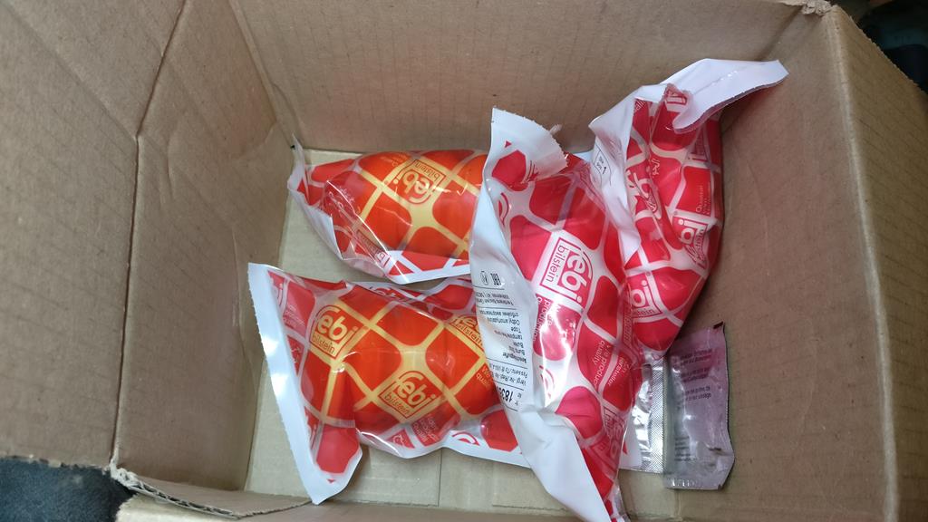

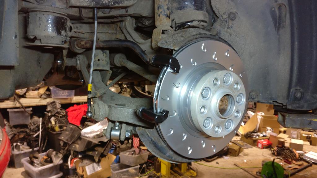

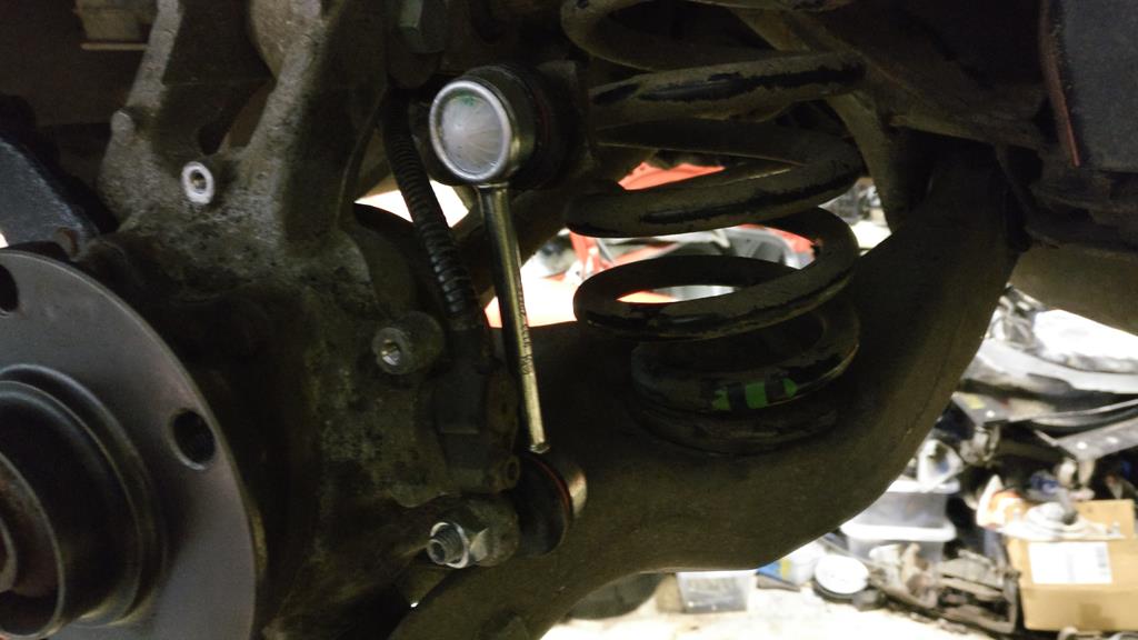

ARB drop links fitted
Shiny bits! C-hook discs from MTec
Left side with a shiny new caliper and Mintex pads as well

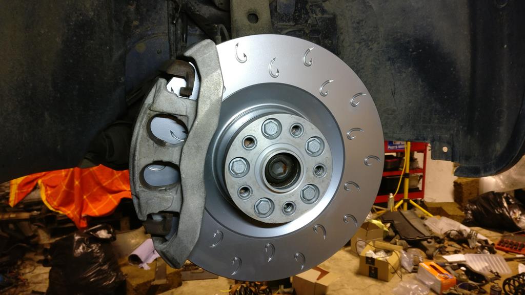

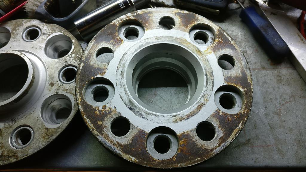

There was a slight wheel wobble evident on the trip to the workshop, which may have been caused by this corrosion on the spacers, picked up from the original discs. I cleaned this off with a utility knife blade then wire wool so its nice and clean. With cleaned hubs and new discs, hopefully that should sort it.
One of the front discs and calipers mounted up

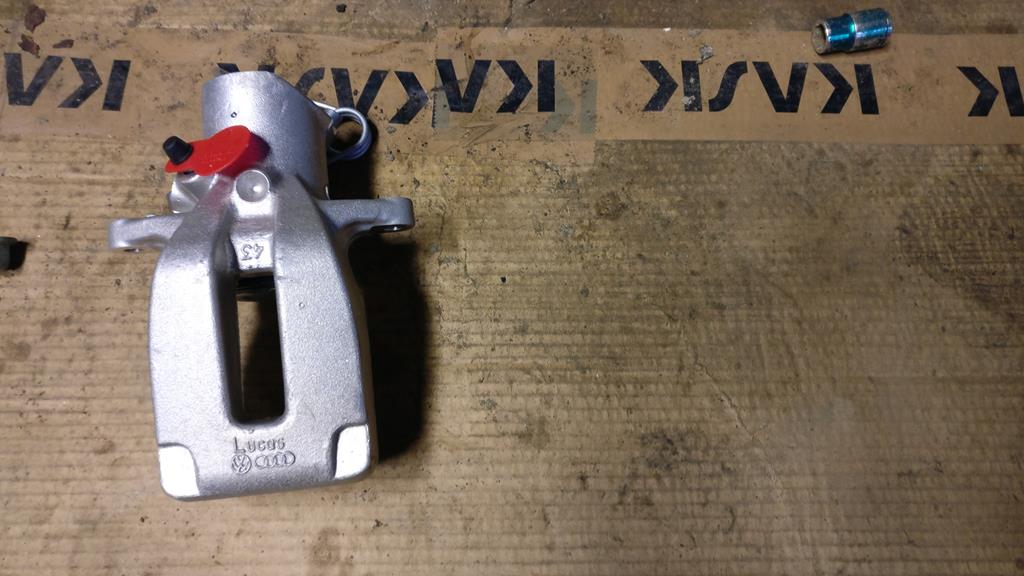

The missing rear caliper is supposed to be here on Saturday which is cutting it awfully fine since he's going home on Sunday...
