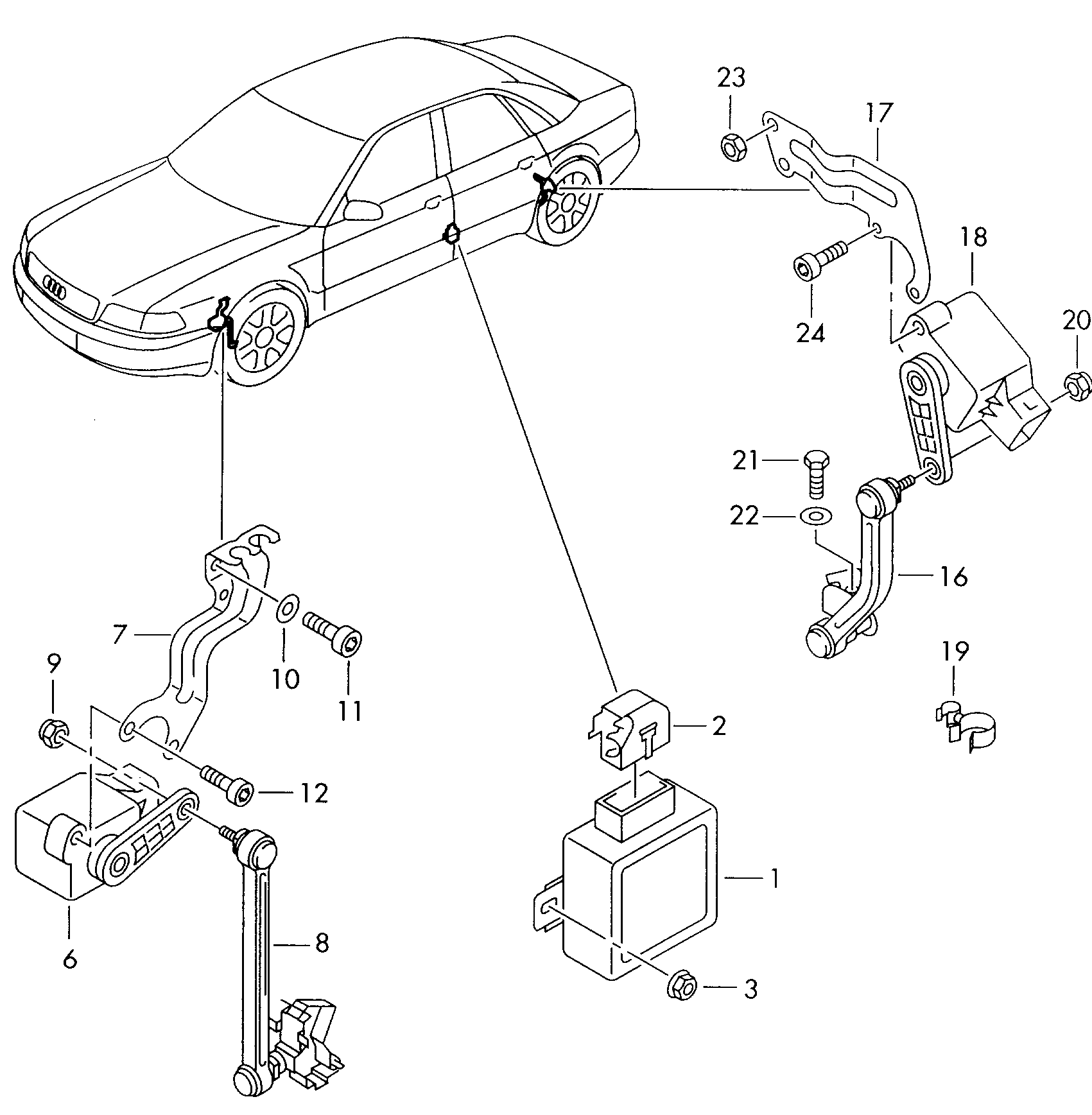

seems to suggest here that its the control module rather than the sensor David, which would perhaps explain lack of info re rear/front
http://wiki.ross-tech.com/wiki/index.php/01537
  #72
Old 17th May 2014, 05:18 PM
They should be reading 2.4v statically so either both have failed at the same time, which seems unlikely, or as suggested somewhere upstream....
  #73
Old 17th May 2014, 07:03 PM
Thanks for the info, guys. I think that the next step will be a physical examination of the system....
  #74
Old 18th May 2014, 06:56 PM
Just noticed the part no in the scan is also the control module
http://www.ebay.co.uk/itm/VW-AUDI-SK...item5afeb0c6c6
  #75
Old 18th May 2014, 07:33 PM
Thanks for that Brian. It is all starting to point towards the control module which would account for the measuring blocks both being the same as well as out of spec, i guess?
  #76
Old 21st May 2014, 02:51 PM
But where is the control module?
  #77
Old 21st May 2014, 03:39 PM
Looks like its in the passenger B-Pillar area.
Name:	Self levelling control unit.png
  #78
Old 21st May 2014, 06:22 PM
elsawin guide installed, which isn't much more detailed than the pic above!
B pillar removal is fairly involved....
  #79
Old 21st May 2014, 06:28 PM
With a bit of luck it will under the lower trim which appears easier. IT in another thread on the same subject states that, when chasing a defect on this system, he changed the control unit before removing the sensors as it was easier.
  #80
Old 22nd May 2014, 08:21 AM
Ordered a new control module, but it won't arrive in time for the long weekend. Might have a look see for th existing module location whilst I wait.
