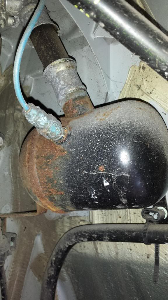

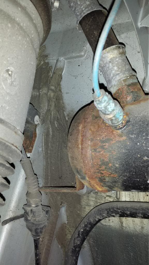

Took the lining out of the rear offside arch to have a look and the accumulator doesn't look to good to me - could this be the issue?
I think at the weekend I will take the liners off all wheel arches and have a play with the suspension to see if I can find a definitive leak.....

should be easily diagnosed with a spray bottle with soapy water
  #89
Old 14th May 2014, 08:23 PM
Was going to say same thing, while arch was off all you could spray some soapy water and if its leaking you would know it straight away.

That's the plan
