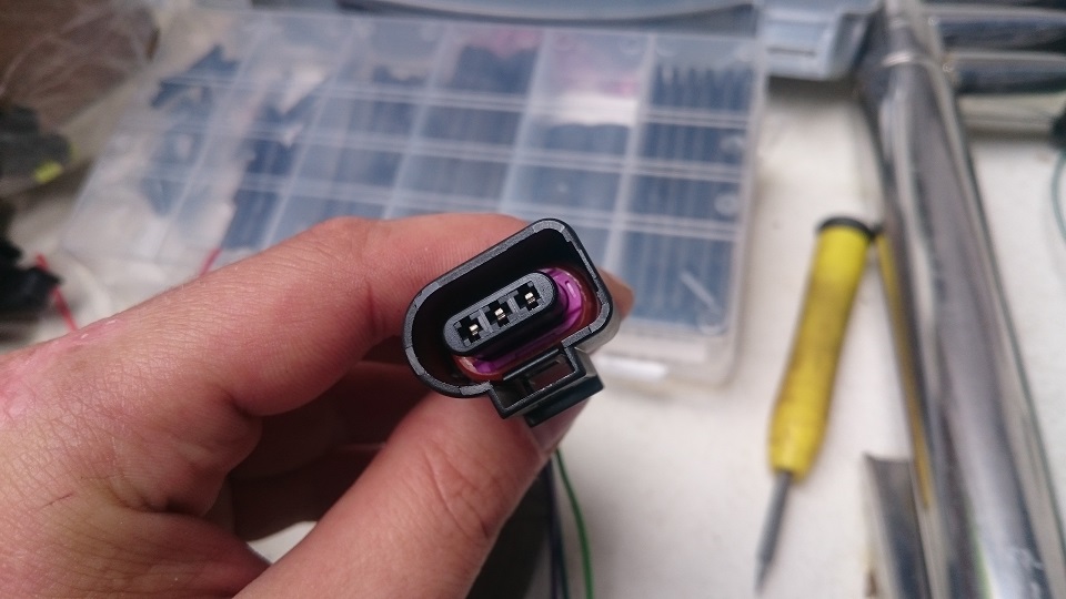

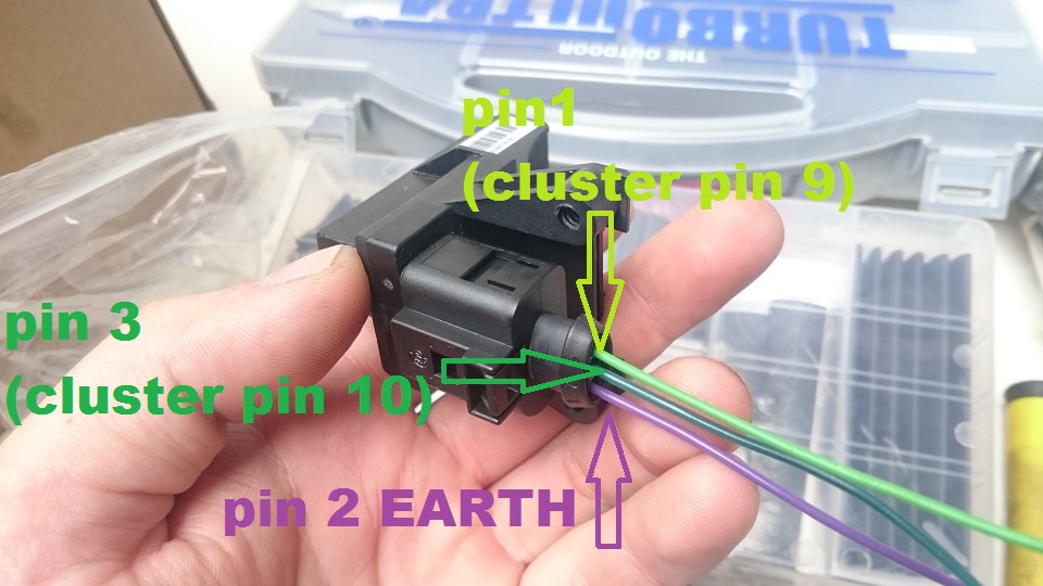

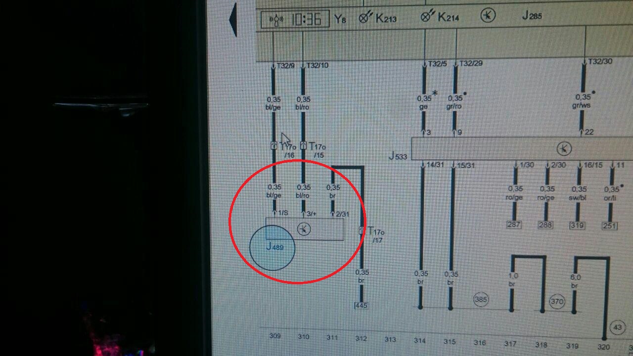

I started with wiring the plug for the receiver base on this diagram.
I have used 0.5 wires instead of 0.35 as that is what I have left after AFS retrofit which I have completed last weekend and a separate thread will follow up shortly, also colours of wires are different.

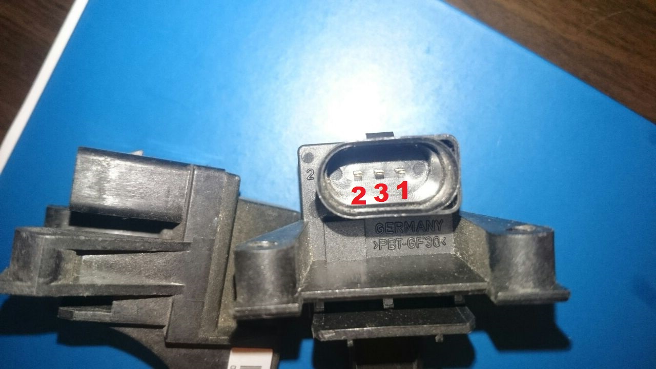

Please note that pins on receiver are in different order than on the plug.
Plug pins are 1 - 2 - 3
Receiver pins are 2 - 3 - 1
Pin 2 is marked on the receiver, first one from the left

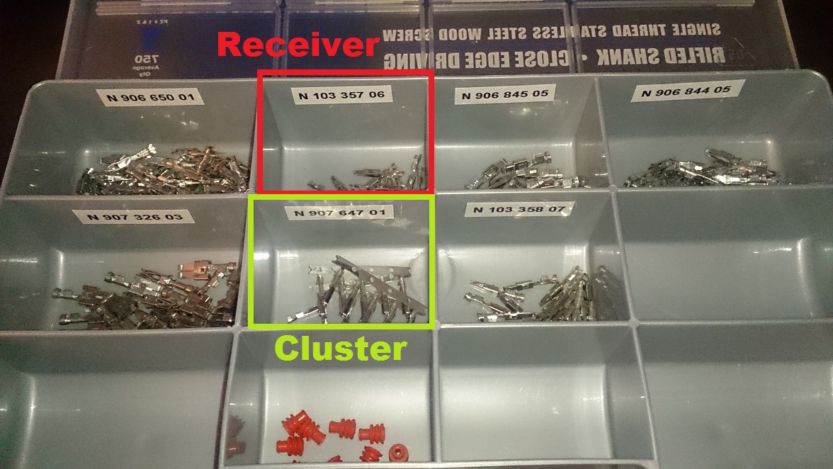

I have used terminal connectors for 0.5 wires not much thicker ones which are supplied with the plug from eBay link
N 103 357 06
and N 907 647 01 for the connector on the back of the cluster

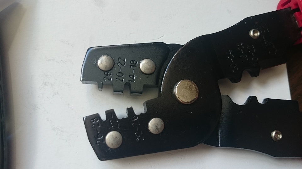

I've used the JPT crimping tool which is the best tool you can have for any electrical repair/mods around the car, £19.99
http://www.ebay.co.uk/itm/1716253073...%3AMEBIDX%3AIT

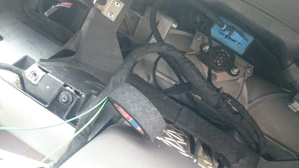

Originally receiver is installed behind the rear bumper, in all honesty, I couldn't be bothered to go through so much hassle in order to have this retrofit which would involve rear bumper removal and running wires from the rear bumper to the back of the cluster. Call me lazy but I've done a lot of much more significant and complicated work around the car so I basically could be bothered. Plus previous 8s had them fitted behind the cluster anyway.

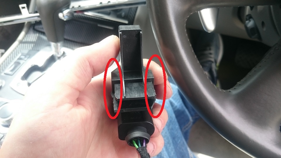

In order to fit the receiver behind the cluster you will have to chop off two fixing points with cable cutters or whatever you have in hand.
Then I wrapped the receiver in fabric tape to prevent any possible ratling or whatever.

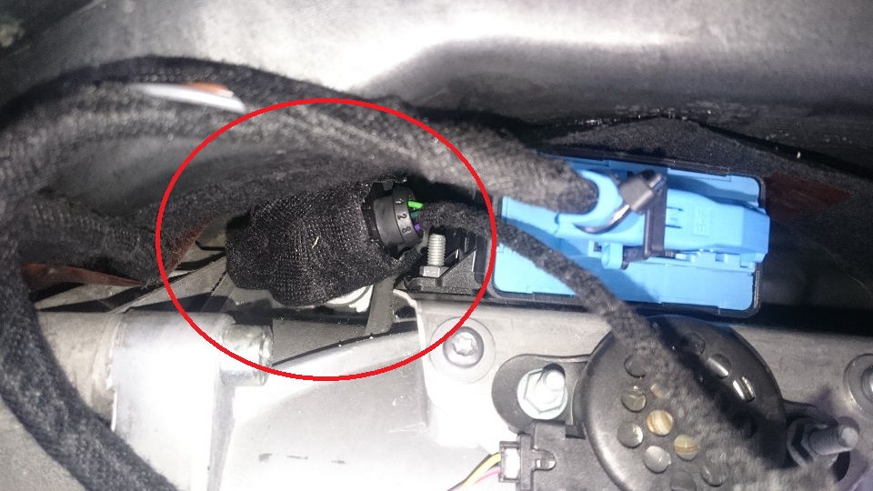

Best location is on the left of the Xenon Range Module (black box with blue connector). There is an open space on the right but nothing to rest on the receiver will just fall through.
As earth (purple wire) I have used the bolt for the Xenon Module bracket.

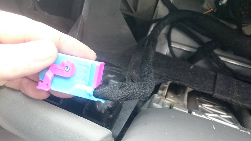

I taped the wires to the existing cluster wiring loom.

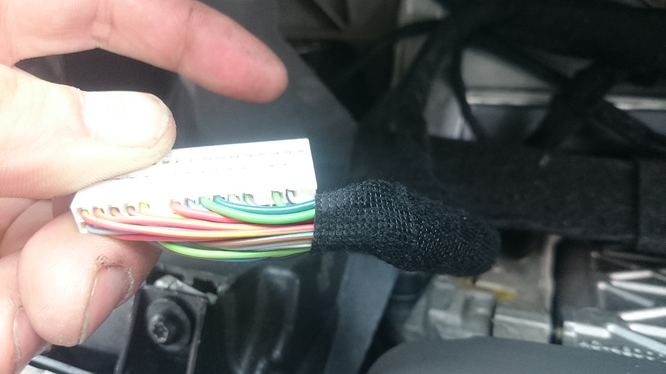

Then I crimped the connectors to the green wires and took the cluster's connector apart in order to plug them in in the position of pin 9 and 10.
Then I just finished taping the loom and new wires together and thats it.

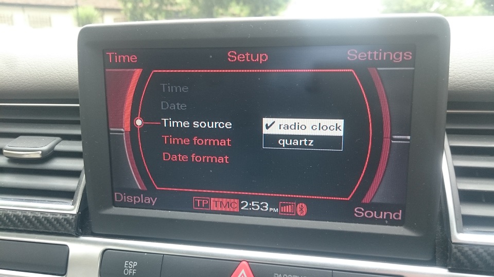

Put all back together and next VCDS
Go to [17] Instruments
then Adaptation
select Radio Controlled Clock from the drop down menu
Change New Value from 0 to 1 or as per instructions in the picture below (1-50 - minutes)
TEST
SAVE
DONE, GO BACK
Exit Controller, close VCDS, unplug the cable and you are done.

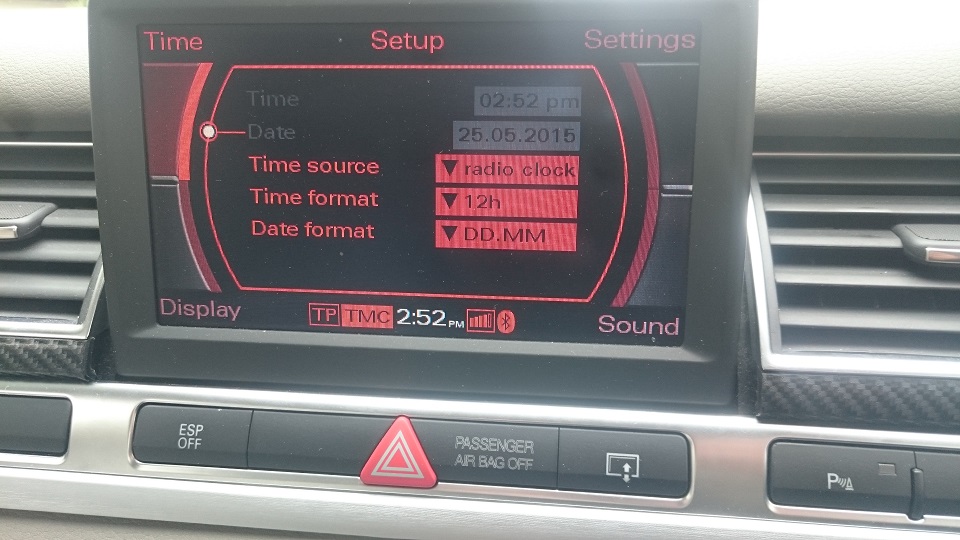

Not sure if on D3 there should be an icon of radio tower like on the D2s, but I assume thats only when receiver will receive the signal from the radio tower in Frankfurt, and from my experience with radio controlled clocks this may take a while and its sync process is only at certain times or something like that.
....or, I messed up something

Just noticed something Marcin and my CDO won't let it go.
Wire colours are wrong
Old 25th May 2015, 07:33 PM
