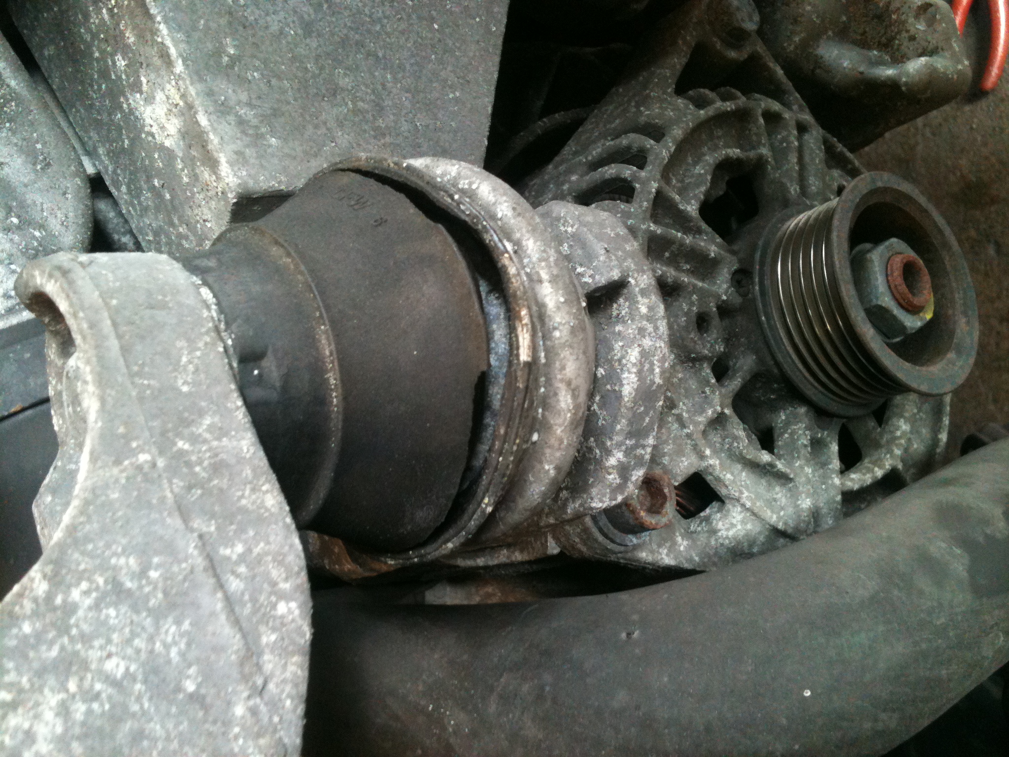

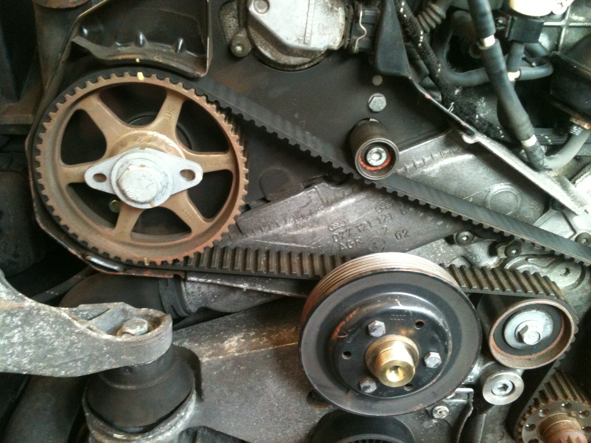

The garage now has the parts and is getting on with the jobs - first the timing belt and then the exhaust and final transmission drive seal.
After removing the front end they also saw that one of the engine mounts is gubbed. The rubber has deteriorated and is badly cracked - see photo - so that has to be done too

Well, the job is now done. The culprit was the thermostat.
In the end after discussion about Contitech and other belt kits with the garage who have had some experience when asked to fit Contitech and other kits by clients (poor pulley alignment/failure) we both agreed that OEM parts should be fitted. (This will cost me when he has worked out the bill next Monday!) What surprised me was that the belt pulleys/ pump and thermo that were removed were Contitech despite the fact that The Laird - who owned the car a few years back - had the belt etc done by A for Audi in Glasgow 5 years ago who state on their website "Only Genuine Audi Parts Used".
