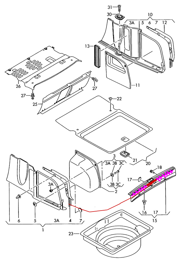

I went down a similar route and bought a cheap aerial. This is the actual one:
http://www.ebay.co.uk/itm/290951505122
I mounted it under the plastic boot trim. (Sorry don't have photos of it installed)
It works ok. Not perfect as would the correct amp for digital radio. When in a poor area the DAB goes to 1 reception quality and then automatically switches to FM. This is unnoticeable when listening. However it's great 90% of the time. And for the little money it's ok until I do the correct amp job.
All I can suggest is to pull the aerial from the DAB unit and see if FW, LW etc are back to normal. If not I guess your new DAB aerial maybe inducing noise to the other existing aerials, as I'm guessing you installed it on the rear window?

I guessed it would be a long time to route the cable. I wasn't up for that so decided to do the lazy route and mounted mine under that trim, at least my DAB cable is separate from all other aerial cables. That's the only difference between our installs.
