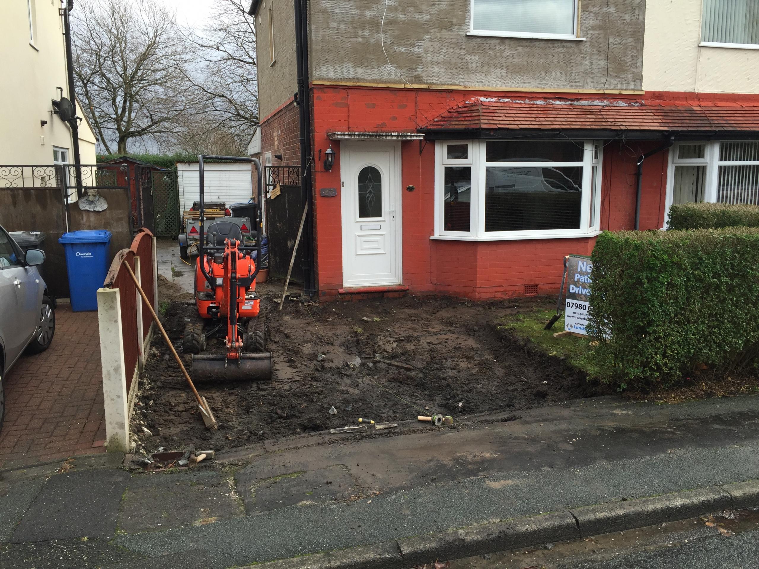

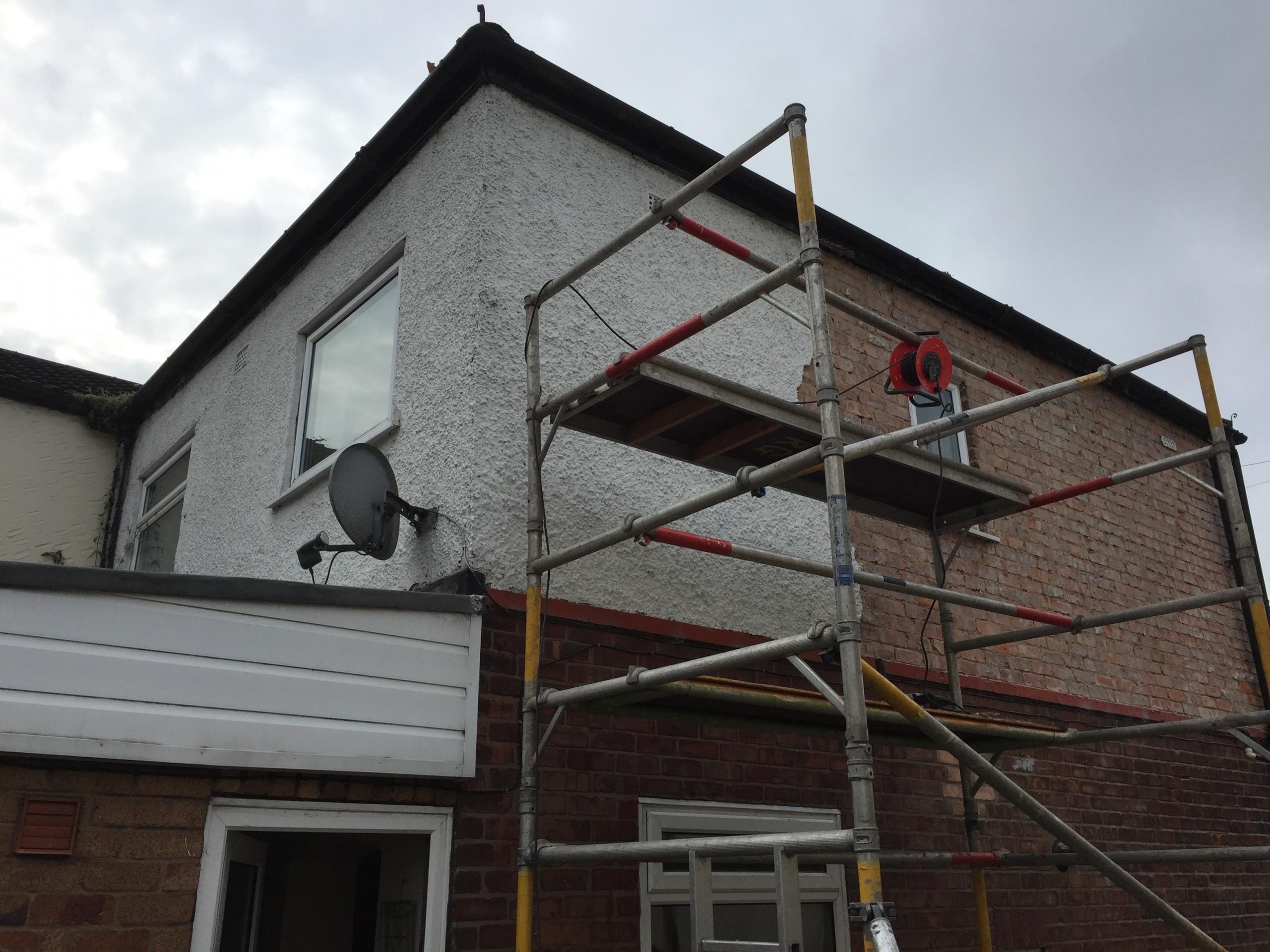

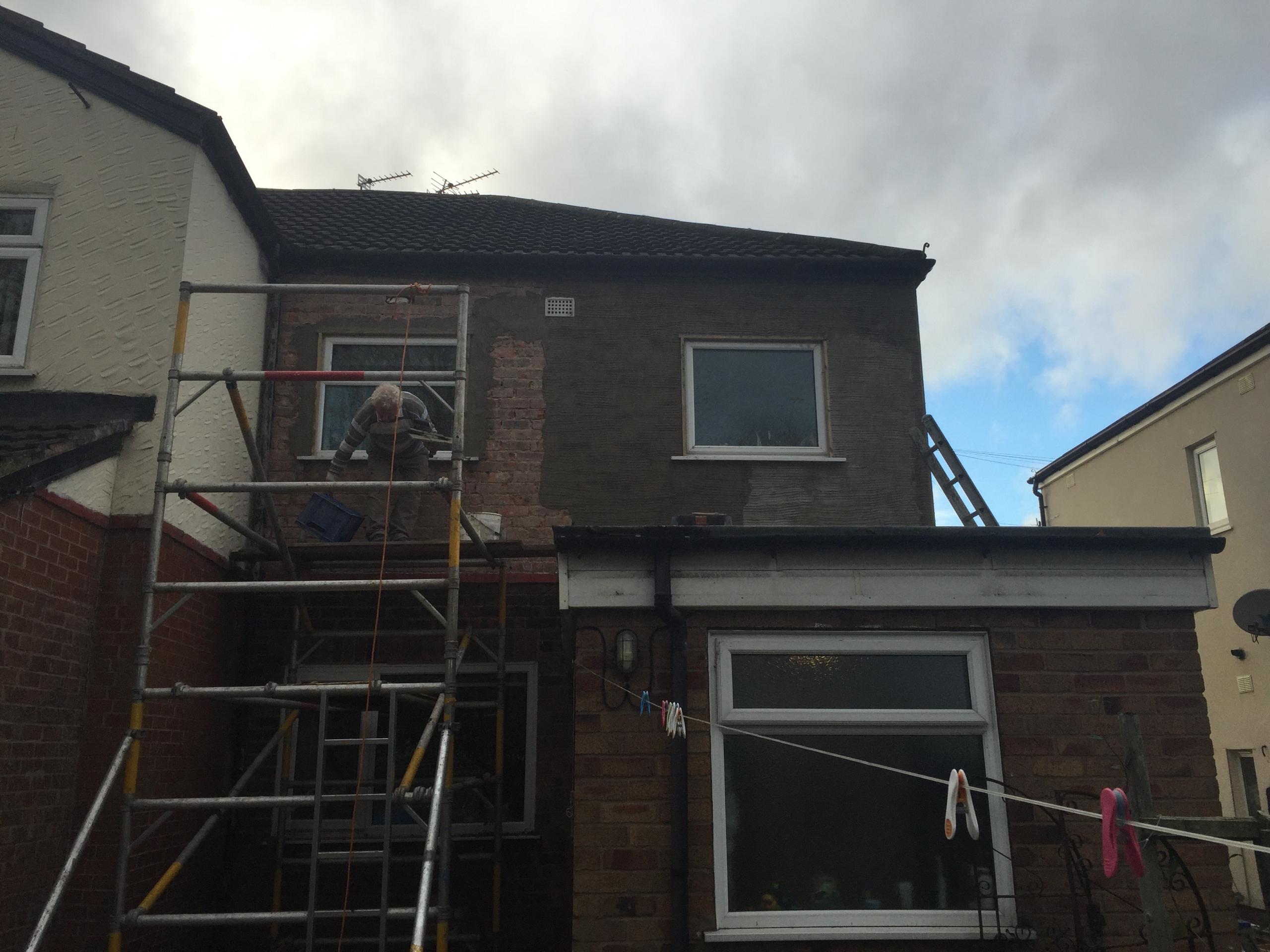

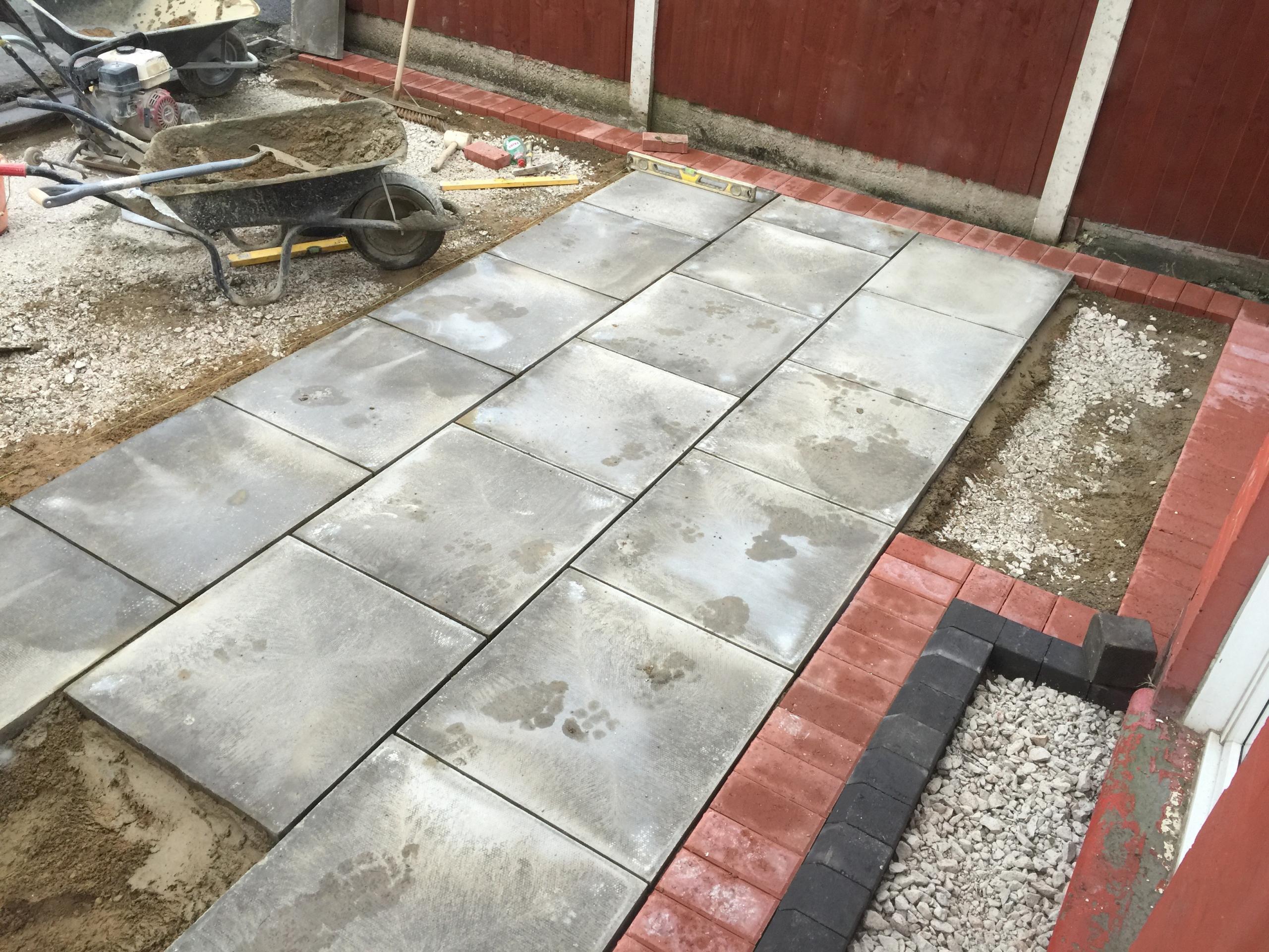

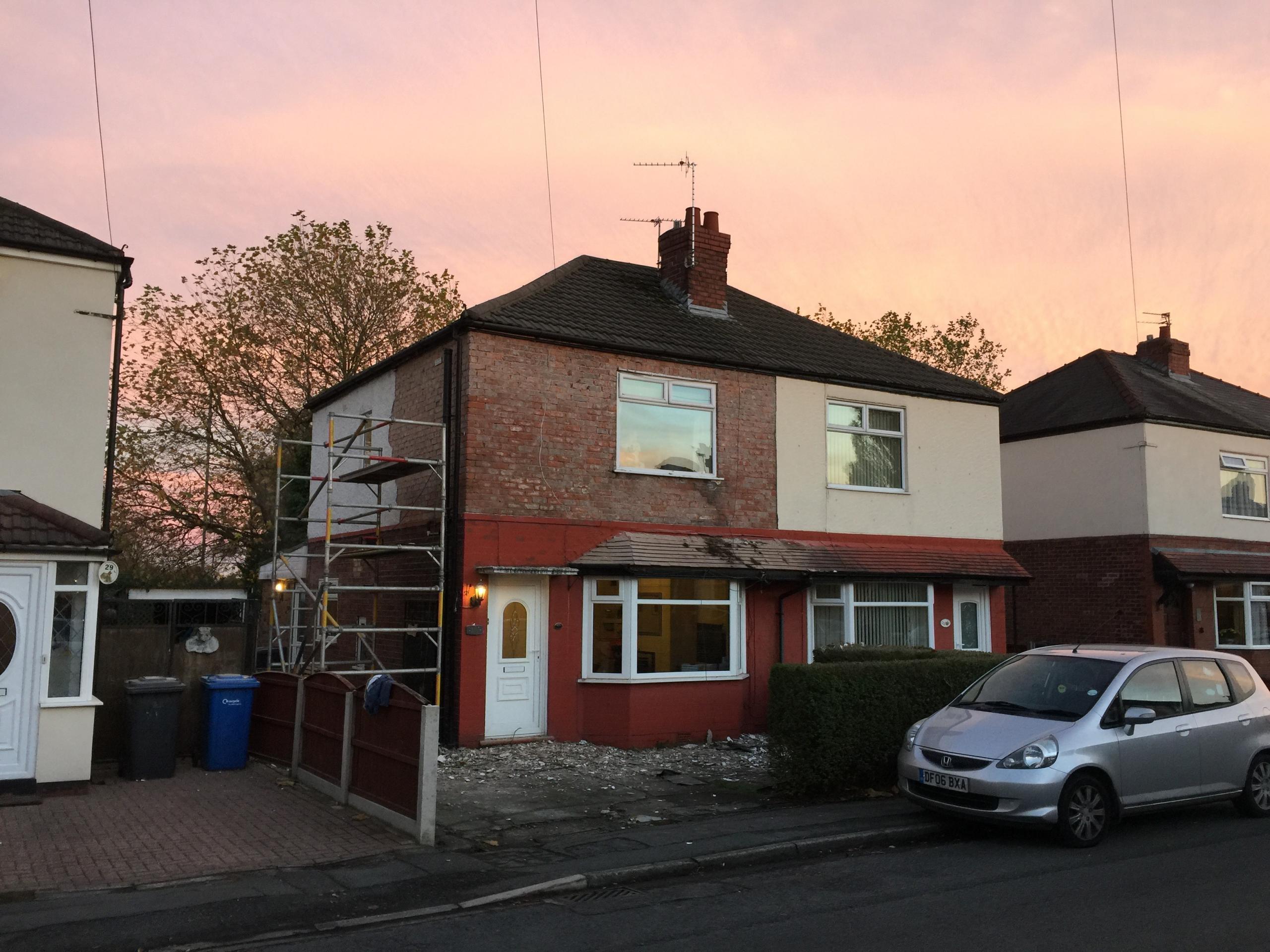

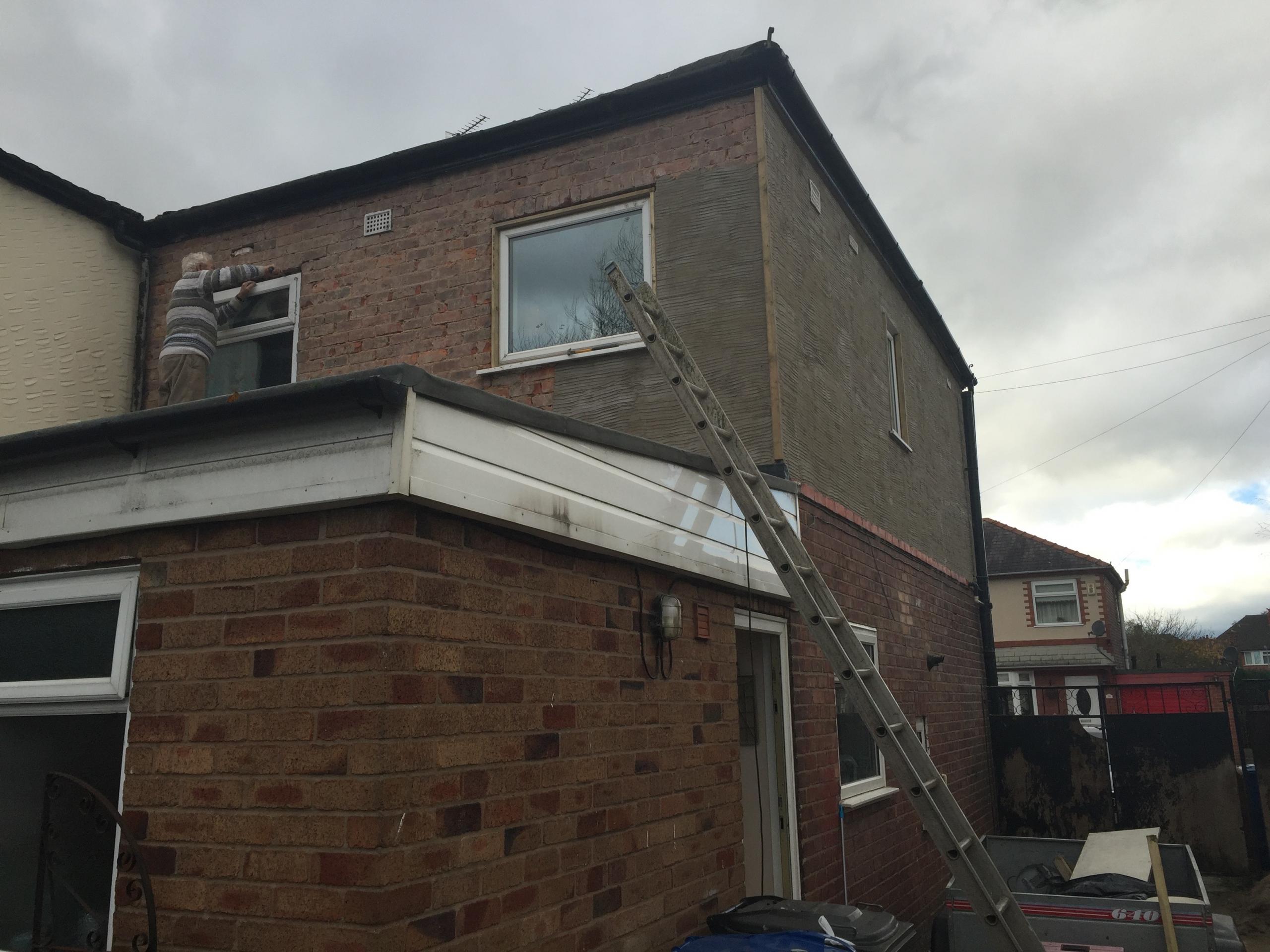

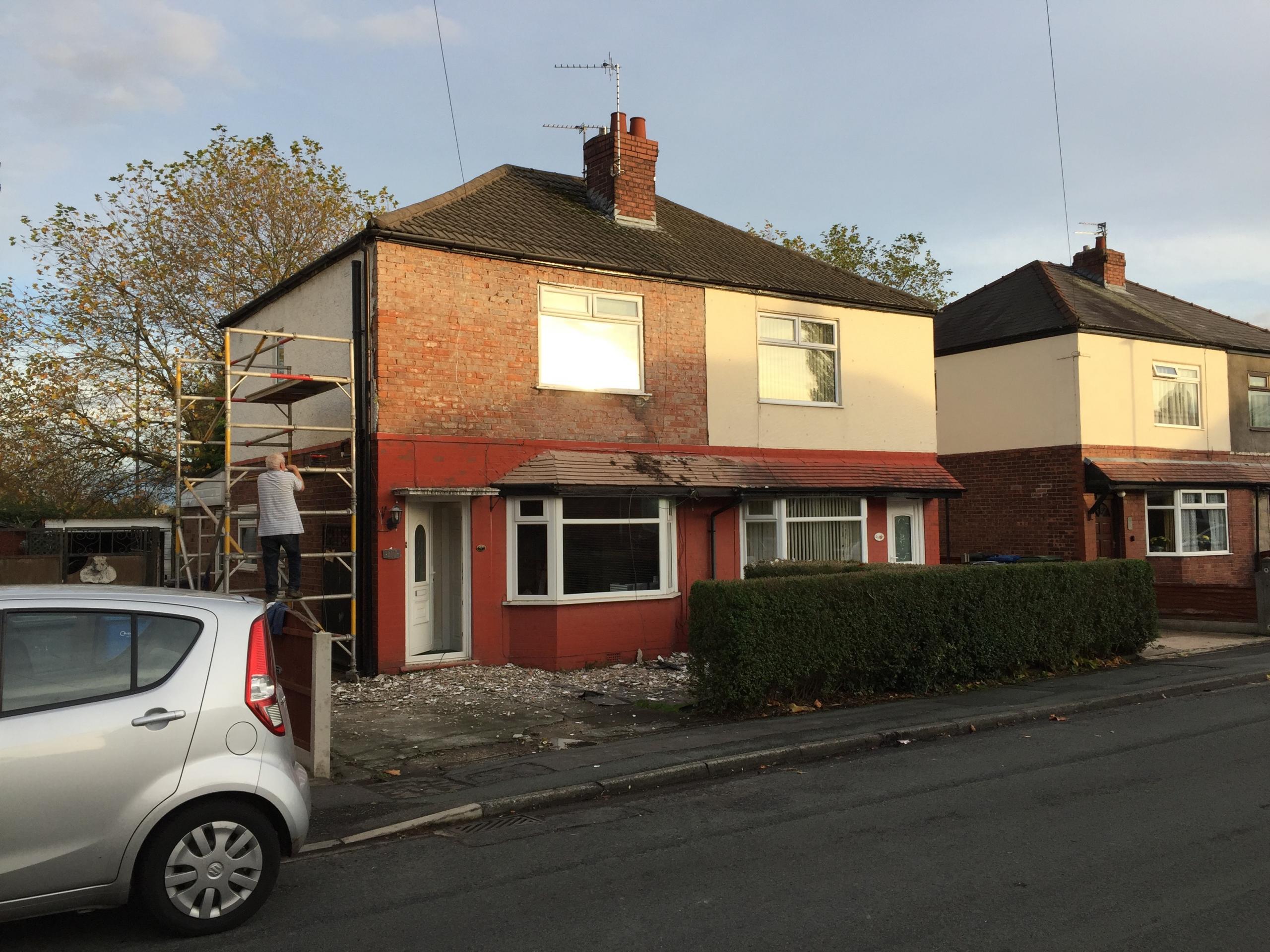

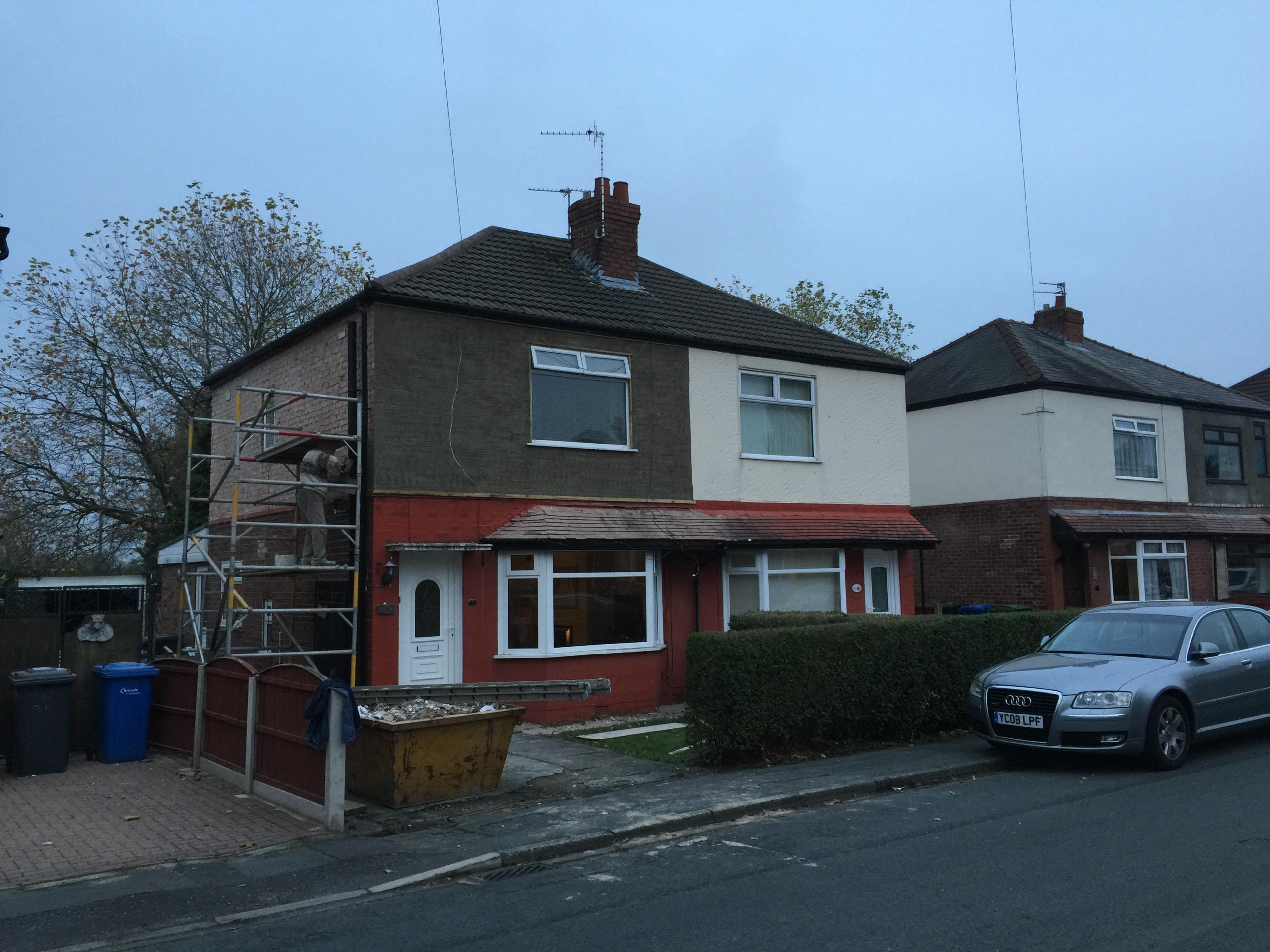

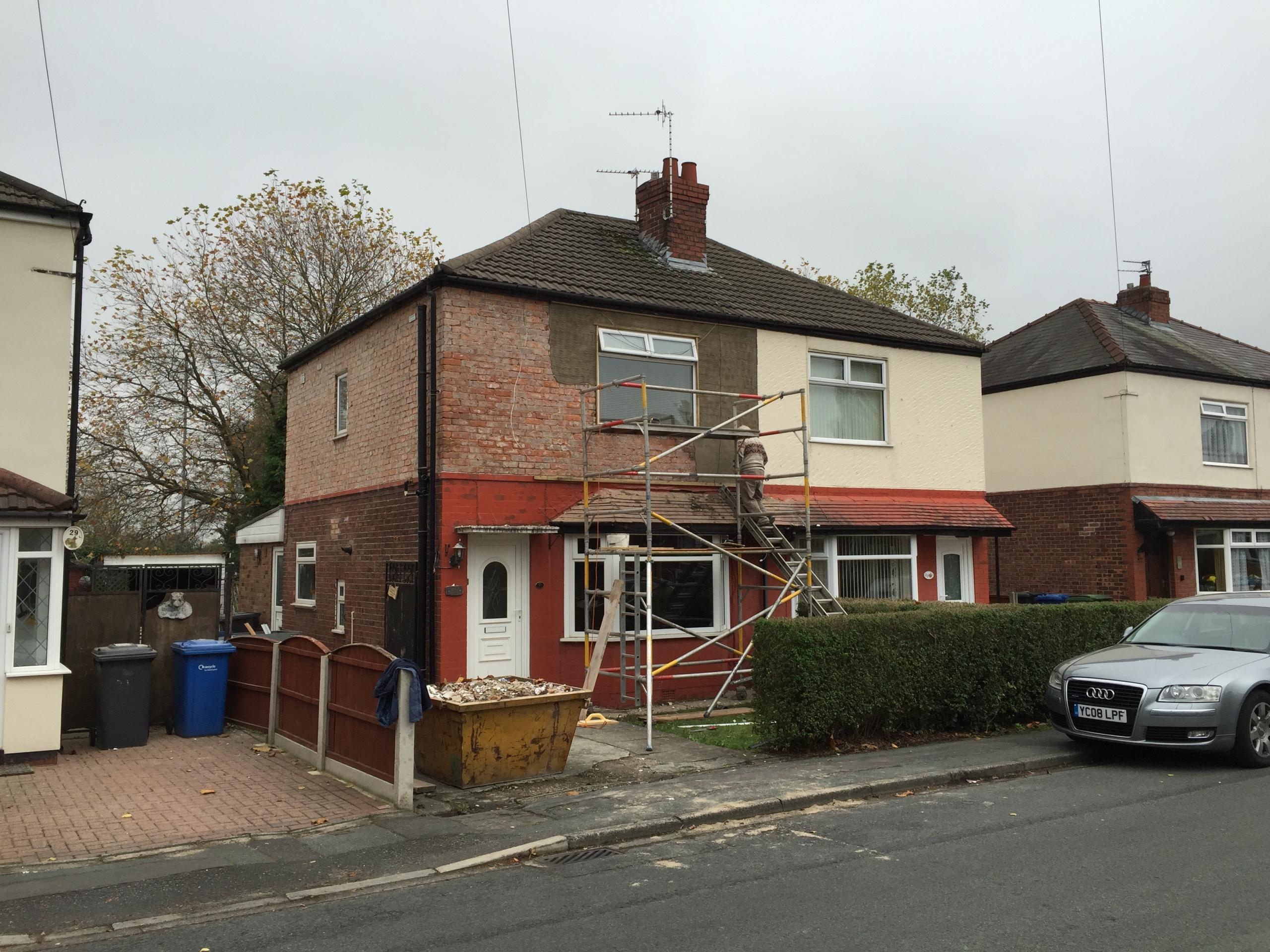

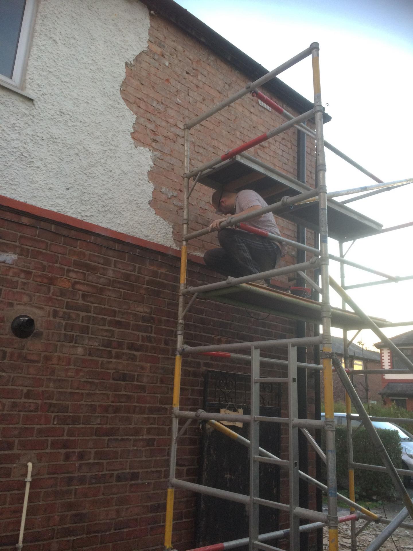

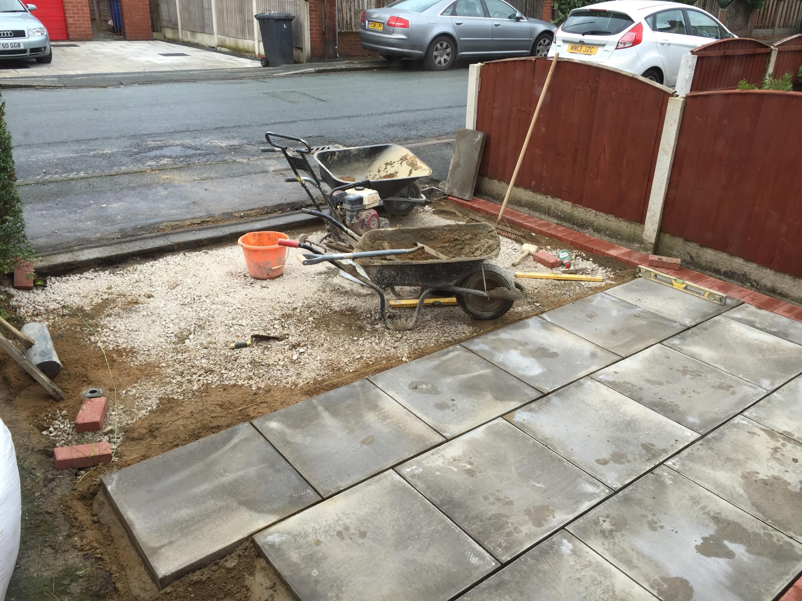

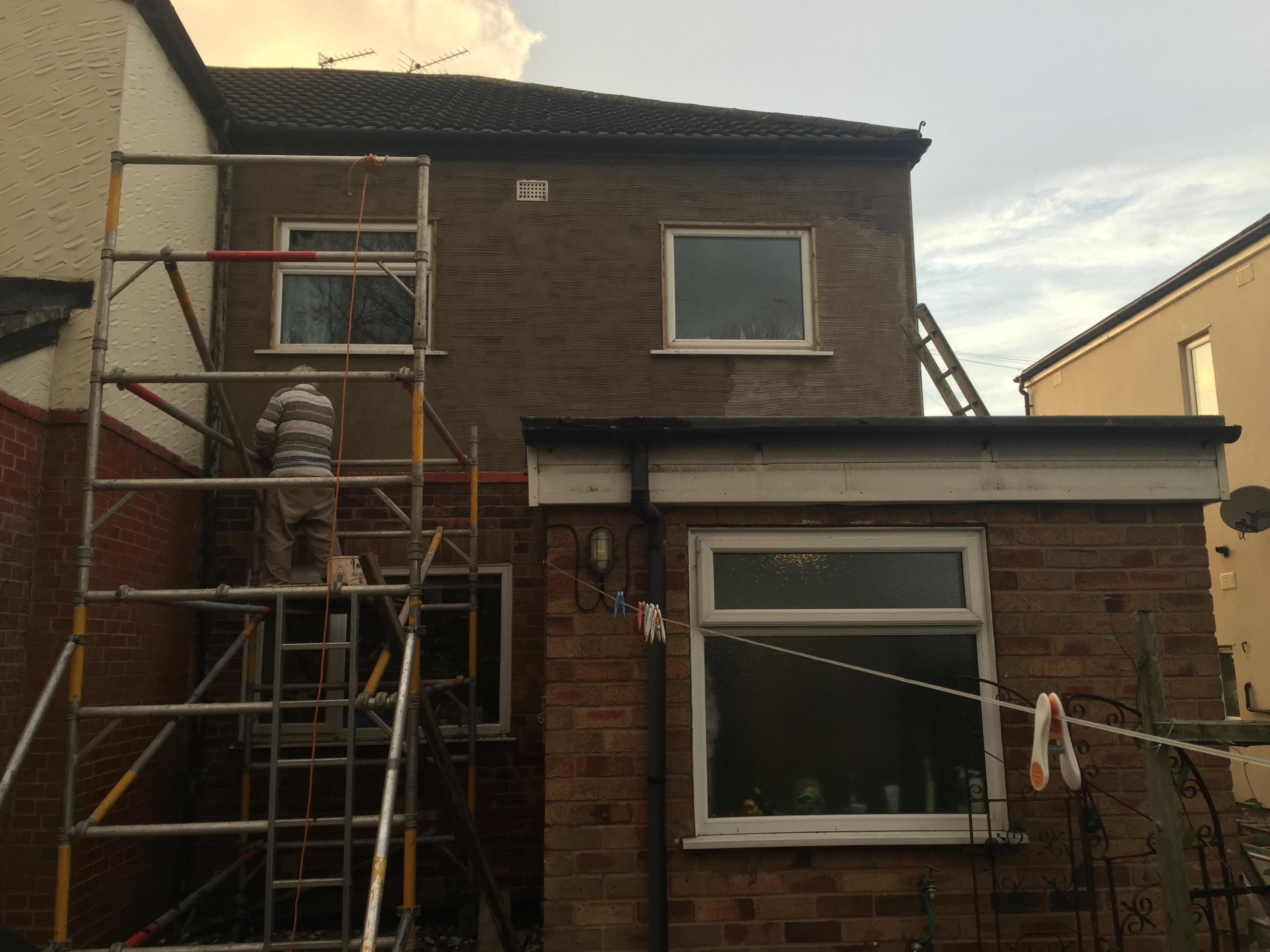

Having watched our little house look shabbier by the year since we bought it, the father in law and I have started to re-render the first floor. Weather has suspended play since we completed the scratch coat. So that will have to wait for now.
We decided to get a fella in to do the drive. He did two of the neighbours' drives last year. Word of mouth is invaluable/ Does a very good and proper job.
Still need to strip the paint off the brick (who paints brick?????). Anyone knows what's best for that, the bricks underneath are engineering brick, so pretty damn tough. Renew the lead flashing and probably the tiles above the bay, as they've ALSO been painted
Anyway, here's some photos.

You can get products, such as Langlow Strip Away, which are caustic and can liquidise the paint. Don't use anything abrasive as you can damage the face, even engineering bricks, leaving them porous where damage has occurred - potential moss growth and damage from frost thaw cycles.

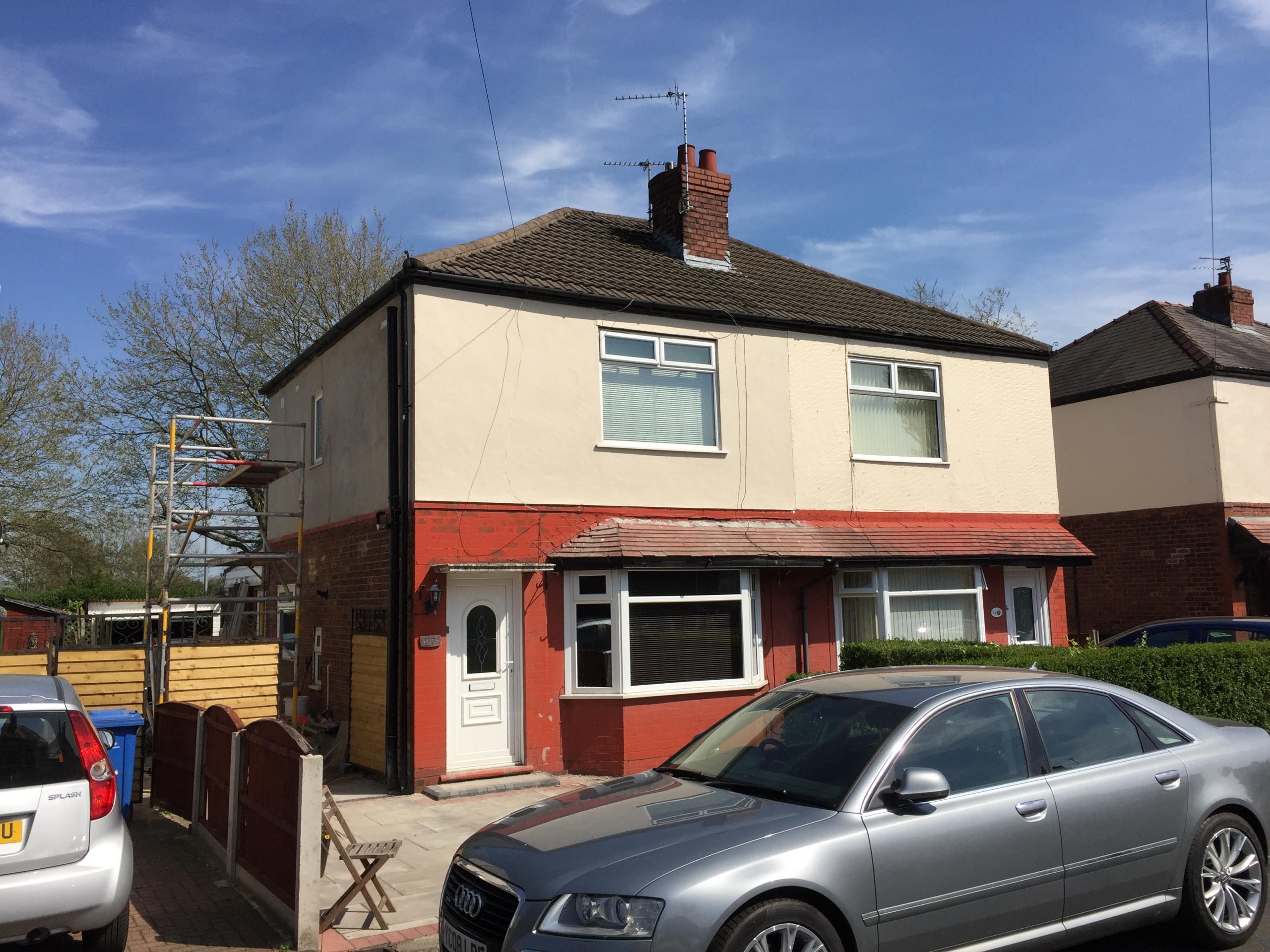

After a long wet winter, writing my dissertation for my MA, and the 75 year old Pa in law recovering from his broken ankle.... We boxed off the render. I sorted the gates out with some new wood and gave the front an undercoat and top coat today. Now I need to strip the painted brick and tidy stuff up, oh and paint the other two walls.

Ooow pretty.

That looks great! It's a real improvement.

Thanks.
It's not the fanciest house. But it's all ours and a bit of TLC is going a long way.
